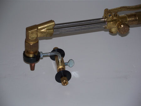

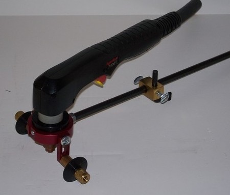

Lincoln has a drag nozzle to add on for drag. It is made out of copper, so it will also wear.
You would think a drag tip would be made of ceramic.
There is also this which will keep the tip off the surface.
http://www.flangewizard.com/products119.html

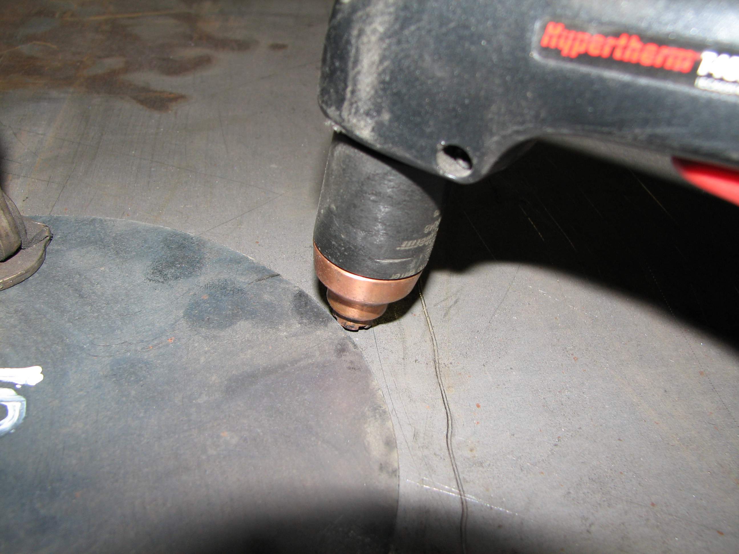

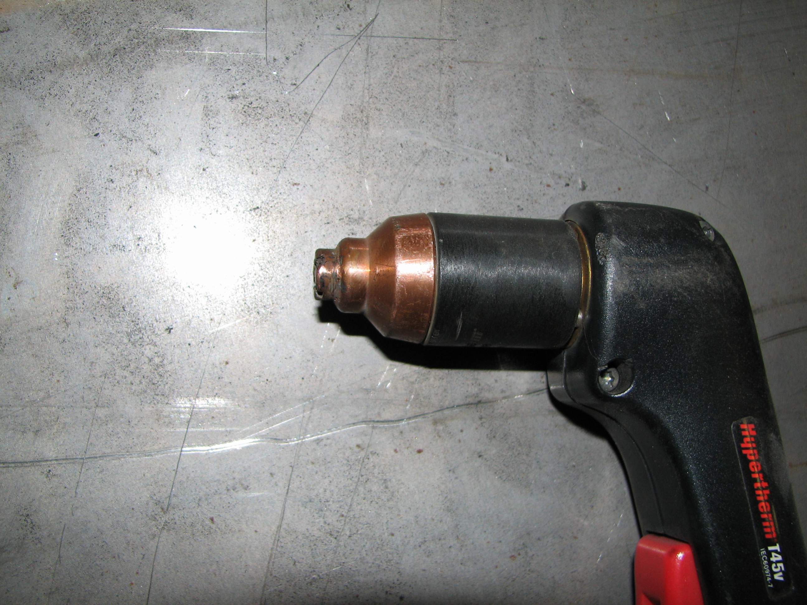

All of the current Hypertherm air plasma systems are designed for dragging directly on the plate...at up to 200 amps (2 inch thickness). Shield technology, invented by Hypertherm to increase torch nozzle life, uses an electrically isolated copper shield in front of the nozzle. This shield provides for a good edge for template or straightedge guidance, and eliminates the double arcing that occurs with any unshielded plasma torch design.
Further, the same shield technology allows machine mounted torches to pierce thicker without blowback spatter affecting nozzle (tip) life. The latest shield designs on the newer powermax45, 65 and 85 systems use the shield to provide an extra squeeze (known from the patent as "conical flow") which provides squarer edges, faster speeds and even longer nozzle life.
Torch technology is perhaps more important in the plasma cutting process than the power supply.
Jim Colt
