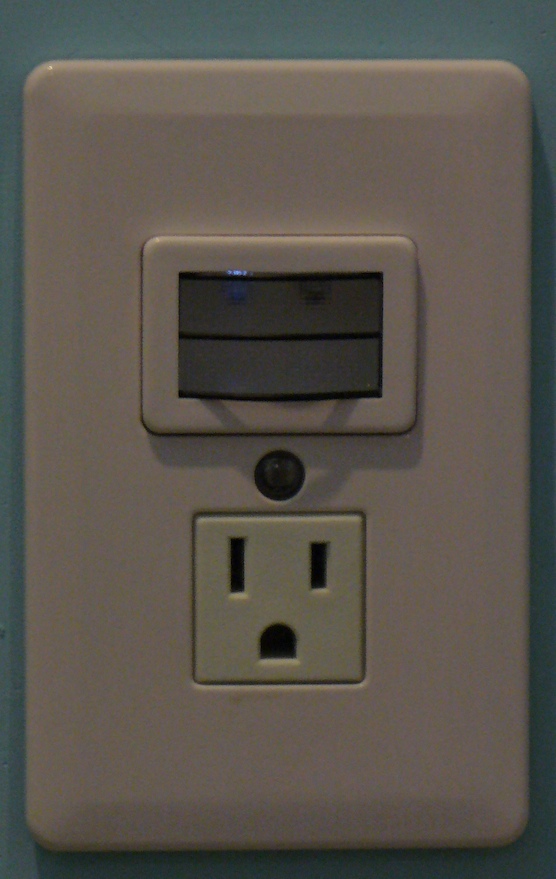

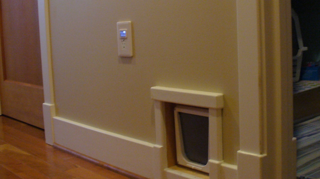

For ceiling boxes, I used metal. I put a 2x6 between the ceiling joists and screw the box into it. I messed up in the garage. I put in plastic boxes because I thought "I'll never put in a ceiling fan here". Well, 3 of them have broken where the screw for the fixture goes into them and it's been a pain retrofitting them with metal boxes. Live and learn.
Also consider outlets in the halls. They are typically not required, but you can put these night lights in them. They are also great for vacuum cleaners. A few of these are in plastic boxes in areas where I know I would never use the outlet (we have central vacuum). Others are in the big metal boxes if they are in an area where they might get used. Here's a close up of the nightlight, and a pix of how it is used in the hall. The cat door is just a bonus, don't get me started...:laughing:
