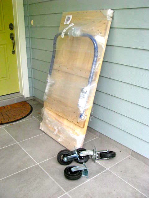

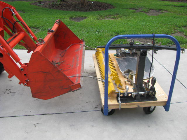

I recently purchased this ideal size Platform Dolly via eBay for $199 plus shipping.
I can access the 110 pound Bucket Spade from one end with the FEL. No lifting.
I can access the 65 pound Ratchet Rake from one side with the FEL. No lifting.
Third attachment is cross-drawbar + cross-drawbar stabilizer (upside down), kept vertical with one C-clamp.
I was pleased that eBay dolly vender included one extra carriage bolt/washer/hex nut.
Well worth it to make attachments mobile while saving my back.

OK, the cart is nice. But what the heck did you do to that drawbar to bend it like that???? :shocked:

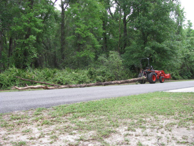

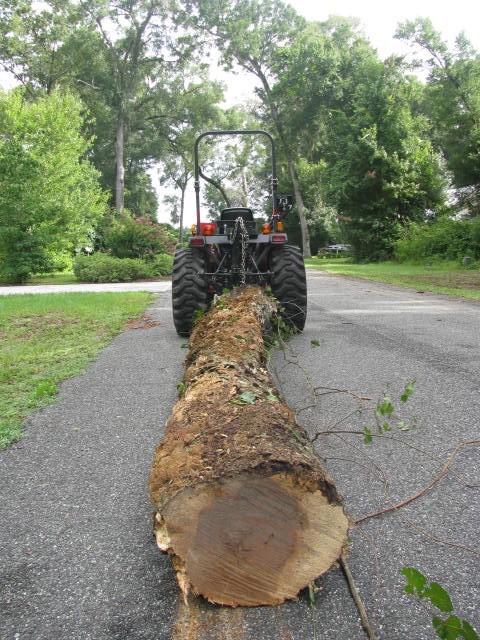

I do a lot of work in the woods. Maybe one of the tows in photos distorted it. Kubotas are willing beasts.
I need to unbolt the cross-drawbar from the A-frame, turn it over, then re-bolt it. I expect it will settle back to "straight" then slowly distort in opposite direction. TSC cross-drawbar is mild steel, it bends slowly rather than failing catastrophically. TSC cross-drawbar was new eighteen months ago, has seen a lot of use.
