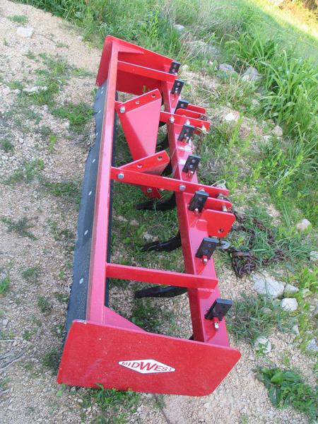

Once you are done with tree removal a large disc is your friend. It will really level out the ground after a few passes. If you have really deep ruts maybe also a rear box blade, as big as you can get that covers your wheel tracks. I run an 8' midwest on my 6500.

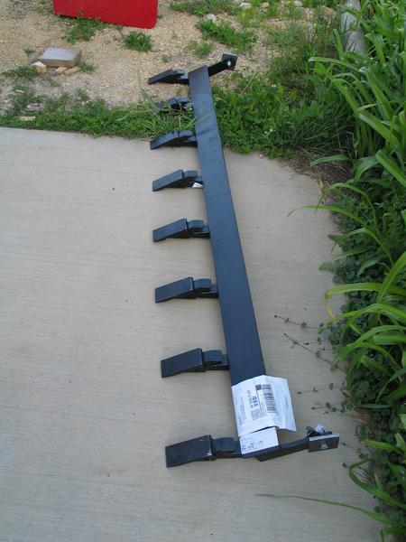

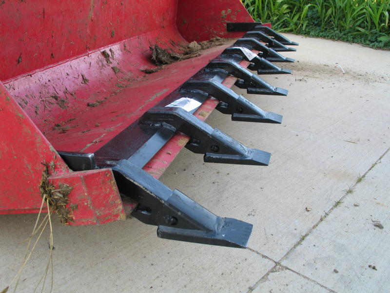

Based on price, I'm leaning towards a toothbar- theoretically, once I take care of the problem, it shouldn't come back if I keep on top of things- so I wouldn't have any use for a root rake grapple later on. Is a tooth bar installation as easy as it looks? A couple of holes drilled on the sides of the bucket, then bolt it in?
Any tips on using the teeth on the trees?

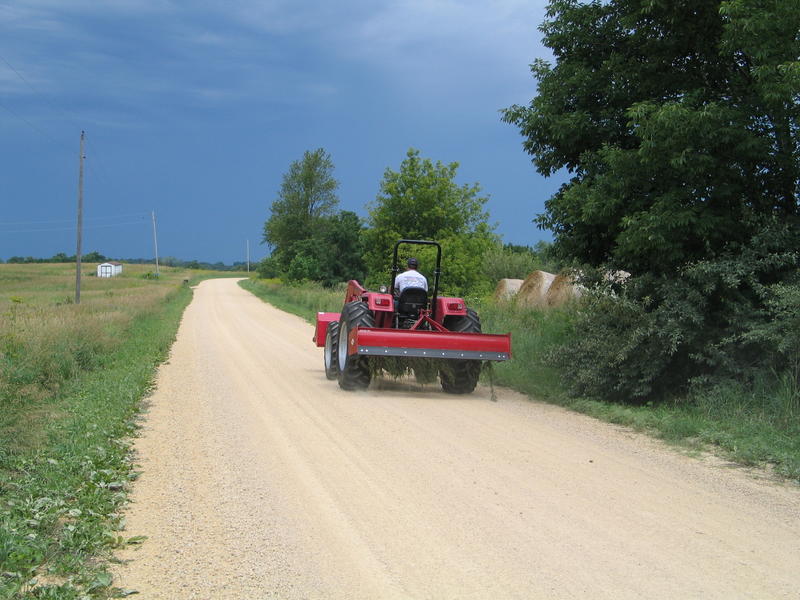

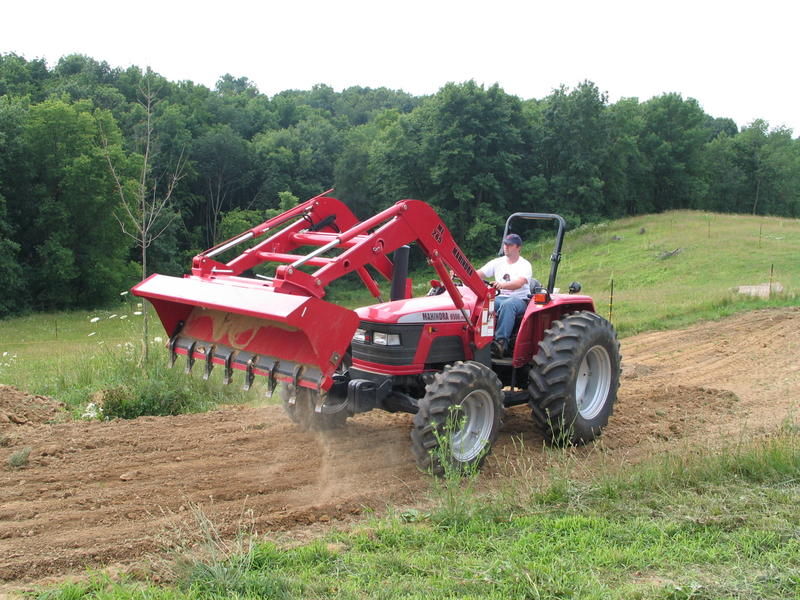

Toothbar is just a few bolts. You need a sledge hammer to get it fit tight the first time as it might have a slight difference in form from your bucket. Thanks for giving me an excuse to dig up these pictures from my installs. I love new toy days!
Toothbar is great! Don't forget the disc though to level.
