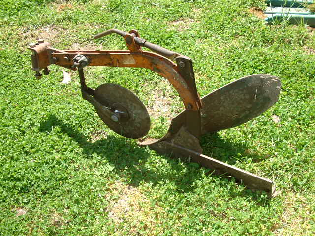

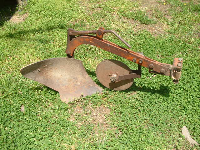

howdy, all!
not being around farm implements much, i wonder if some of you very handy folks would mind telling me what i have here. my uneducated mind tells me it might be a single bottom plow, but i'm not even sure about that. i read about folks who have middle busters, subsoilers, etc, but that doesn't mean much to me. hoping someone can help.
i'm also curious about pulling the thing. right now, the only way i could attach it is to my draw bar hitch or to a draw bar mounted on the 3-point. the way i'm seeing it, neither option would allow me to raise and lower it at the end of each row for turn around.
my understanding is the digging depth is controlled by a combination of the angle of the plow tip (crank handle), the guage wheel disk, and somewhat by speed. then, there is that piece of angle sticking off the back which may have something to do with it or maybe just keeps the thing tracking in the furrow?
is this just a cobbled together piece or is it pretty much as designed from the factory and how do you get the thing to lift at the end of each row without an upper link to the top three point attachment?
thanks for any help on identification and operation! here are the pics....
amp

Allis Chalmers. Someone more familiar with models can tell you which tractor specifically, I'd GUESS it's for a model B. That is a factory built plow. A standard 3-point hitch or fixed drawbar isn't going to work without a fair amount of "re-engineering".
The coulter (gauge wheel disk as you call it) has NOTHING to do with operating depth, nor does speed. The angle of the bottom has SOME bearing on depth, but not so much as the hitch itself. The tractors hitch will determine operating depth. The coulter is to slice through sod or surface crop residue so the plow has a clean path.

Thanks for the quick reply!
If it all has to do with the tractor hitch, does anybody have a pic of a proper type hitch design? I wouldn't even know where to begin.
Does it have to do with height relative to the tractor wheels?
The plow itself has a double bolt hitch which I guess helps keep it straight behind the tow vehicle. It has about a 3-4" bushing which might allow it to ride up and down that distance when mounted.
any thoughts?
amp

I have an old 10" Brinly (manufacturer)plow that looks very much like the picture you've posted. I bought it in the early 70s to use on a Ford 14Hp. garden tractor (I believe the tractor was made by Jacobsen). I think the hitch was called a "sleeve hitch" but I'm not sure. I remember it had a tube for the hitch pin. The tube fit inside the "C" type attachment on the plow. The plow was offset from center by using one of the hole sets in the "C" for the pin. There was also a plate which hung over the tube on the tractor hitch and which was pushed against the mid section of the "C" to keep the plow from swaying side to side. At that time (1970s)Brinly marketed many attachments for lawn and garden tractors.
Try this web page Brinly-Hardy Co. | Gardening Equipment | Plows | PP-51BH
Hope this helps,
Barney

thanks at ton for posting up that link, barneyhunts! i think that is exactly what i have. i read through the pdf manual at that site, and it gives complete adjustment instructions. it looks like a little work to get it all adjusted right, but i think i'll give it a try. my neighbor and i both have some garden spots i can work on, plus i want to plant some trees next spring, so i can start soil prep this year.
i'm thinking i may be able to attach it to the lower draw bar and use the lower link arms and a chain to raise and lower it. otherwise, i can use the 3pt draw bar and see if that will work without the upper link.
n80, check out the link barneyhunts posted and click on the manual so see a complete set of instructions for adjusting a plow. it may help you adjust yours depending on the options you have.
amp

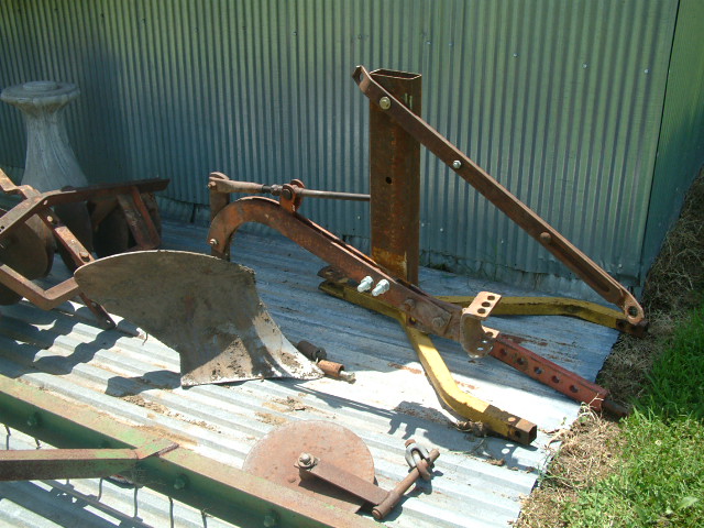

Here is a picture of how I attached this sort of stuff to my tractor. Not pretty but it works..
Rob

ah, so that's a middle buster!
i guess i have a middle buster type plow too, in addition to the one i asked the question about. we also called it a tater digger, water line trencher and railroad tie planter! it was designed to be pulled by a chain and had two handles so the second guy (the actually worker as opposed to the driver) could bear down on it and guide it where he wanted it to go.
i like your 3pt adaptation better! since ours needs some reworking, i may try to make it a 3 pt mount like yours so it's easier for one person to handle.
amp

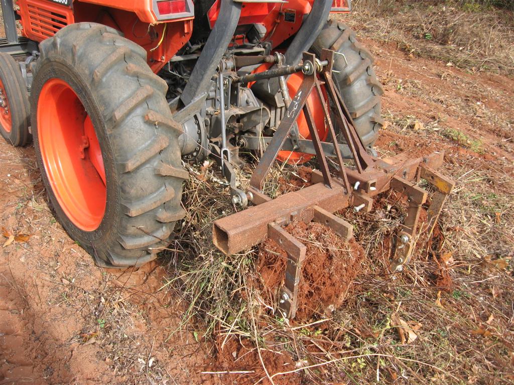

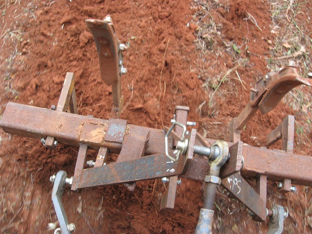

I 've gotten a ton of use out of this funny looking bar. :D
