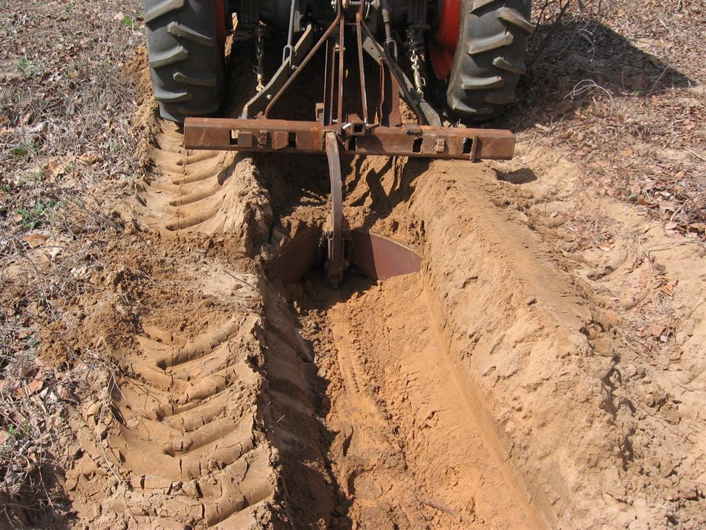

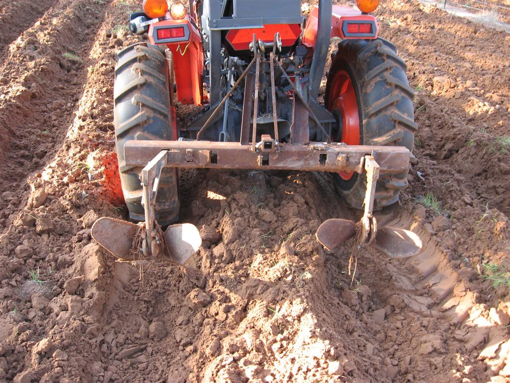

Here is a picture of how I attached this sort of stuff to my tractor. Not pretty but it works..

ah, so that's a middle buster!
i guess i have a middle buster type plow too, in addition to the one i asked the question about. we also called it a tater digger, water line trencher and railroad tie planter! it was designed to be pulled by a chain and had two handles so the second guy (the actually worker as opposed to the driver) could bear down on it and guide it where he wanted it to go.
i like your 3pt adaptation better! since ours needs some reworking, i may try to make it a 3 pt mount like yours so it's easier for one person to handle.

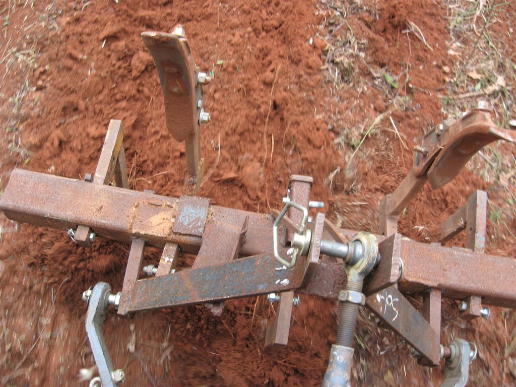

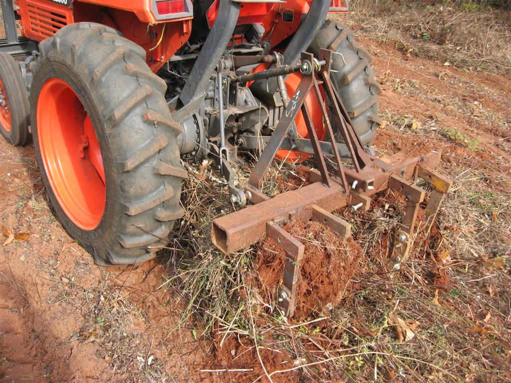

I 've gotten a ton of use out of this funny looking bar. :D

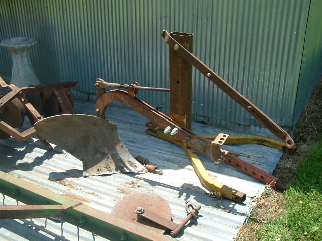

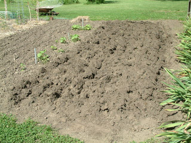

got around to charging the camera batts and taking a few pics today.
first photo is of of the plow in 3-pt conversion mode. it isn't pretty, but functional. i adjusted everything by putting the left side wheels up on 5x5 blocks as suggested to simulate plowing with the right side wheels down in the previous furrow. i then leveled the plow share through manipulation of the top link, the threaded bar on the plow itself and the grading adjustment on the lower link of the tractor's 3pt. i maintained a slight downward angle on the front tip of the plow but otherwise tried to make things pretty level. i was eventually able to get a good compromise between performance in ground and getting the plow high enough when raised to make moving forward and backward pretty functional.

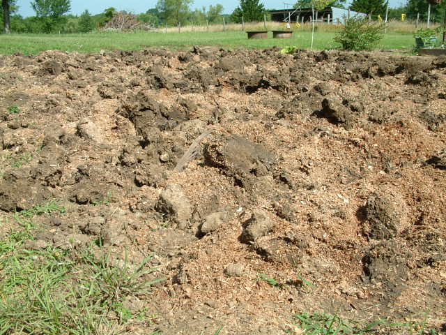

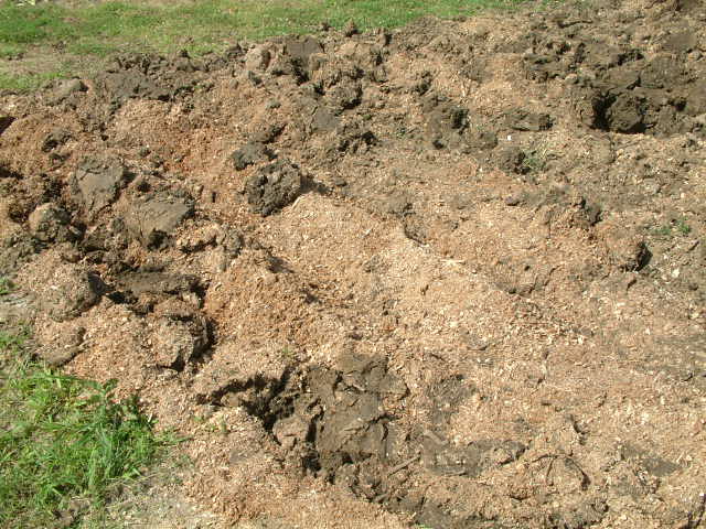

rest of the photos are of it's handiwork on the neighbor's garden and my plot extension i'm preparing for next spring. i was able to get better penetration in my plot. i think the neighbor had a much higher hard pan because of his regular tilling with a small tiller.
the next time i hook it up, i'm going to try adding a little weight to the plow itself to see if it will dig a little better through our hard clay. i think that might help and might be why others seem to get better performance with a two bottom plow with one share removed. the extra weight helps compensate somewhat for the different hitch geometry of the newer compact tractors.
the bx pulled it pretty well and i got good "suck" and overall am pretty happy with it.
next project is a dedicated sub-soiler to break up underneath and get better drainage.
thanks to all for the help and feedback on this! great site and great folks!
