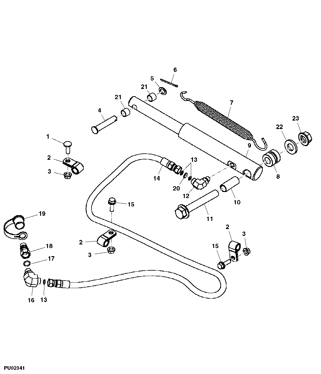

so the john deere dealer sends out a mechanic to my house to put the independent hydro kit on and he didn't have any instructions to do it...so he tries anyway and ends up messing up the hose that came with the kit(cracked the fitting)...now he has to order the hose and pick the tractor up when it gets in.......do any of you guys have a pic of the cylinder installed on the 2320 so I can show him how it goes on.......ps...this kid is about 18-20 years old.....he makes me nervous.....

guys...any pic of the installed cylinder would be much appreciated....there coming to pick the tractor up in the morning and it would be nice to have a pic to look at just to make sure this kid does it right....:thumbsup:....I don't like having to use this kid but the dealer is giving me the kit free so hopefully it will come home right...:)
/ please ...please help..john deere guy is clueless... #7
I don't have pics but I did have a 2320 with the cylinder that I installed myself. It wasn't a hard job but it did take patience. There's an air vent on the cylinder housing that should be on top when the cylinder is in right. It has to be bled also. After the cylinder is installed make sure that you don't crimp the hoses when you raise the deck, they follow the chasis and are held on with small clamps.
Here's the lift, not much to the instructions as I remember, it's basic common sense.

Here is the instructions. sorry for the multiple languages, I can't edit the file.

well the "kid" brought the tractor back to me today and when he left I pulled it into the garage and slid under it to have a look...sure enough I found all 3 clamps that hold the hose to the frame loose ..the nut on all 3 was just barely started like he forgot about them...also found that the cylinder was rubbing on the bracket the pin goes through...he forgot to install the supplied washer to space it out....after I fixed all this everything seems to work like it should....now the real question is will I like having to swap hoses when I mow ....I'll know this week ...at least he gave me the mechanical lift arm and all the hardware that connects to the rear rockshaft so if I don't like this hydraulic lift I can take it off and change it back to the mechanical lift..... I cant complain if I don't like the lift...the dealer gave it to me for free and its easy to take off and change back....:)
