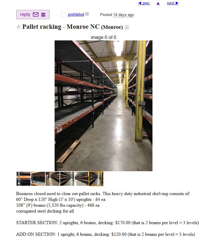

I very frequently see industrial pallet racking for sale on local clist. Lots of flexibility there with overall height, rack spacing. Way less $, super strong, and ready to bolt together and use. A lot better and cheaper than anything I'd make on my own :)
This is an example: Pallet racking - Monroe NC - business/commercial - by owner - sale <$300 for six 9' locations 5' deep.
/ Please post your pallet rack solutions... #4
That's a pretty good deal. Where are you located CMV?
