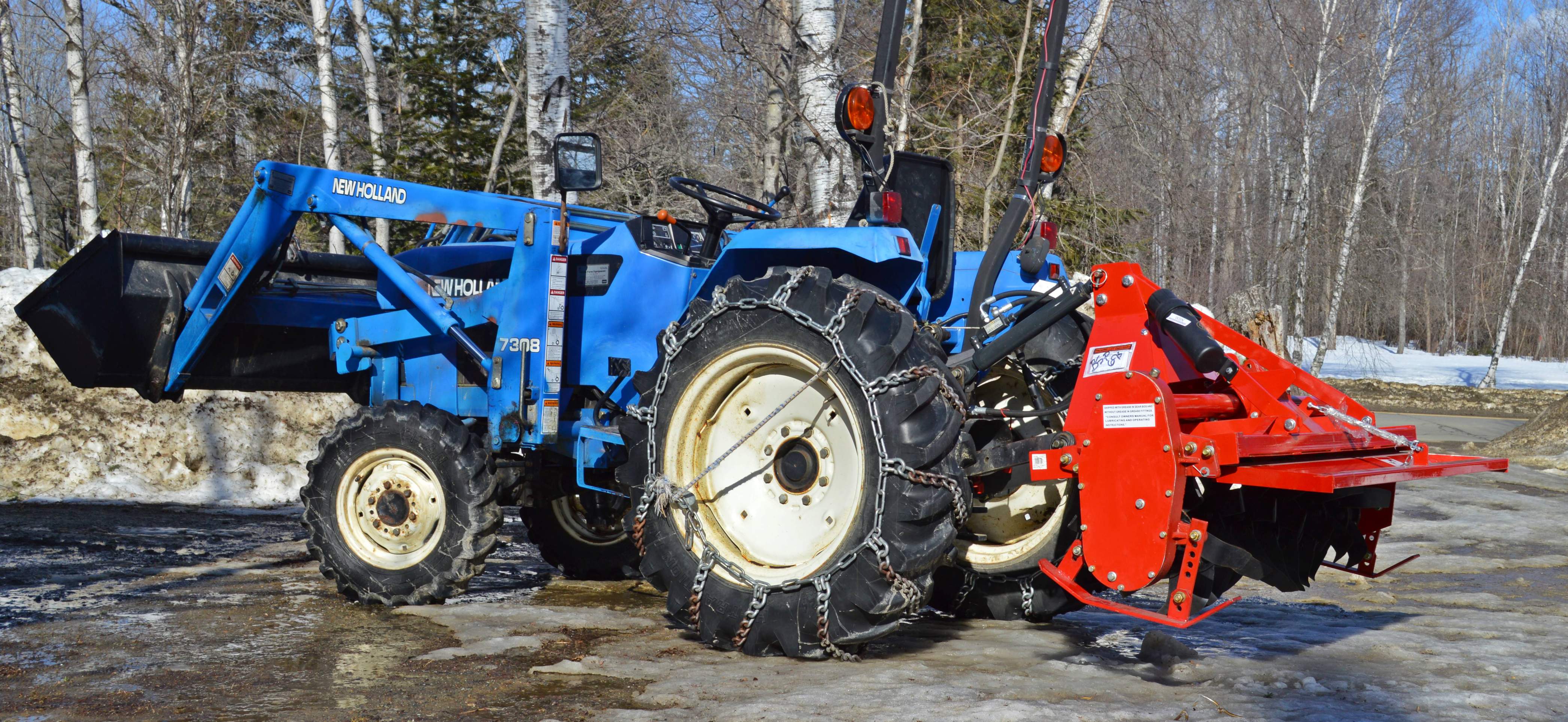

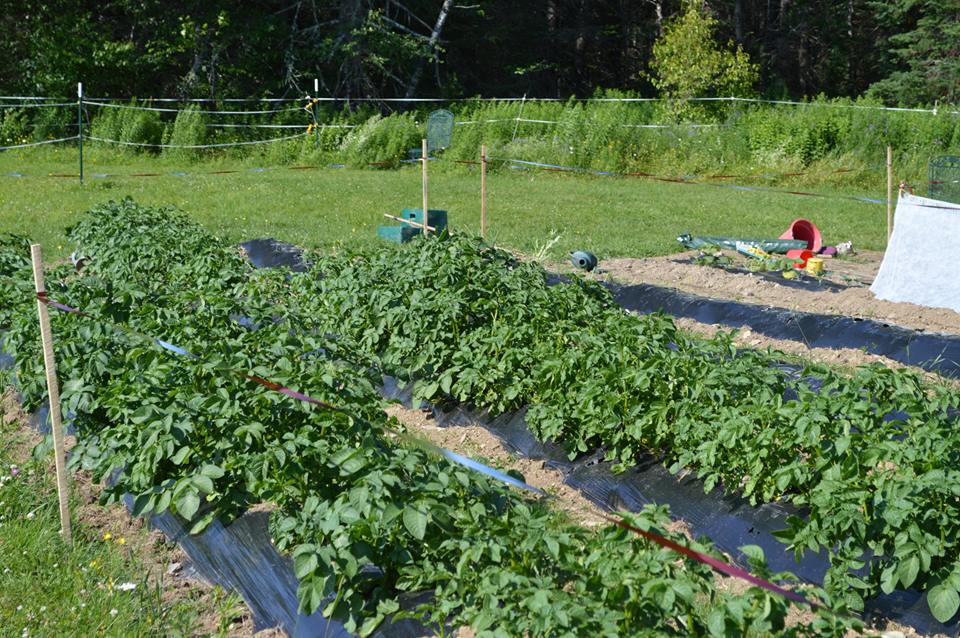

I used my 5' tiller to turn some pasture into a garden last year. 150'x100' or so. The horse pasture used to be a hay field 40 years ago. It was rocky. The tiller handled it well but I made about 5 passes over it to get it good. It is not a quick job, but very doable.

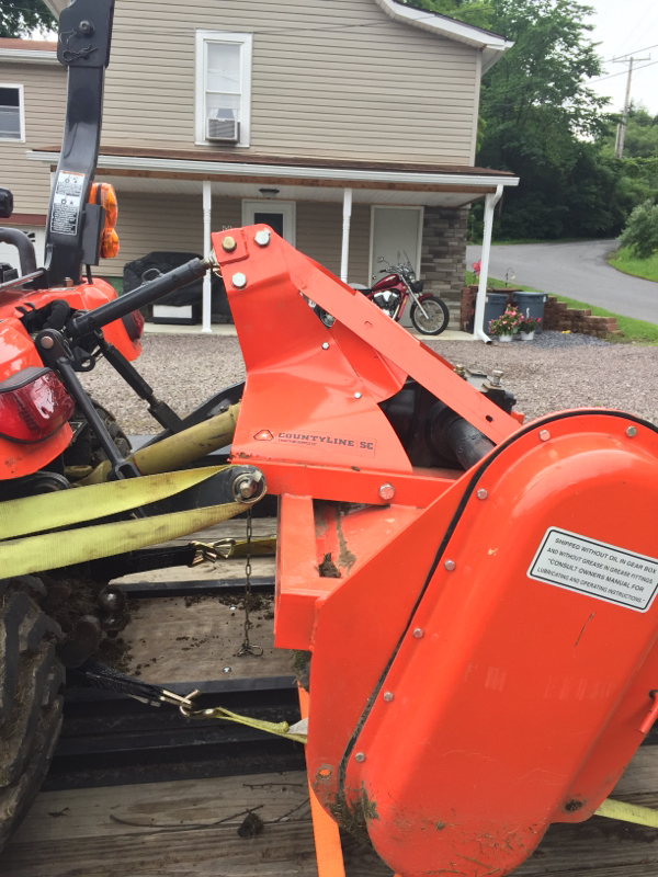

I have a 30hp TC30 and the tiller is one I bought from agrisupply a year ago in March.
Tillovator-Rotary Tiller | Agri Supply #7771
