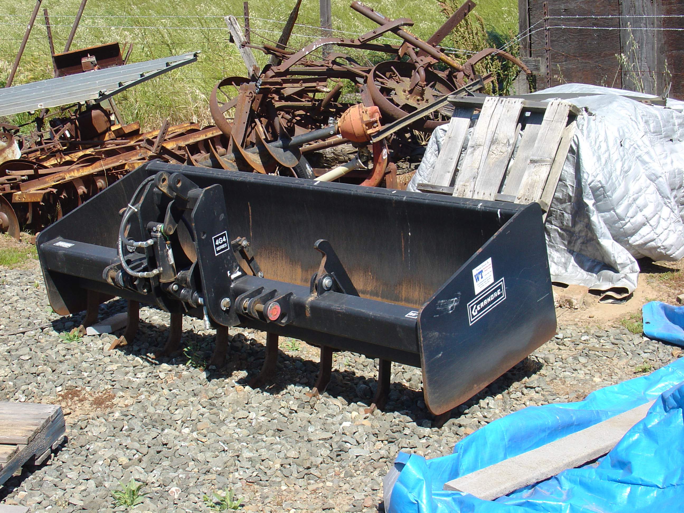

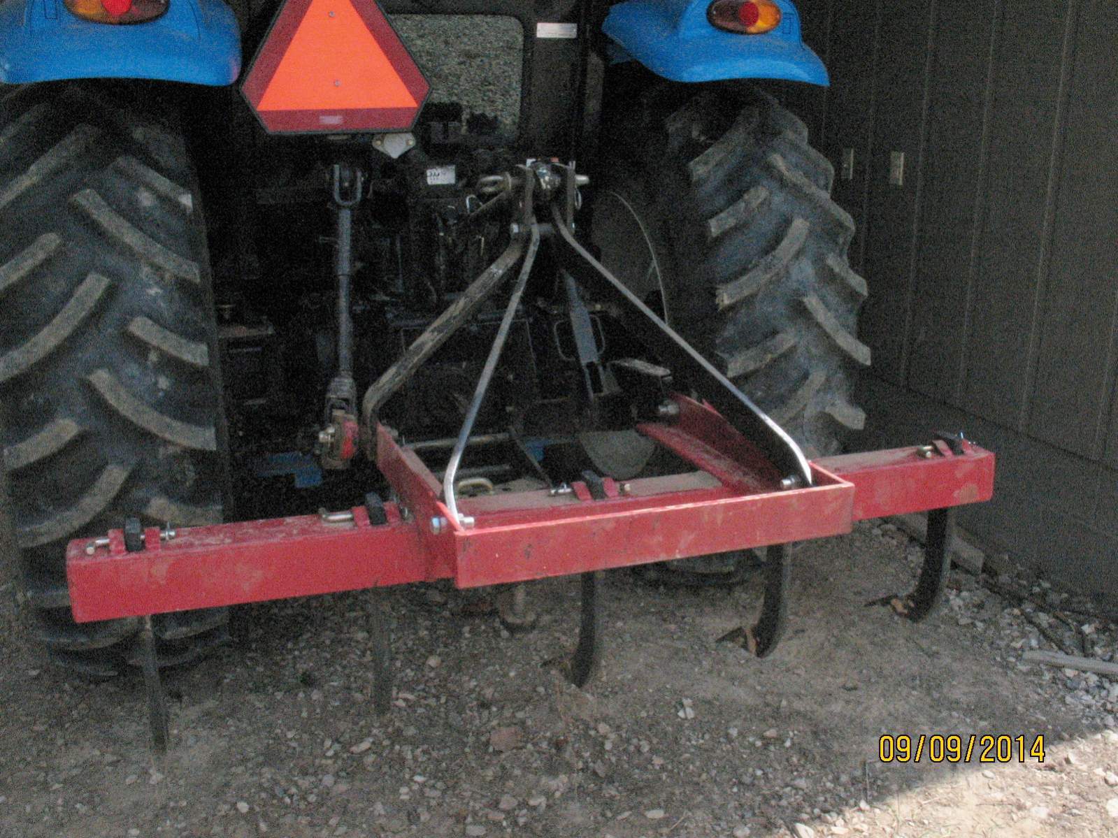

IMG_1643.jpgThis is the way to loosen up soil for a tiller if you need to. Much faster that a plow. It is same as a box blade without the box.
   / Plow first or go right to tiller? #27
View attachment 462601This is the way to loosen up soil for a tiller if you need to. Much faster that a plow. It is same as a box blade without the box.
I agree that such an implement (or a box blade with scarifiers) does an excellent job of breaking up soil.
BUT...It has to be bare soil or very shortly mowed foliage that does not have a lot of surface clutter. These tend to load up with debris, lift the 3PH, and slide over the surface. And I have a very heavy box scraper that does this.
A middle buster is slower because of the limited soil contact, but the OP has gotten his to perform as desired.
Not trying to be contrary, just pointing out limitation I've found in my experience.

Gwdixon where did you get that ripper? Or what is it called? It does look like a box blade without the box but I've never seen one before.
   / Plow first or go right to tiller? #30
All of the box blades I have seen you can't remove the box & leave the rippers like that
