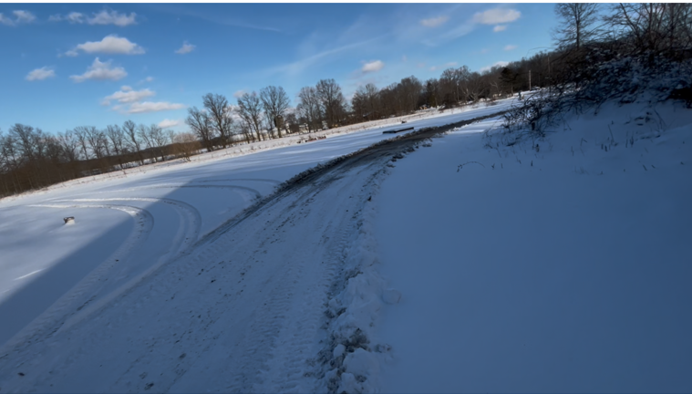

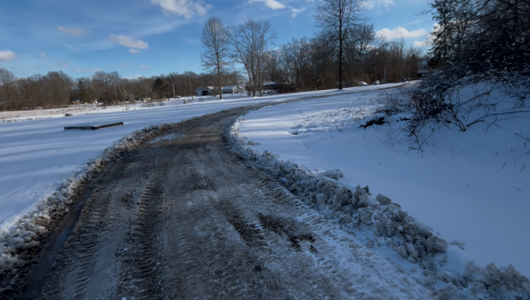

Another snow removal attempt a couple of days ago. Tractor in 4WD with engine at ~2000 rpm, transmission in low and loader in float mode. No strain on the blade or tractor.

I can't really tell from the pictures, but does the plow have a trip? That's more important than how it floats (although I would rather have the plow blade float than the loader arms). If it doesn't trip, it will plow fine until you accidentally hit something and then the loader arms will be bent.
View attachment 2777957View attachment 2777956
Im not sure where you live, but it appears you dont stay below freezing all winter long. Floating the tractor arms when the ground isn't frozen will result in rolling up dirt. With your ground soft and only an inch or two of snow, you might better off backblading the driveway. The plow wont Dig.
