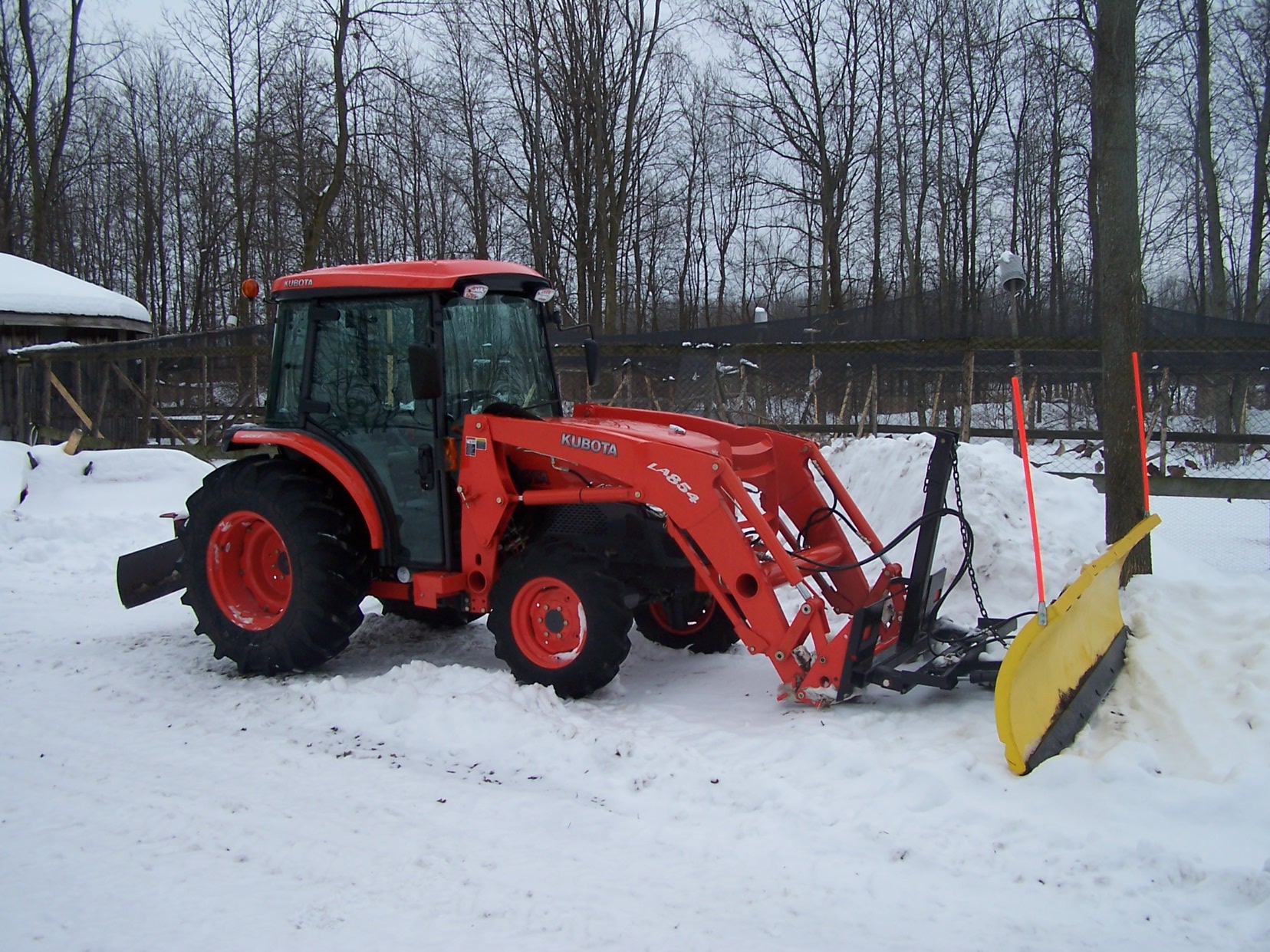

I have a very similar set-up.L4240 HSTC with a FEL mounted 8ft.Curtis plow.I built mine with the "float" on the plow.(Chain).I think the FEL float set-up was designed for paved roads and very frozen drives.I plow about two miles total and have very little problems.Early in the year before freeze up it's a little messy.I have a seven ft.rear blade also.

Has anyone tried reversing the hydraulic lines so that the float works on the bucket cylinders instead of the loader arms? I am going to try it this winter to see if it lets the blade float and hold the loader frame rigid using the other hydraulic circuits.
I have. The first time I did it I had to use regen to lower the loader. Then I switched them in a X pattern and it worked. I asked if it was okay to use it like this in the hydraulic forum and I did not get a real good answer. I decided against it for now. I was afraid somebody may get in the tractor and not know the hoses had been switched around. I think I can do a simple modification to the blade to make it float. Here is the thread I started in the hydraulics forum. http://www.tractorbynet.com/forums/hydraulics/288785-float-curl-function.html
