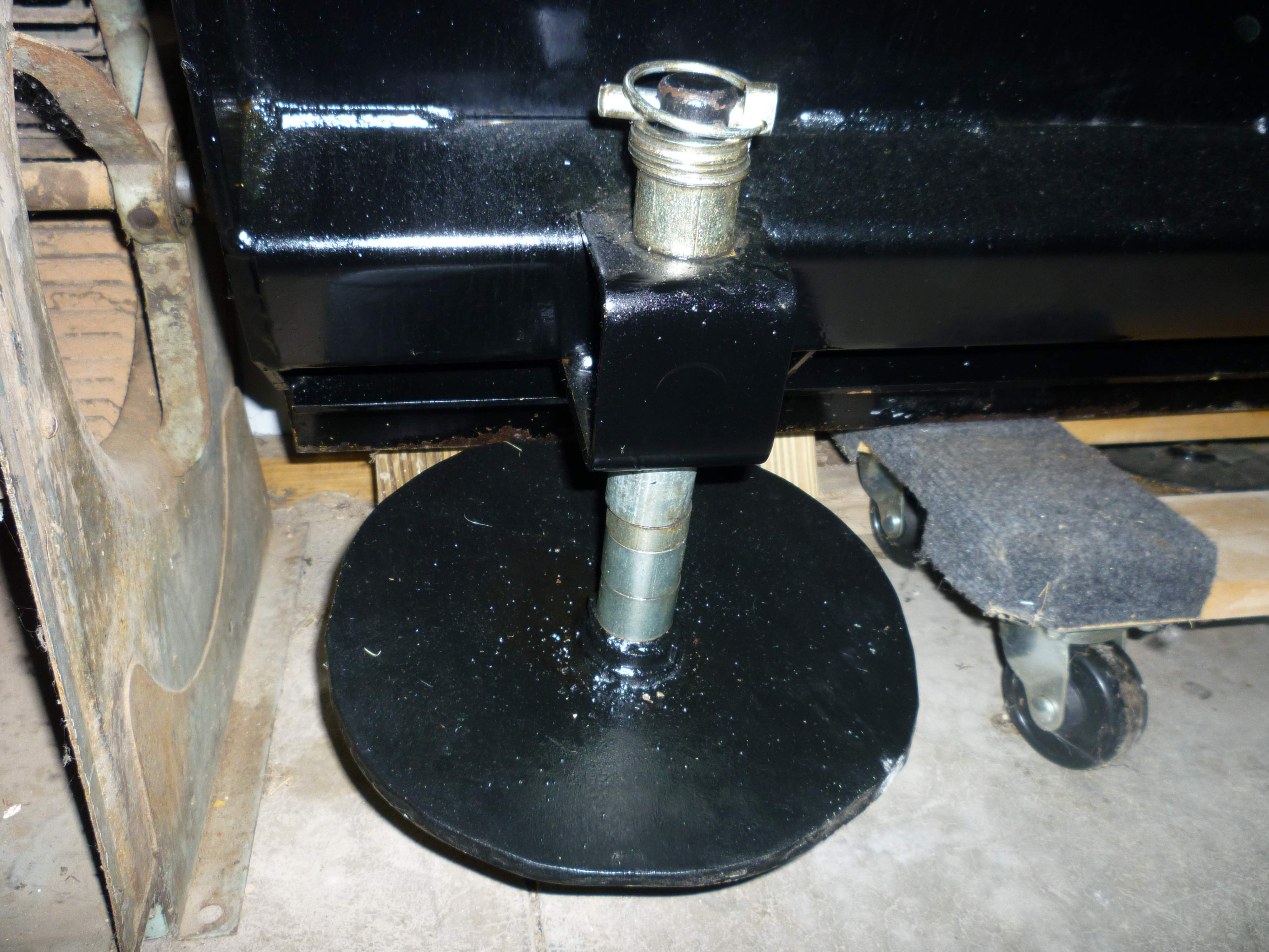

I have a 3" pipe and it still moves some stone. You won't have a problem with it building up. If you do somehow, just take it off and let the skid shoes run on the pack ice. I also tried the larger shoe idea. It worked, but the pipe gets the drive cleaner. To make the larger shoes, I just took a new 14" disc share and welded it to the bottom of the domed skids that came with my plow. They floated on the soft gravel and over the grass with no issue, but I preferred the pipe.

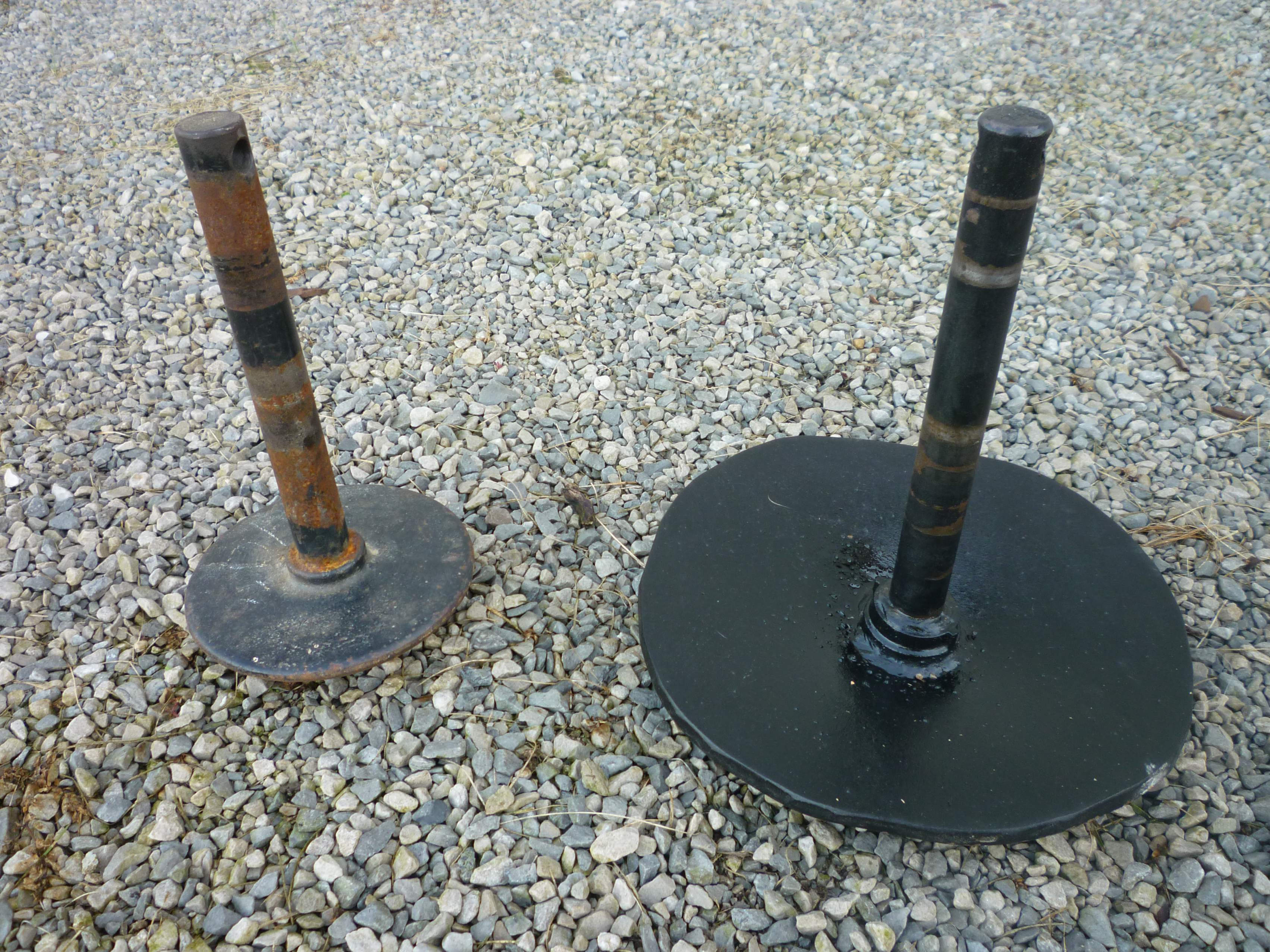

I've posted these pictures before, but I added them again in case someone wants to see the difference. The large custom mushroom skids make a huge difference compared to the original standard size.

On my blower I increased the skid soles to about 10" long and 2" wide and adjust to leave about 1" of snow in order to create that desirable base.
Once my base is established I remove my skids.
For my front mounted plow I drag it backwards to compact the snow and create my base.
