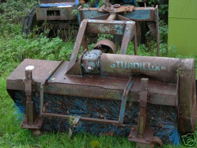

Here in the UK everything seems to grind to a halt whenever we get a couple of flakes of snow - that's how much we get /forums/images/graemlins/blush.gif
Anyway, the area I live in is limited to a few inches of snow at most so there really is no reason for us to have any form of snow removal equipment.
As it happens though I bought the attached road brush on eBay at the weekend. It's about 5' wide and powered by the PTO. The brush is a nylon/wire mix and by my reckoning could do a really good job of clearing a couple of inches of snow from our tarmac driveway and parking areas.
As you can see it need a fairly major amount of tidying (next spring I think), but it works fine.
