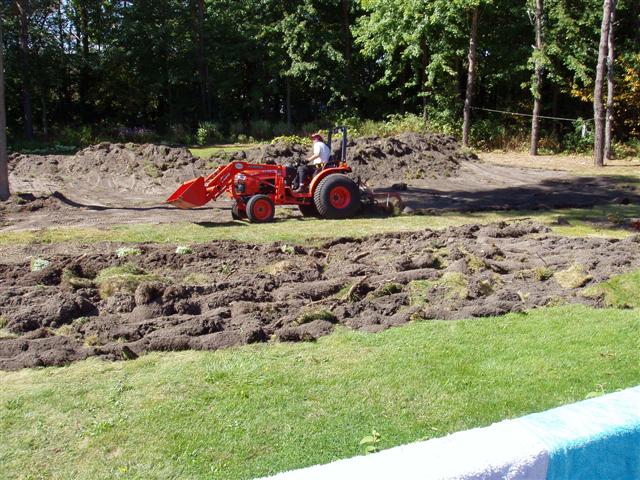

john_bud said:
Put the 275# in the FEL bucket. Fill the rear tires with fluid add wheel weights.
jb
I agree. If you have room to manuver, the added weight of the FEL and a loaded bucket would provide much more weight and have the added benefit of having the FEL if you need it.

Barneyhunts said:
John,
When I load the bucket it wants to lift the rear of the machine, even with the loaded tires. This is why I thought removing the loader might be better for traction.
When the plow is set up correctly, it will pull the back of the tractor down. It can pull it down so hard that the front of the tractor will start to teeter totter up. That's why there are front weight bars on tractors - to counteract that tendency.

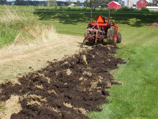

Soil condition and proper adjustment of the plow seem to be the key factors for me.
My 42 Ford 2N plows very nicely with a Howse single 14".
We have Silty basalt clay loam..(RED)
Even in a given field the soil varies enough that the tractor will work very hard in one zone and purr along in another.
I don't recall my front wheels ever getting light while plowing. :confused:
I have hit hardpan spots and had the tires claw for traction a bit.
But set the plow up just the tiniest bit out of whack and you are in for a fight.
Moisture is a biggy! :cool:
