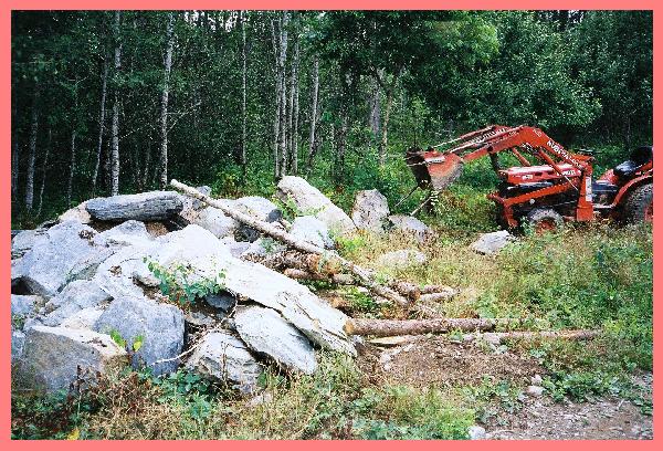

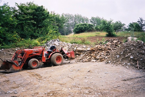

The roto tiller should have a slip clutch properly adjusted or use shear pins.
On my 42 in. Buhler tiller the large rocks are not a problem as the tiller bounces off them. The small rocks create problems if they are carried over and jam between a tine and the tiller shell.
Attached some pictures of areas I have tilled and some of the rocks removed.:D
