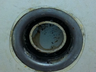

I noticed a small stain on the family room ceiling. The upstairs bathroom is located above and the stain is directly aligned with the shower drain in one axis and about 5 feet from it in the other axis. Directly above the stain is a closet that is dry. The stain enlarged slightly after the shower was used. My theory is that the shower drain may be leaking where the pipe attaches to the shower pan and then running down the outside of the pipe to a drip point 5 feet away. The pan is fiberglass and the pipe is PVC. The house is 24 years old and this just started.
The pipe attaches to the pan with a metal flange and a rubber gasket between the flange and pipe visable from above (see picture). There doesn't appear to be any way to remove the flange or gasket from above. There is no accommodation for a spanner wrench or anything.
Any one have any ideas if this is fixable without cutting a hole in my familyroom ceiling?

It may be that fixing it below is the easiest way to go.
Is the ceiling textured?
If you don't stop using the shower, you may have to replace the ceiling anyway.
If the ceiling is textured, matching that back could be be hard, depending on what type you have. If it's not, just cut it out rather than pulling up the shower.
You may have a leak between the valve and the shower head. If the leak is here it would only show up when the shower is being used.

How about drying everything off good and trying to run a bead of silicone caulk around the joint between the fiberglass and the metal part in the pic.
It should only take about 30 min and it might be worth a try before tearing into the ceiling.

B-4 cutting the ceiling. I would try plumbers puddy or silicone where the hole is cut in the fiberglass & where the PVC comes through the rubber seal

I don't want to be a party pooper BUT, just to get you ready, if the worst case happens. That appears to be a molded in drain. That is a push tight gasket. If the molded in drain has craacked, it is a tear out and replace the base. No matter what it is, a bottom assault will be the best attack.

Without seeing it, I have my doubts that you can fix it from below. Most of those things done just come loose. There really isn't anything to tighten other then the trap, and if it was built right, the trap is glued together, not threaded.
You are also assuming that it's the drain. In quite a few shower repairs that I've done, I've found that the problem is often where the shower walls and the pan come together. I've also seen where the grout in the tile is cracked and the water is coming through the tile, down the inside of the wall, then traveling along the floor joists, some pipes, some wiries or just along the the top of the sheetrock until it becomes visable.
If it is the drain, you might get lucky and be able to remove the pipes and drain fittings. Or you might not, and have to replace the entire pan. If you take out the pan, you pretty much have to redo the entire shower so you don't create another issue down the road.

Thank you all for your input. I did go to the DIY site as sugguested by Rocksprings and I'm smarter now!
It is a small seep and I have the luxury of being able to use another shower while I troubleshoot/fix this one.
I think I will pour a couple of buckets of water down the drain and see if it leaks. This will eliminate the shower head feed plumbing and tiled walls as sources of the leak. If it leaks during this test, I'll try sealing the pipe to flange with sealant/caulk from above.
Failing success doing the above, I'll be cutting a hole in the ceiling to replace the flange, nut, and gasket or pulling the pan and redoing the whole shower including the tiled wall depending on what I find.

Exactly what I wanted to say! It may very well be the drain in this case. it does look a little sketchy from what I'm use to seeing, but....
Almost every-time someone directs me to find the cause of a leak/stain in a ceiling under a bathroom, it's caused by the perimeter seal on the tub, either at the wall /tile joint or the tube/floor joint.

Follow up - It was a bad seal where the supply valve stem goes through the tiled wall. They left a larger hole than necessary in the wall and the trim piece seal had nothing to seat against. They glued a foam seal that had come lose and allowed the leak. I installed some backing and resealed the trim piece and the problem is solved
