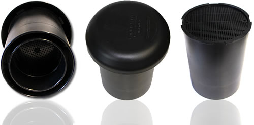

I figure the vent caps shown here would do better than a bug screen:

Moist air rising from the pipe condenses on the cold screen. Condensation freezes.
Has to be realy cold though, like single digits.
And too much air flow will keep it from freezing.
