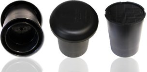

I figure the vent caps shown here would do better than a bug screen:

I am trying to design a new home that will keep the pests (scorpions, centipedes, crickets, etc) from coming inside the home. Here in AZ, scorpions, crickets, roaches, etc, mostly come in through the bathroom vent fan duct work that exit out the homes roof. I figured out a way to stop that in the new home by having the bathroom vent system all connect to a HRV system and then only have one side vent through the wall with a bug screen. VentZone Central Ventilation (requires flash to view) - iaqsource.com In addition to being a better design, it will also bring in fresh air into the home with the HRV. As this home will be VERY air tight.
Now for the next area, it's bathroom plumbing stack vents. Is it common to have roof rats, bugs or field mice try and enter through those plumbing stack vents? If so, what method can be used to stop them from going inside of those vents?
If you are designing a new home, why not revent all the vents into one stack(with only one roof penetration). Then use a screen on that one vent(preferably in the back of the roof)?
   / Plumbing Stack Vents #18
It's not believable that a mosquito will travel down 30 to 130 feet of pipe to lay their eggs on an anoxic water source with an atmosphere with not inconsiderable amounts of hydrogen sulfide, methane and other toxic atmospherics.
Sorry, I wouldn't worry about it.
   / Plumbing Stack Vents #19
Skeeters are tough! When West Nile virus showed up in New York/Long Island, they noted that mosquitoes overwinter in subway tunnels. The mosquito would lay its eggs in the septic water, the larva always live in water.
I don't see oxygen being much of an issue. An old tire laying around with warm rain water full of algae in it cannot have much oxygen in the water. I don't know how common it is, but I would think it is possible with the right conditions.
#20
As far as bathroom vents, they will all connect to a single HRV unit and then vent out the side of the home with a single 6" or 8" vent hole.
Now as far as plumbing vents go, I will try and get the bathroom ones to connect together and exit out the roof with just one stack vent. I might employ some Studor AAV's in areas like the kitchen sink. They are certified and recognized by most codes. I don't buy the argument that because they have a moving part that are unreliable. If one applies that standard then anything in a home that has moving parts including faucets, shower controls, toilet valves, kitchen sink faucets, etc. is unreliable. Engineers have done studies and research on AAV's and they have verified that they work just as well as the old fashioned plumbing stack vents and can work without issues for decades. One just needs to do annual checkup on them and replace the $40 part if they are bad.
So to recap; one single bathroom vent for all the bathrooms and most likely one single plumbing stack vent with a vent cover. Just two protrusions; one roof and one wall.
