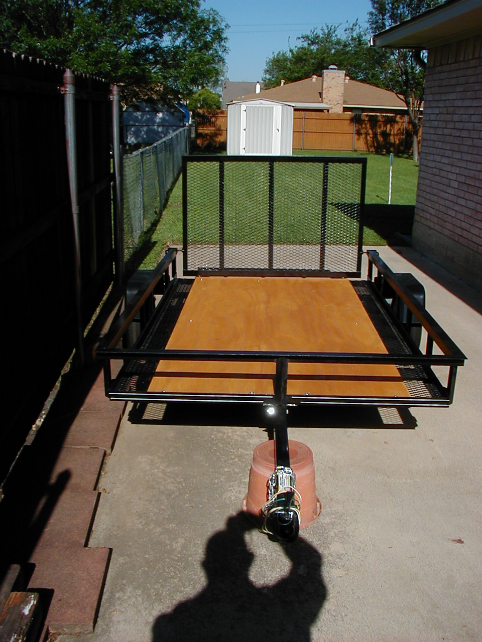

Of course I don't really know what's the "best" thing to do, but I bought one of the trailers with the mesh floor this Spring, so just to have a more or less solid floor (well, most of it anyway) primarily to haul a ZTR lawnmower, I bought the cheapest untreated quarter inch plywood Home Depot had. And I happened to have some Thompson's Advanced Water Seal in the Honey Gold color on hand, so I put the plywood on sawhorses, applied the Water Seal with a paint brush, let it dry, turned it over and applied it to the other side. I reckon only time will tell how well it holds up left out in the weather all the time.
