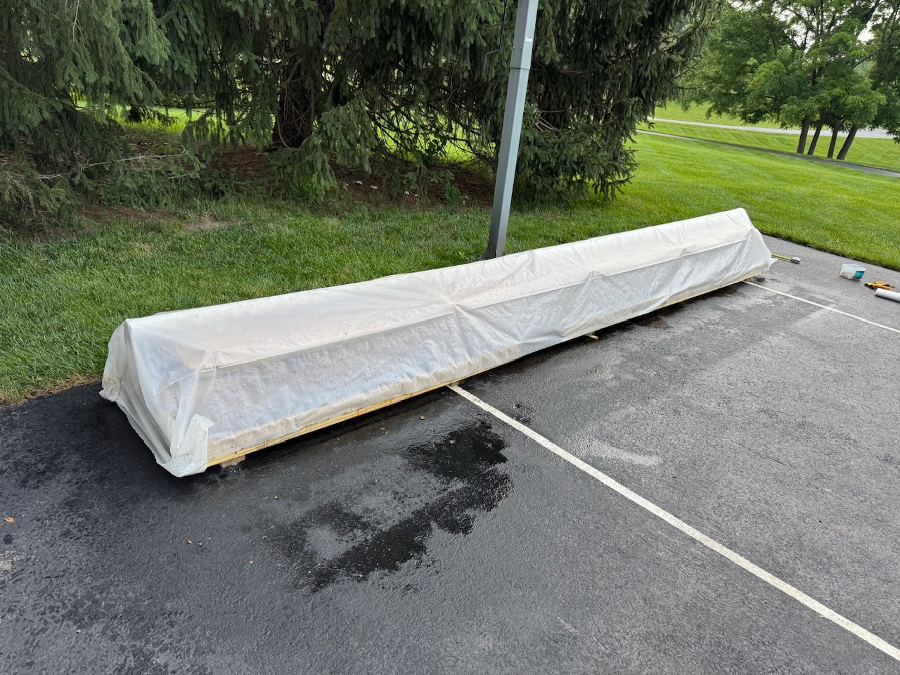

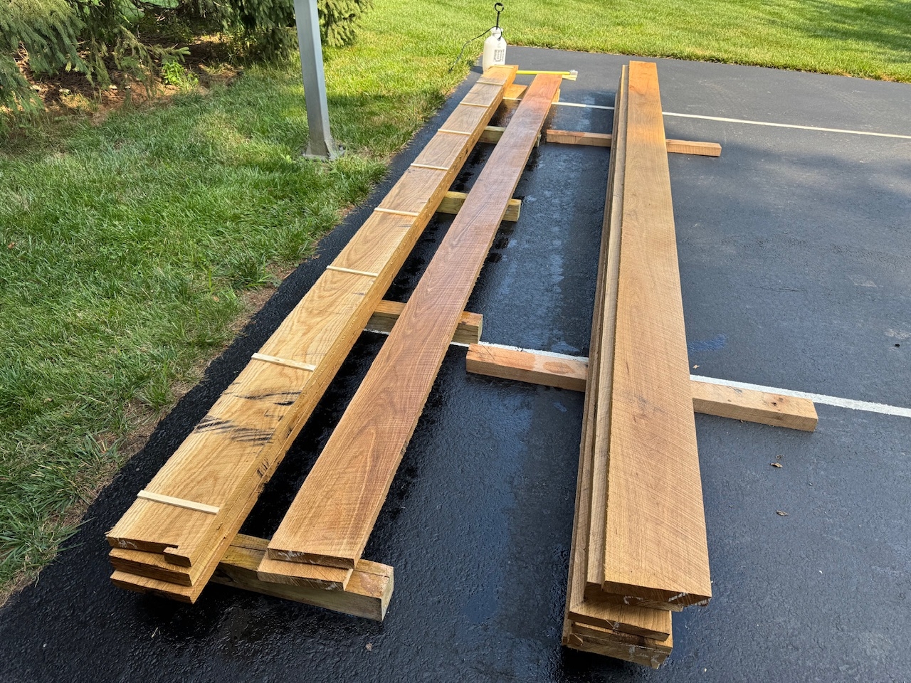

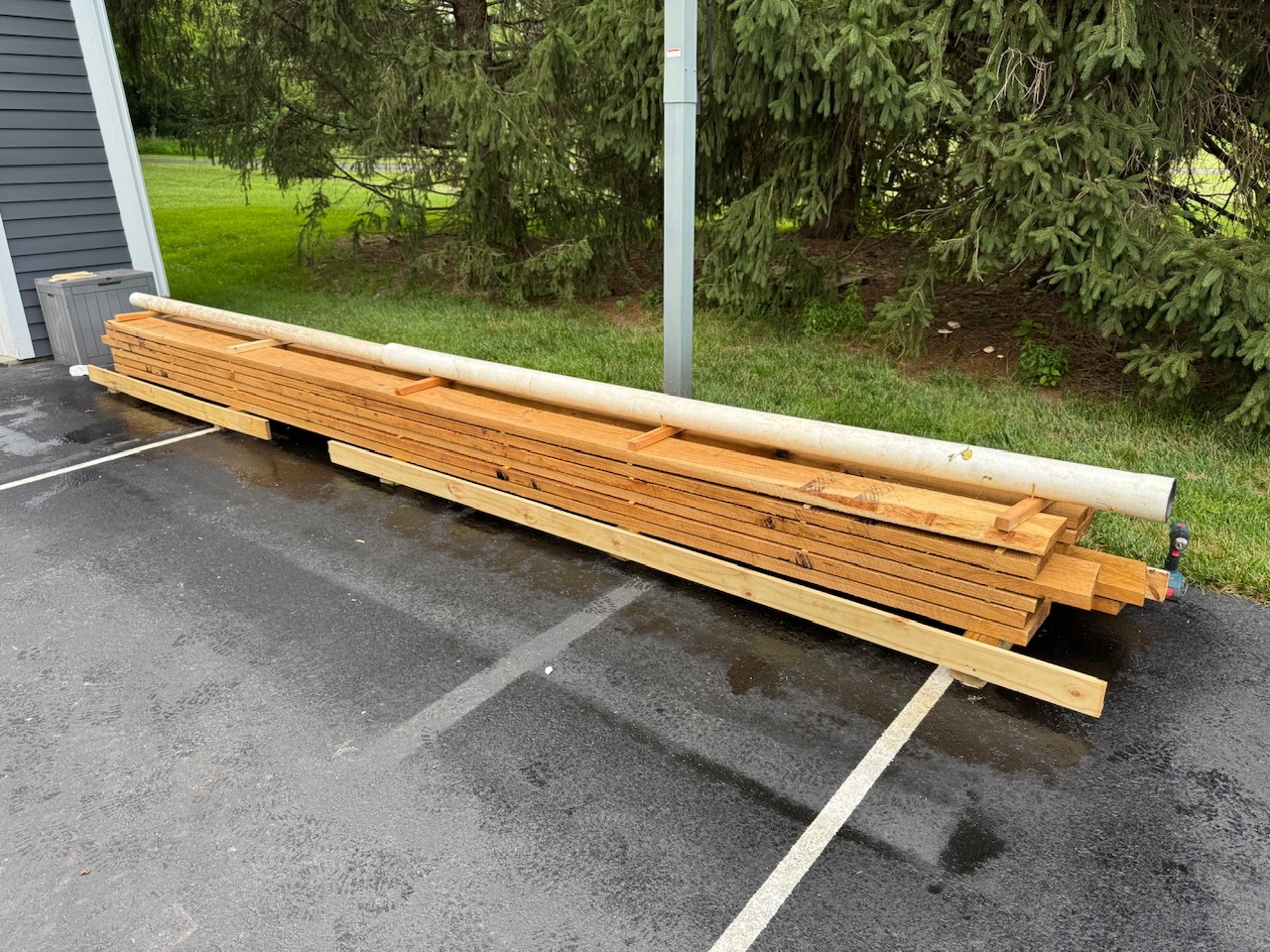

Boards are home, treated, stickered, and in the “kiln”!
I’ll have to lift the plastic at the ends after the next rain passes, to seal the board ends with paint or wax. Today was all a rush to get them treated and covered before tonight’s rain.
There’s some real nice figuring on some of the boards, as quarter-sawn oak tends to have, nice striping and ray flakes. Almost a shame it’s a trailer floor. 😀

Just asking...
Is there any airflow in and out of the "kiln".
   / Yet another trailer decking question...
#26
Just asking...
Yes, there's a gap down each long side, but I'm not convinced that's enough. I plan to add some stringers to the long top corners, attaching them to each end of the cross members supporting the pipe, just to gap the plastic off the oak a bit better. But if you have any advice on how to optimize ventillation, I'm all ears!
I know there's a sweet spot, adding enough ventillation to let trapped moisture out, without allowing much heat to escape. As it is now, it's vented from below, and any evaporating moisture should condense on the plastic and drain down to the edges at night. But I have no real experience with this, I'm just copying what I've seen others do.

There's no need to kiln dry oak for a trailer deck. I'd let it air dry for a week or two and then bolt it down. If you were making furniture, sure go the kiln dry route.
#28
I move about 60,000 pounds of oak per year, I know the wood better than most. White oak in particular takes about 3 years just to reach 18% moisture content, and our equillibrium moisture content (EMC) for white oak in this climate is around 15%. Did I mention I use a lot of white oak? :ROFLMAO:
Fresh cut white oak has very high moisture (45% to 200%), and my goal is to knock it down at least a little closer to the 15% EMC for our area before installing, to avoid having it just tear the deck fasteners out as it dries from this fresh-cut state. The only way to do that in a matter of weeks, rather than a matter of years, is to kiln it.

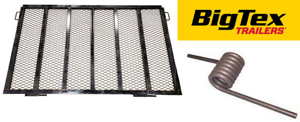

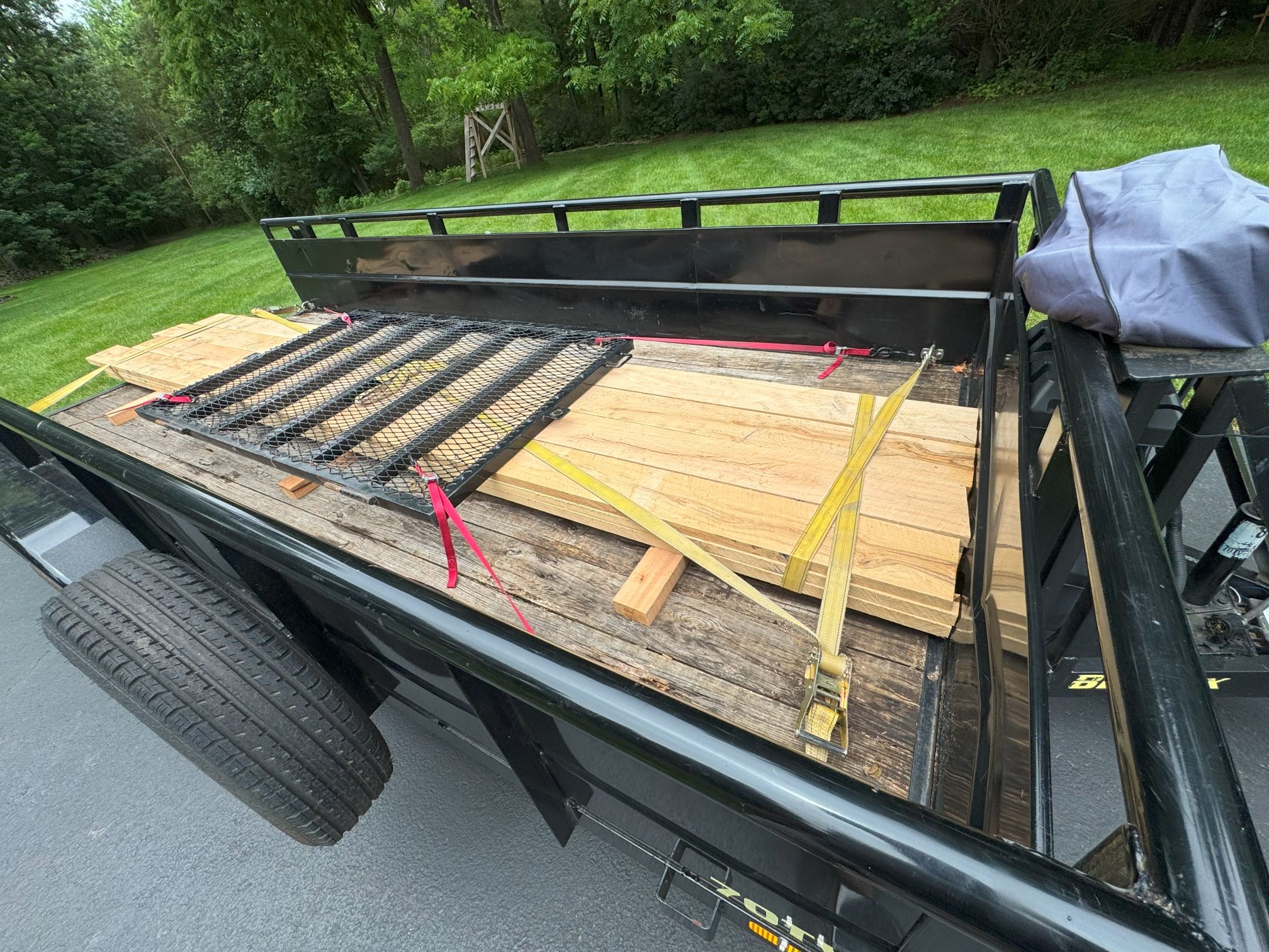

As I finish up the battery box mod's and painting, I'm looking at my tailgate, the expanded metal of which is really caving in quite badly. I'd like to improve it, with four things in mind:
1. Not make it any heavier.
2. Improve or at least not make worse the ability to skid logs up the ramp with my winch. Yeah, I should probably build a swing arm type log lift onto the trailer, but dragging them up the ramp has always worked well enough.
3. Give better support to the expanded metal, as it's caving in quite badly under my tractor's front tires. Made worse by the fact that I'm often hooking onto and lifting 15 foot logs out while front tires are on the ramp.
4. Possibly split ramp to reduce how high it sticks up, as I'd love to put a short roof over this trailer in storage.
I think item 4 is probably off the table. I can't imagine any split ramp handling the weight of my 3033r with max load on the FEL. Also, sometimes I transport the tractor with a crap-ton of rear ballast, when going to logging jobs, and I don't even want to think about a possible ramp failure while driving up onto the trailer.
That leaves us three criteria, with item 2 being the only real challenge. How can I make it easier to skid logs up that ramp, without hurting tire traction? I'd be great to just weld some vertical stringers onto the ramp deck, as guide log ends right into the bed, but it'd be awful slippery for snowy tractor tires trying to climb the tailgate.
Any ideas?

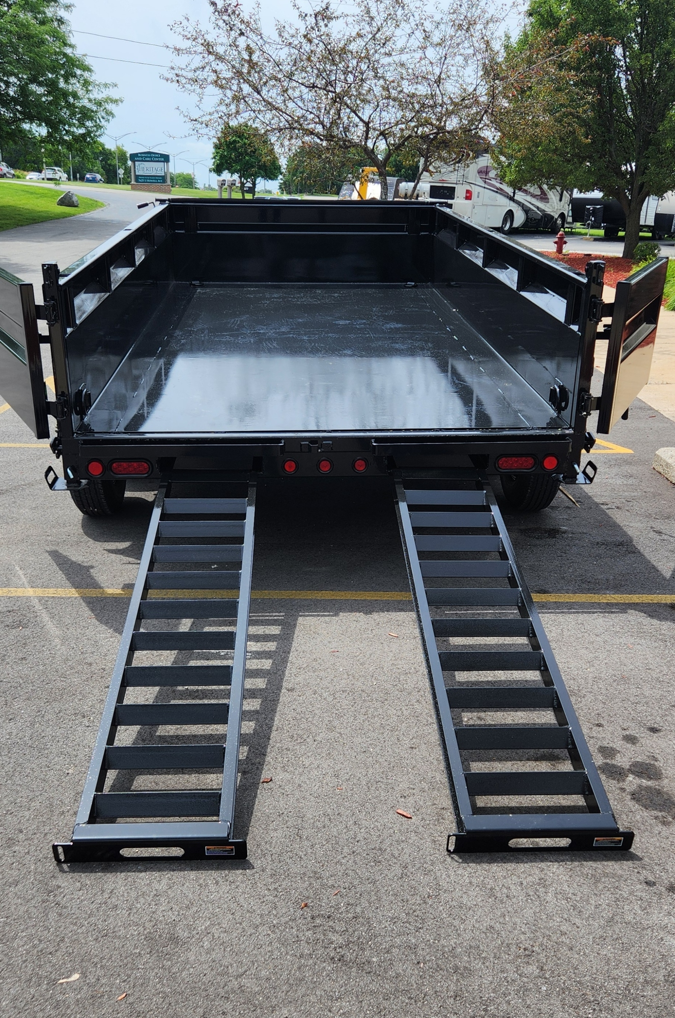

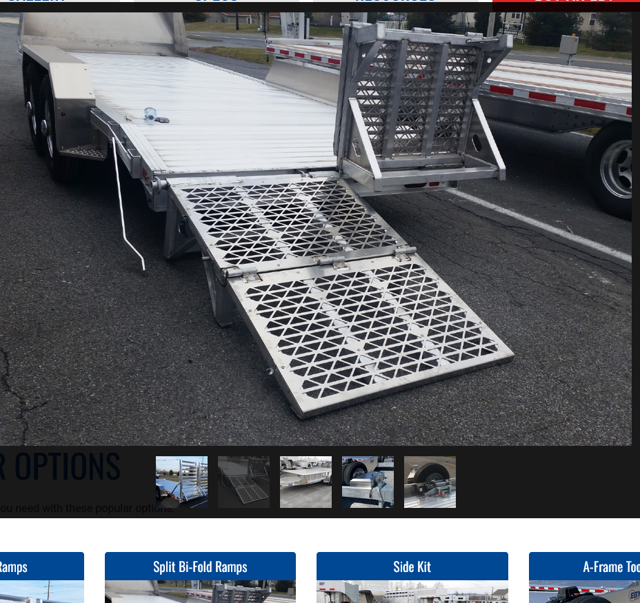

   / Yet another trailer decking question... #33
Have you considered two fold up ramps, that way they can stronger and heavy duty split folding but still be manageable.
#34
I've seen them, but can't imagine how I'd skid logs up into the trailer without a continous ramp.
   / Yet another trailer decking question... #35
#36
Oooh! Those are nice!
Thanks, Lou! Will dig in on that, soon!
#37
Oh, one thing I notice is the rib spacing is at least as wide as that on my current tailgate, meaning I'll probably collapse the expanded metal... which might be fine.
When you first mentioned split ramps, I thought you were talking about these:
