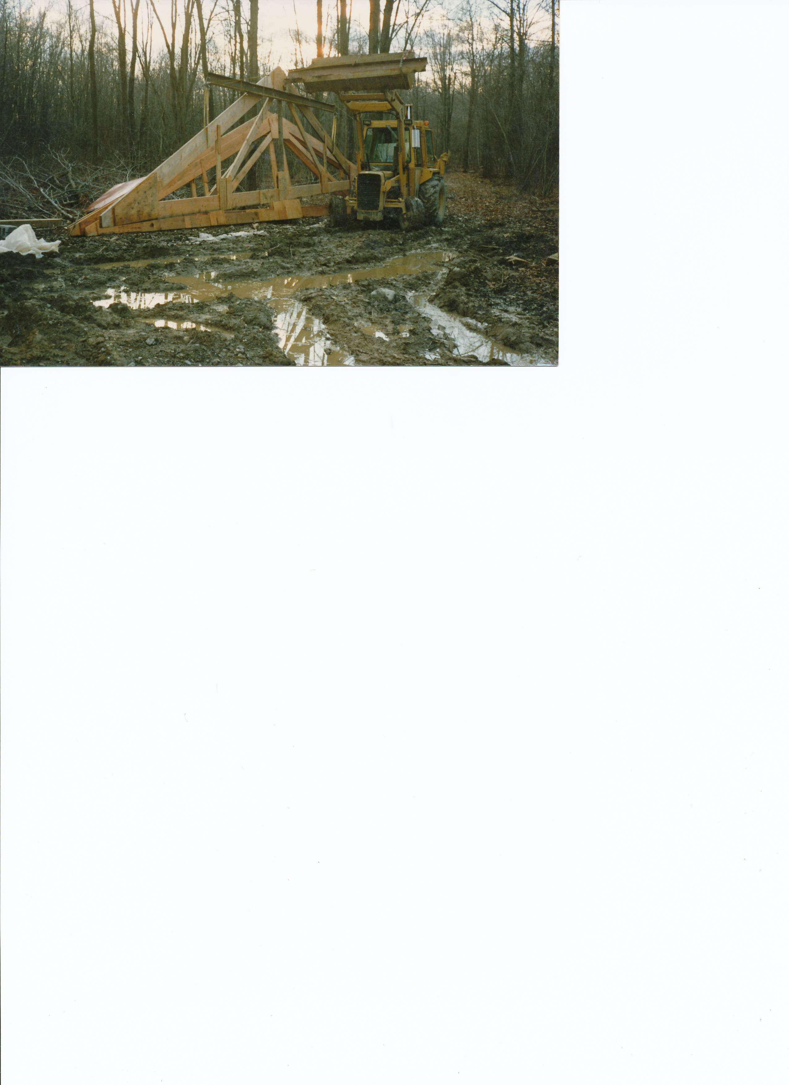

I built the trusses myself. Cornell Ag extention service published a Farm Building truss book All sorts of design loads and pitches . They used plywood gussets and waterproof glue ( I used water resistant)( better stuff available now) and nails for clamping pressure. I did not have a nailer at the time so all the nails were by hand , on a 2" x 4" grid over every gusset , both sides. They were hugh 2 x 12 for top chord and 2x 10 for the bottom . I added a king post for the I beam load. (per the ag book) The dead load, plywood and shingles and the Live load Snow had a bearing on the pitch.
8 ' centers drove a lot of the chord size. When I was done the space at the top popped out.
I have had 5 tons on the I beam and nothing even creaked. Although the trick to heavy lifts is not to try and roll them on the beam. Just lift and pull the trailer out, then let it down and move it on pipe rollers. The town Building Inspector had a fit when he saw the beam but I know how to handle that. I had my engineer sign it off. ( friend)
I will post pictures when I get them scanned.
No vibration at all from the compressor but I can hear it running. Don't forget there is ceiling insulation between. It was interesting getting it up there. Chain falls at the peak

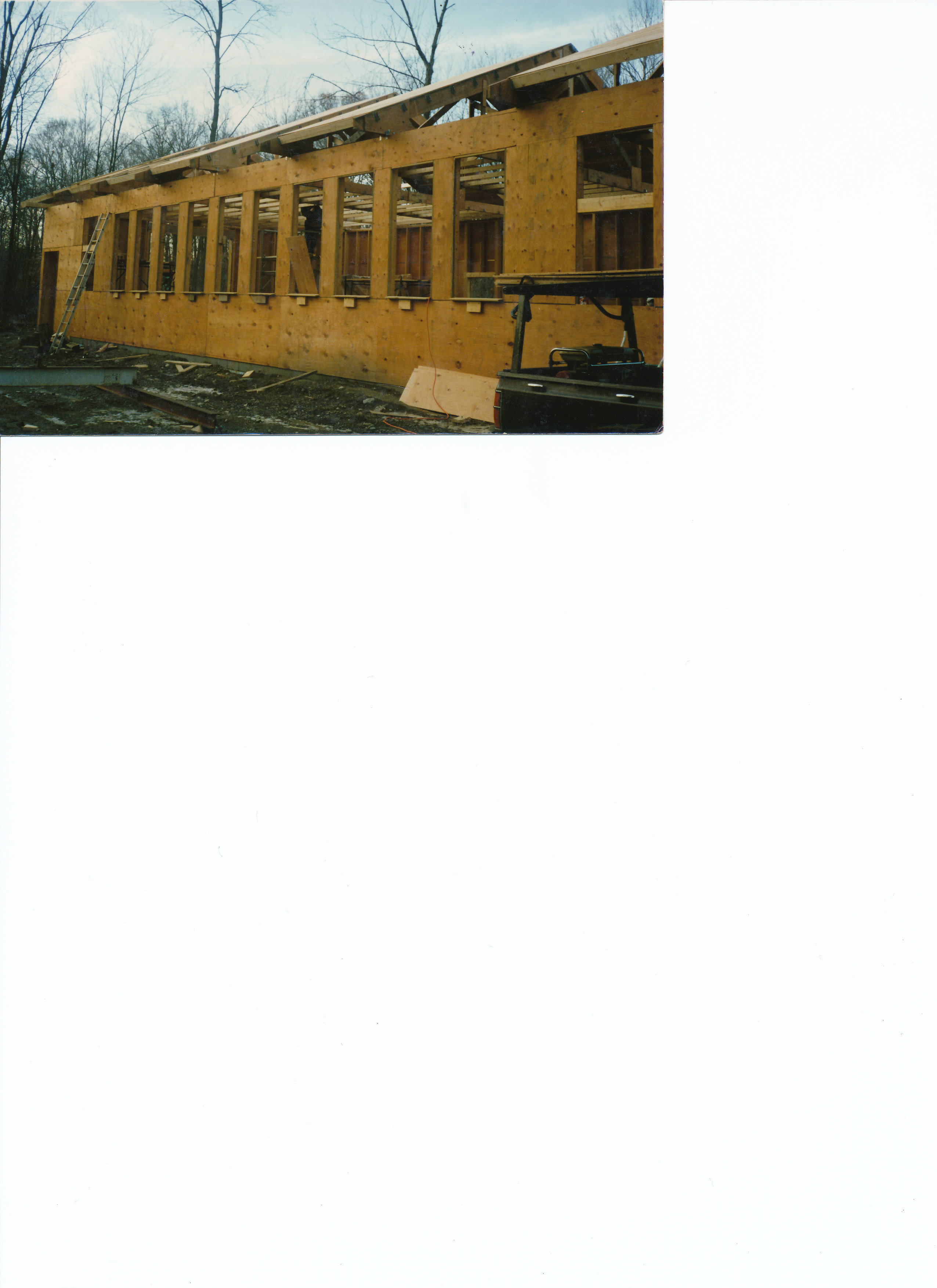

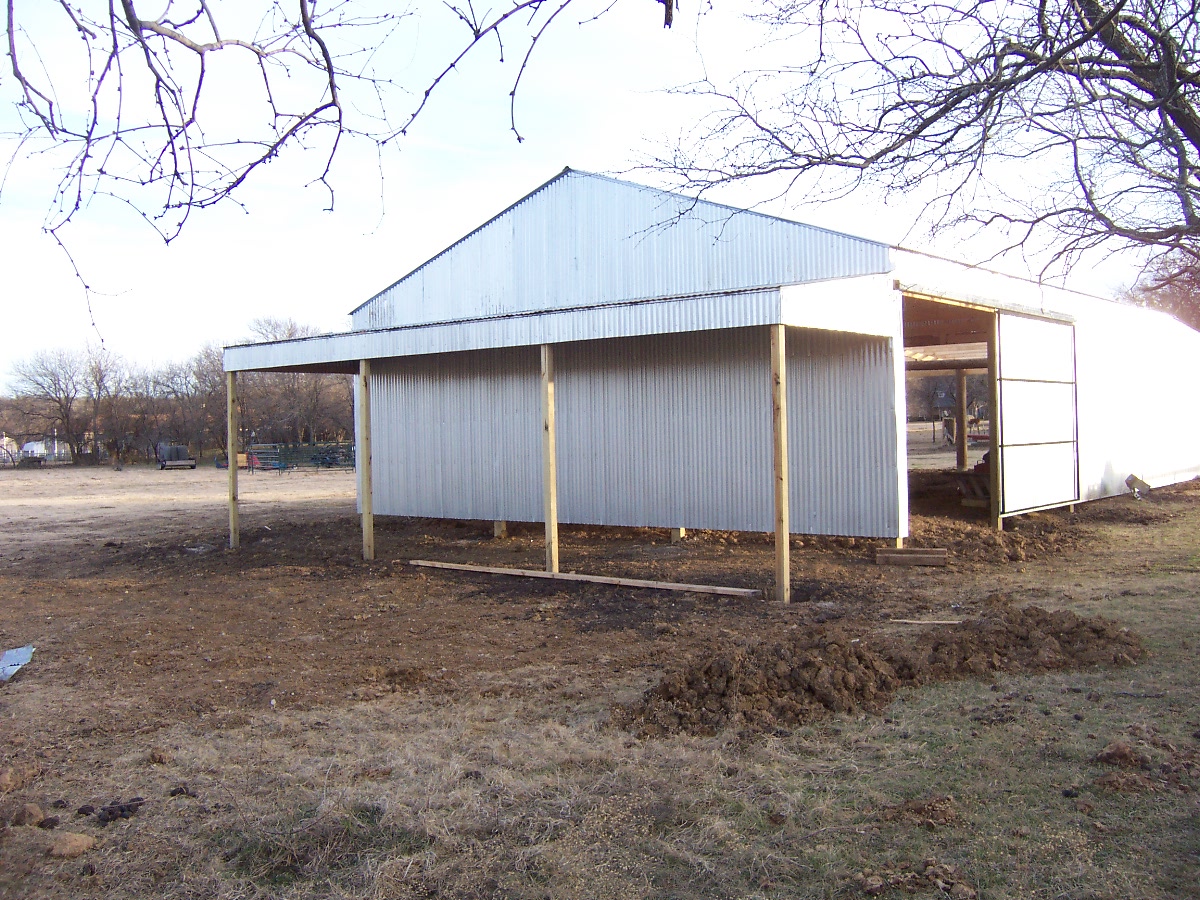

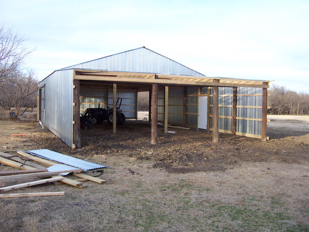

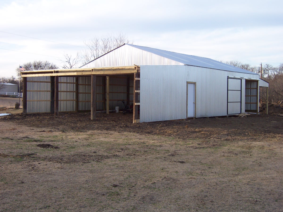

Took a while finally got a scanner so here are some barn construction pictures.
   / Pole Barn Advice #47
sorry not paying attention to scanner

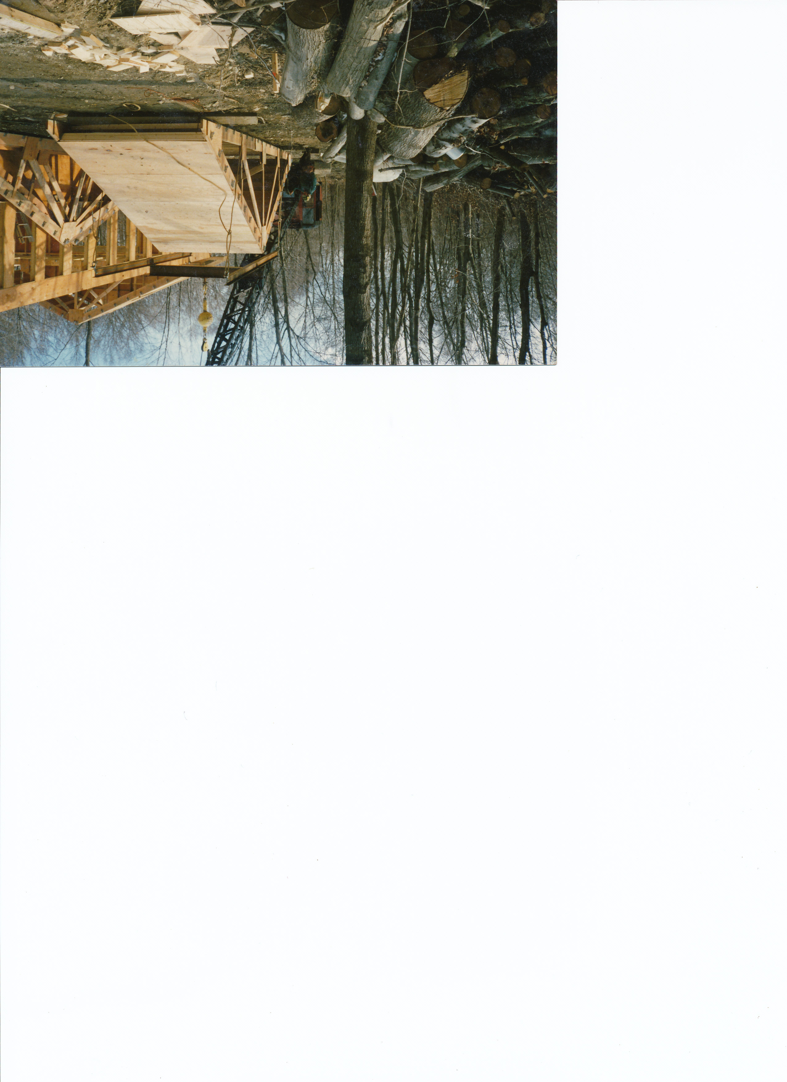

Cannot seem to reload the upside down one right side up. This shot is the full load of insulation for the ceiling. Same stuff as tennis courts. 4 ft wide as long as you want 6 inches with a facing. Just unrolled it over the joists and let it lay there. The facing became what you saw for the ceiling .

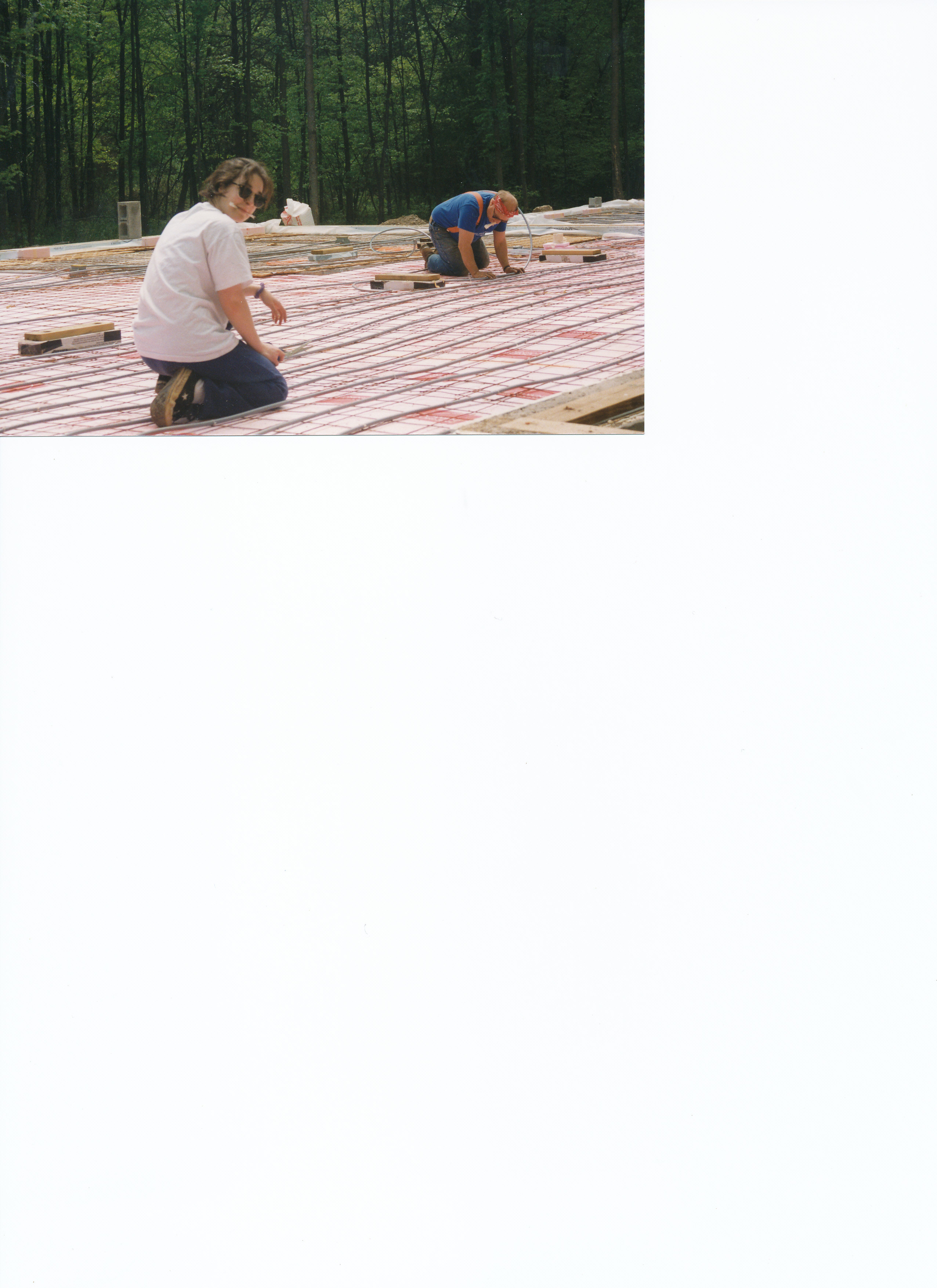

Here is the reason I had to get a scanner. My daughter helping with radient heat tube tie down for the house. She is getting married and I had to scan in shots for a rolling DVD show on a flat panel at the wedding. Losing my helper. But then again gaining another one. They seem to like to help around.
