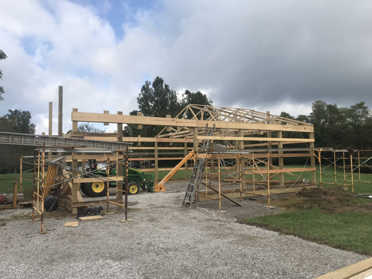

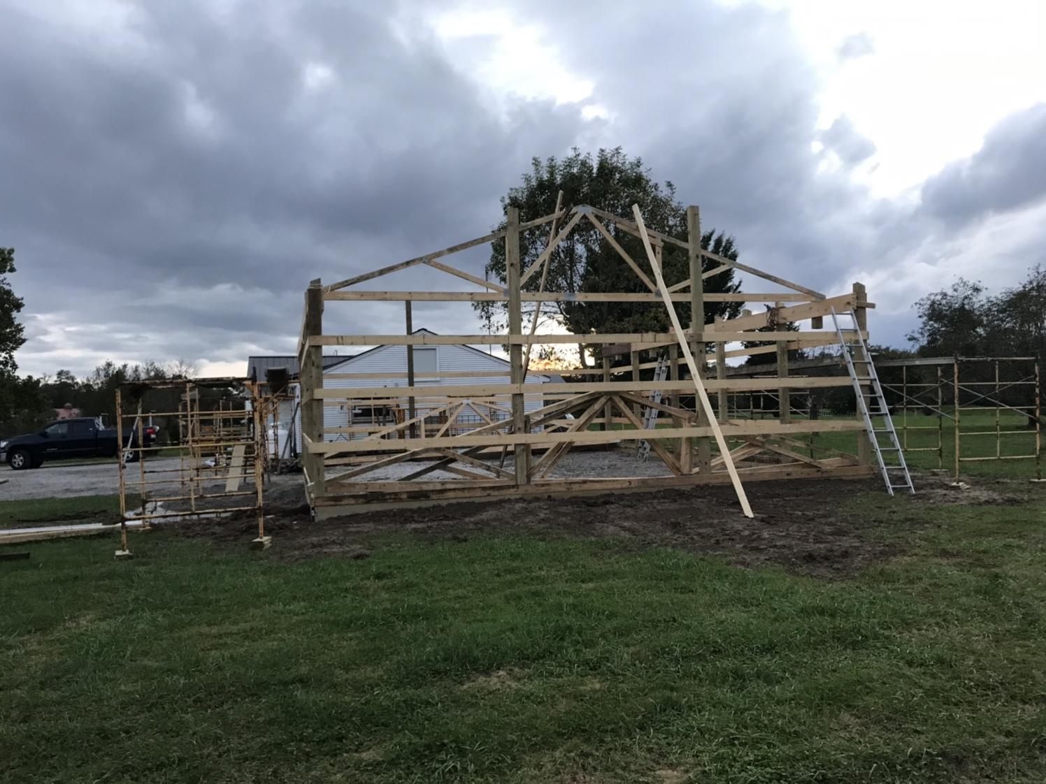

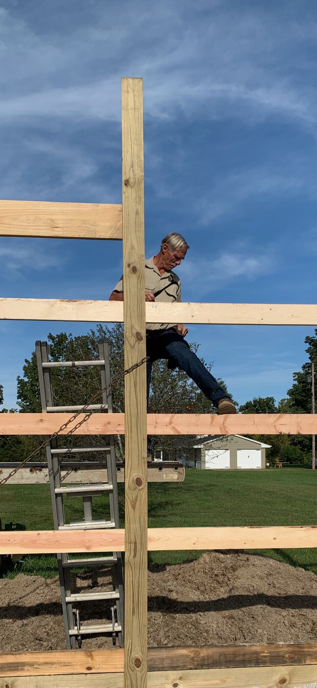

I’m off and running on the pole building project.
   / Pole barn build now or wait? #63
Great progress! Congratulations! Getting the trusses up is a big job. Everything seems very shaky until the purlins and bracing goes in. Good Job!
#64
Thanks, It is a lot of work especially since it's only me and the tractor.
BTW I'm still waiting on some of the correct material to arrive from Menards.
   / Pole barn build now or wait? #66

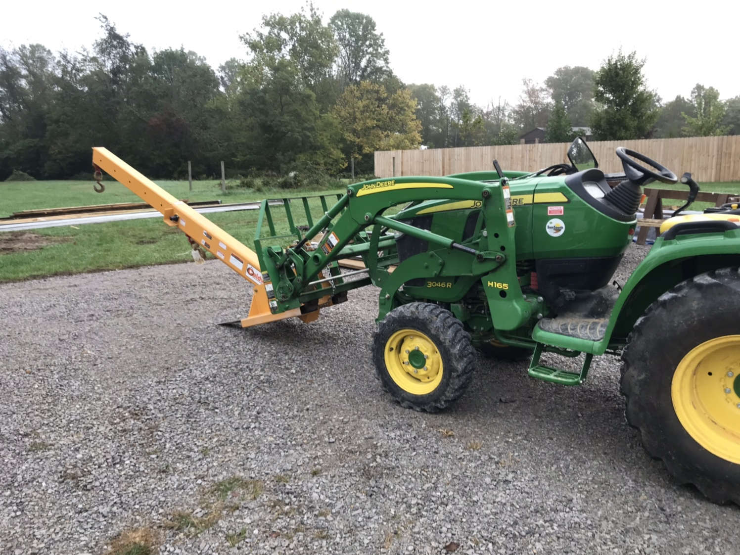

Very nice! Especially impressive to do all solo.

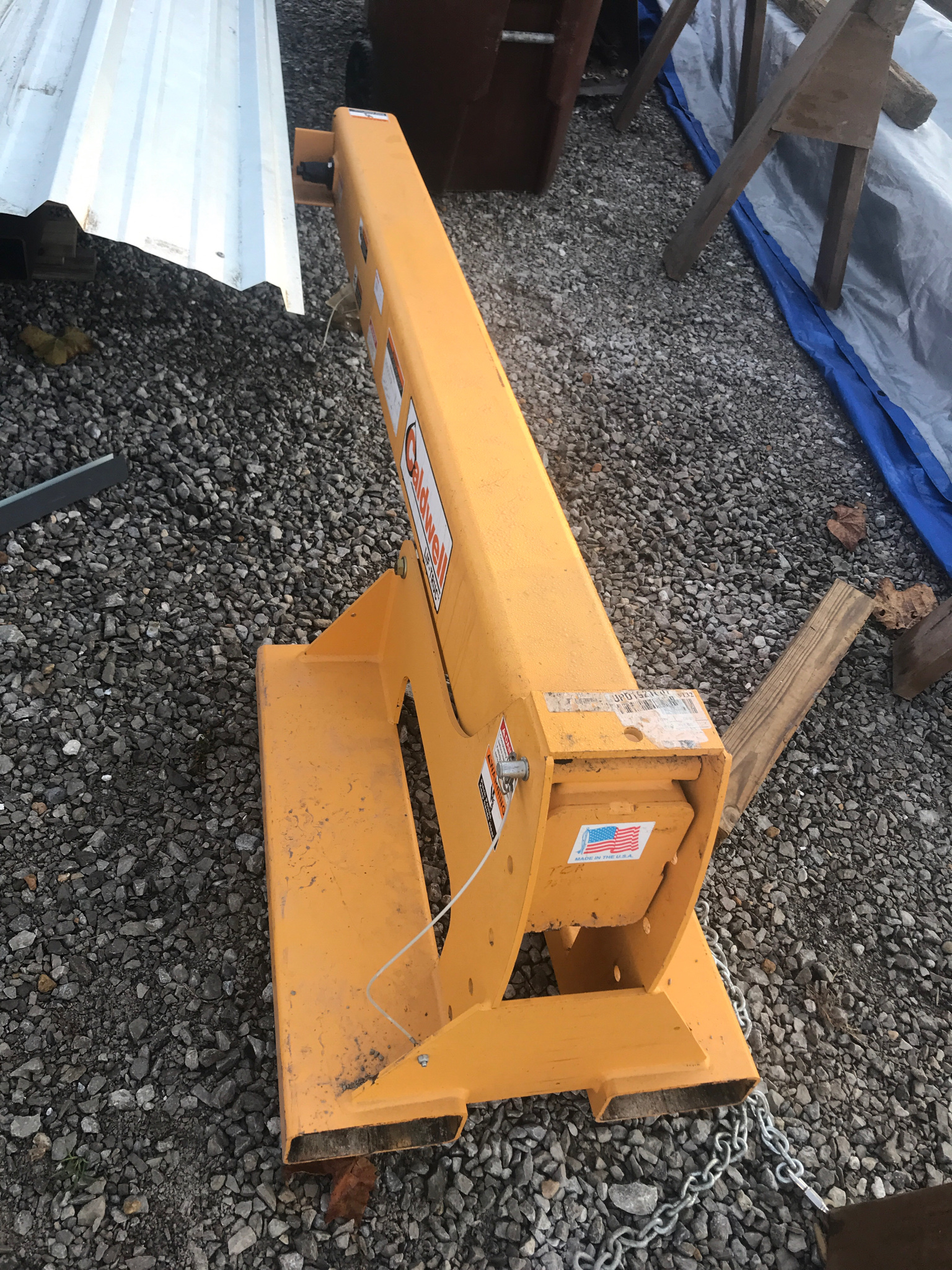

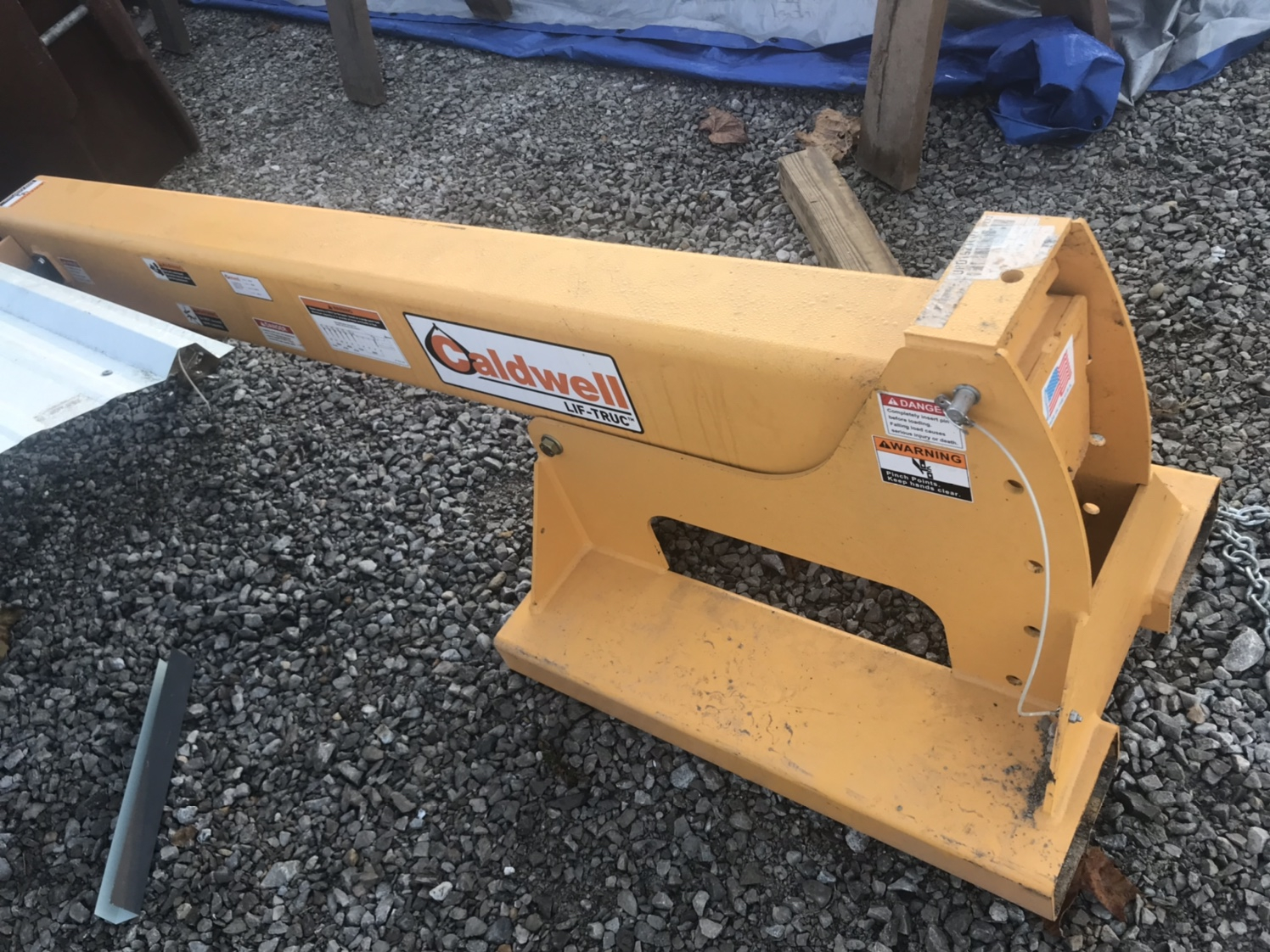

Nice fork-mount boom pole; how heavy is that sucker?
   / Pole barn build now or wait? #67
Looks great. I really like your boom pole!!!
#68
I do my best work by myself 🥵
I borrowed the jig from a roofing company that I am friends with the owner. Originally they were supposed to let me borrow a tow behind man lift but it was at a job site.
It’s a little heavy but I worked out great.

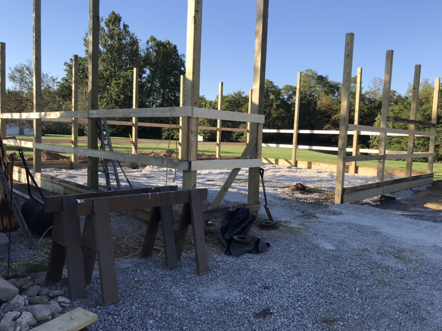

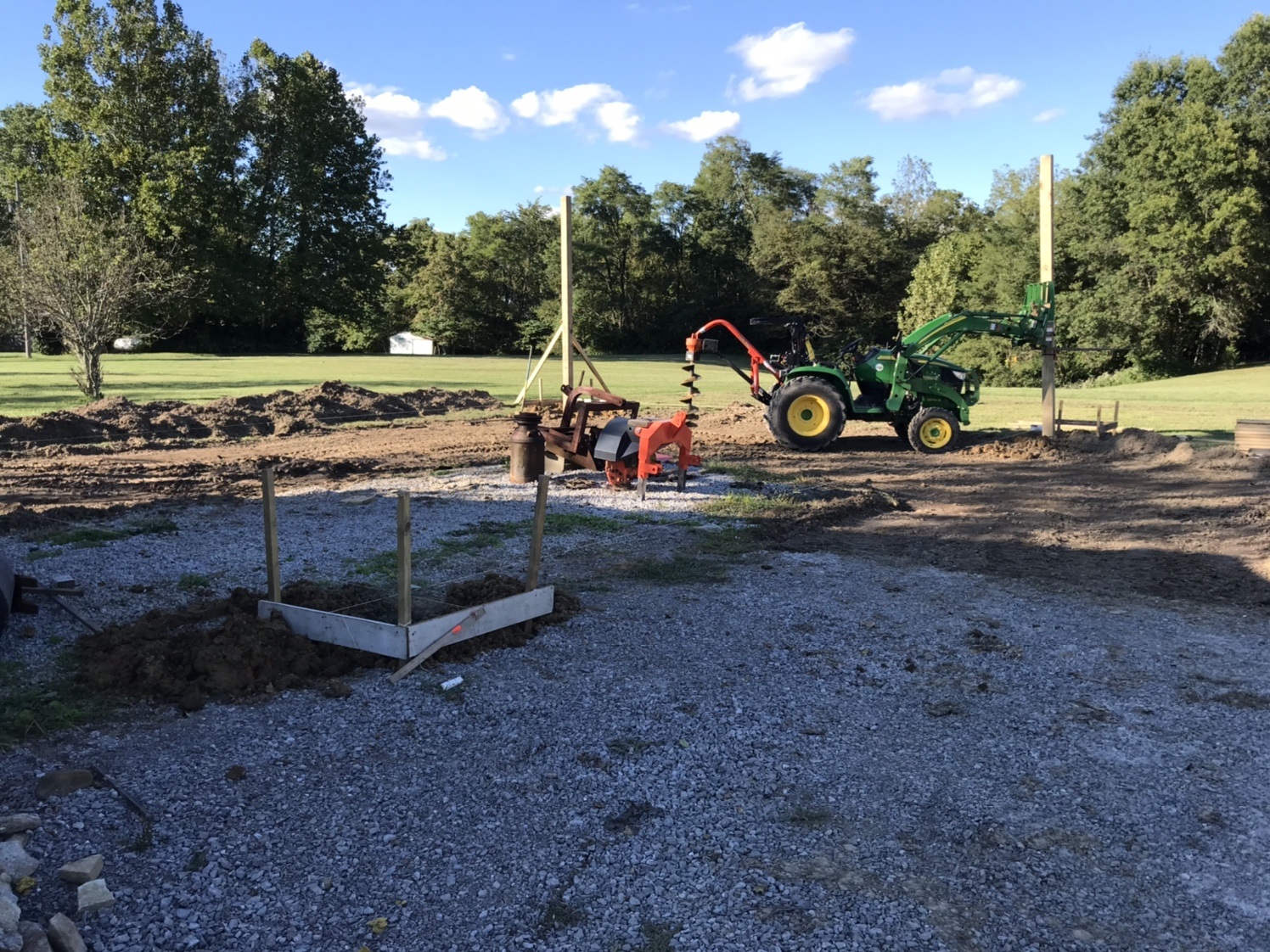

I put a bag of concrete in each hole and tamped it a little with a small piece of plywood on the bottom of a 2x4 then set my post plumb and tamped them in good.
I used a spud bar for that.
