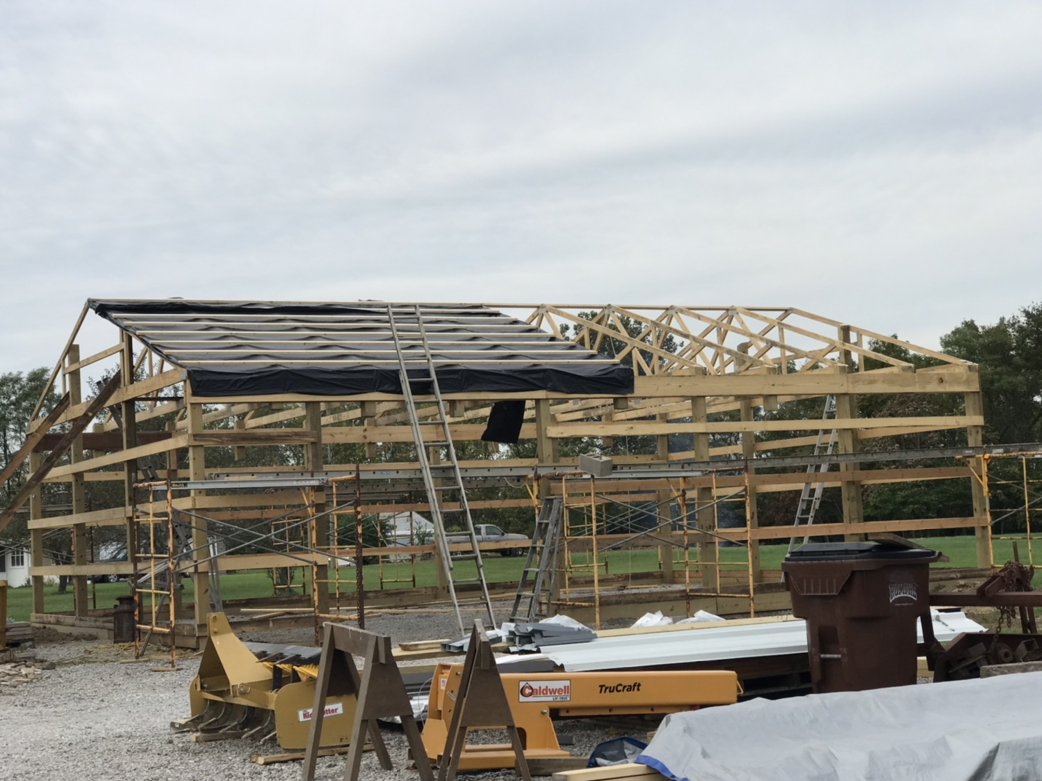

I had a couple rolls of mobile home underbelly vapor barrier that I am putting on the trusses then install the purlins.

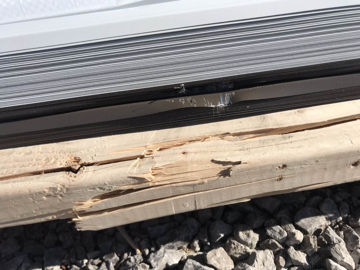

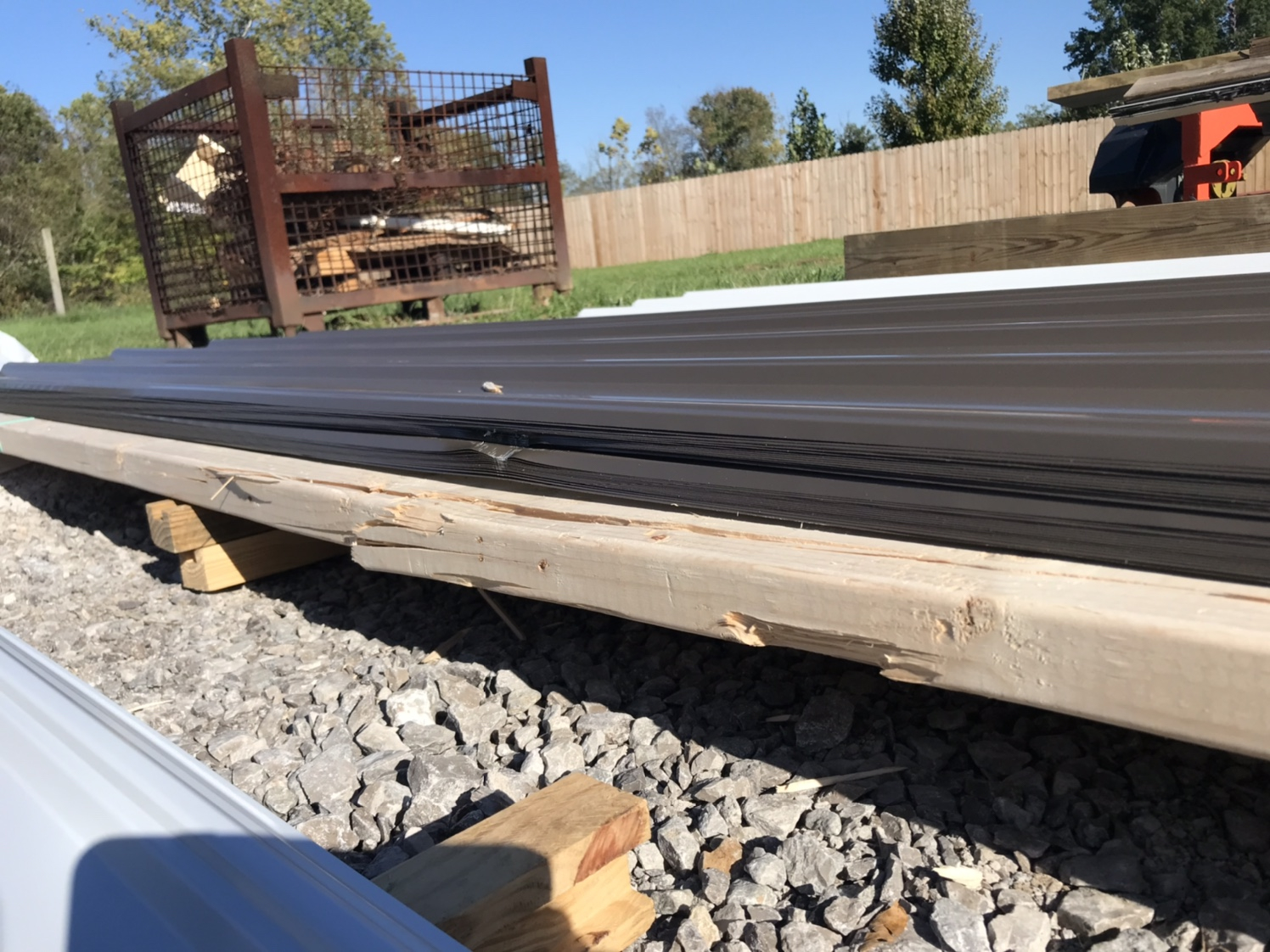

Yesterday I finally received the correct metal panels along with the overhang materials and bracing lumber that Menards dropped the ball on but after sorting through it I noticed the roof panels were hit with a forklift on the top lap of some of them.
If I straighten and use them it would stand out and I’ll have to live with the way it looks. It doesn’t have to be prefect but I paid for new not damaged material.
   / Pole barn build now or wait? #80
View attachment 717800View attachment 717801
i just finished my house and it seems like 1/2 the stuff was damaged from careless handling.
probably not 1/2 but way to much, that damage eventually shows up in the price of stuff.
