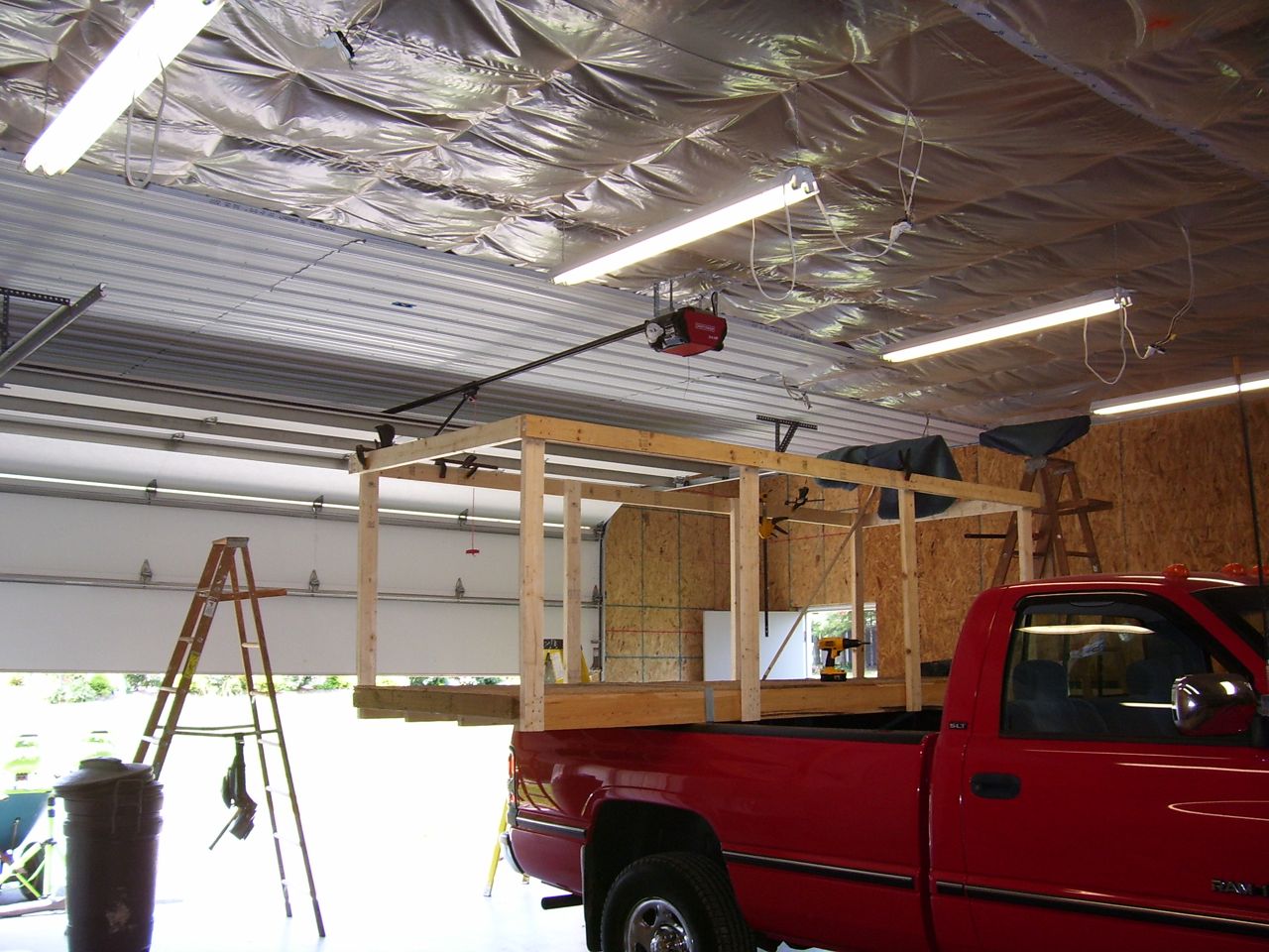

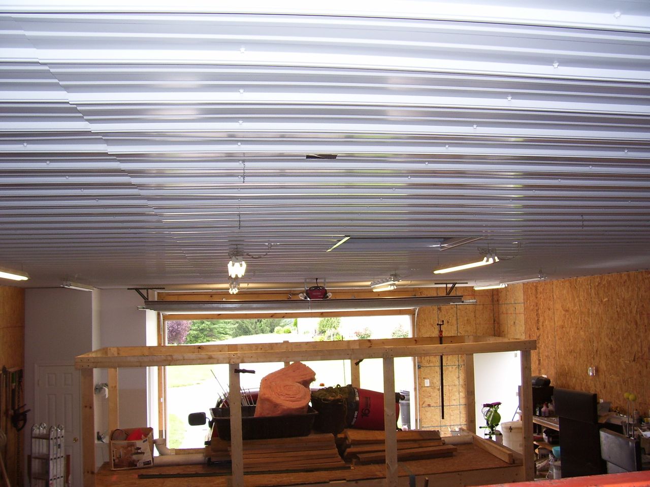

Here is what I used in my Morton building.

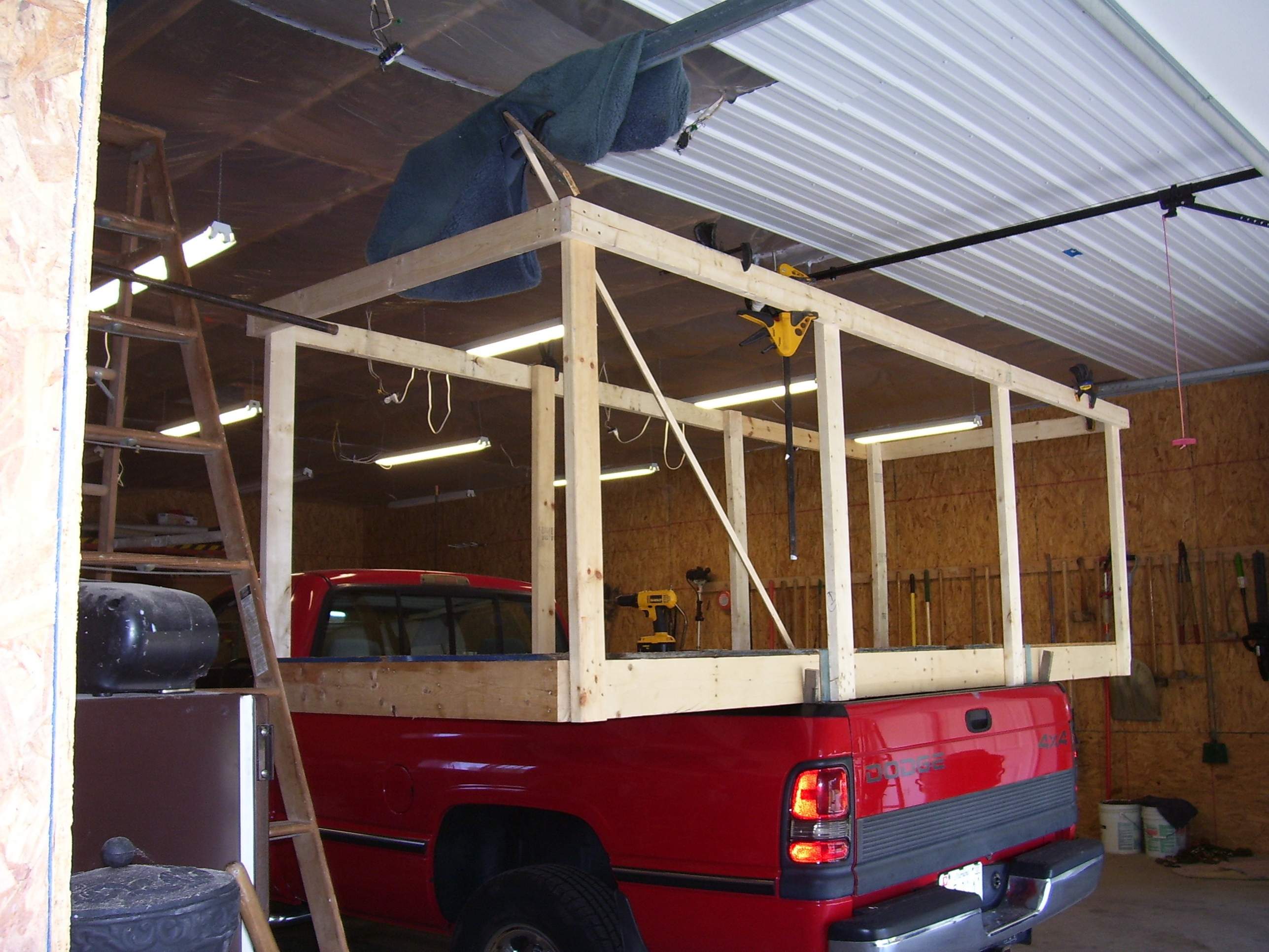

/ Pole barn ceiling options? #13
Nice! Is the framework on the truck your work platform for the job?
I made the temporary work platform for me to stand on while installing the ceiling panels, worked great. Of course I had to constantly move the truck but that was the easy part, thanks.
