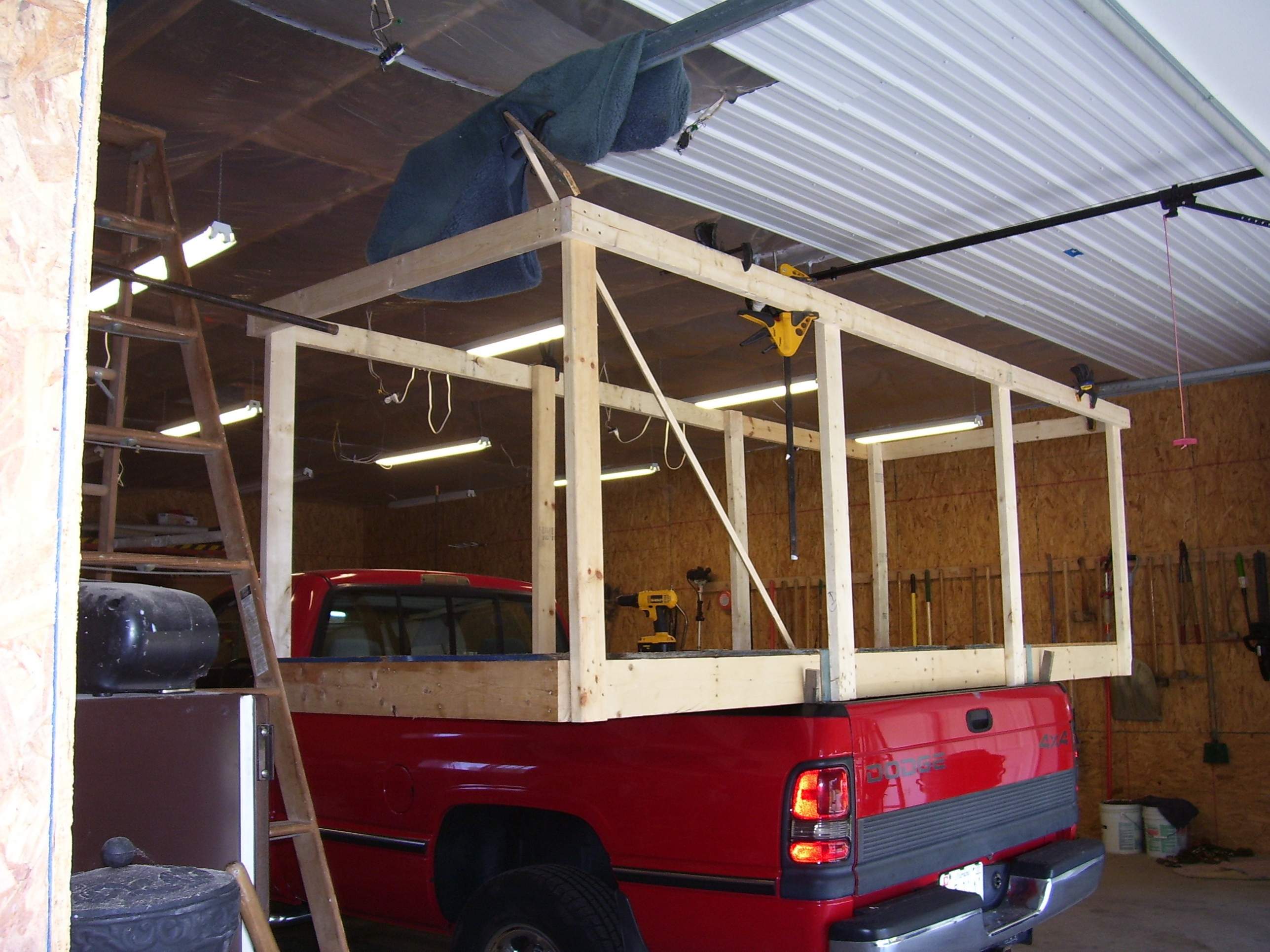

Few years back I did a 240 X 60 ft stable with 12 ft walls. We used metal for the ceiling, a model that was 3"wide with 3/4" square dimples. Screws were installed in the bottom of the square dimples making the ceiling seem 'screwless'. Well taped vapor barrier was installed under the metal.
We used standard scaffolding with pneumatic tires and platforms on top as our portable work platform.*
Screwing the metal ceiling over 4 ft spacing won't pose a problem (hanging) as the metal dimpling will make the sheets quite stiff once screwed in place.
The finished job was very bright and easy to light the space.
Metal is also a nice fire block.
Clients loved the finished product.
* these can be rented from most rental yards and as U know come 5' high but also they have 2.5' low sections as well so combined you have 7.5' high to work from leaving you choices to set the platforms on.
I recall we ended up with about 6" head clearance making for a super easy installation.
