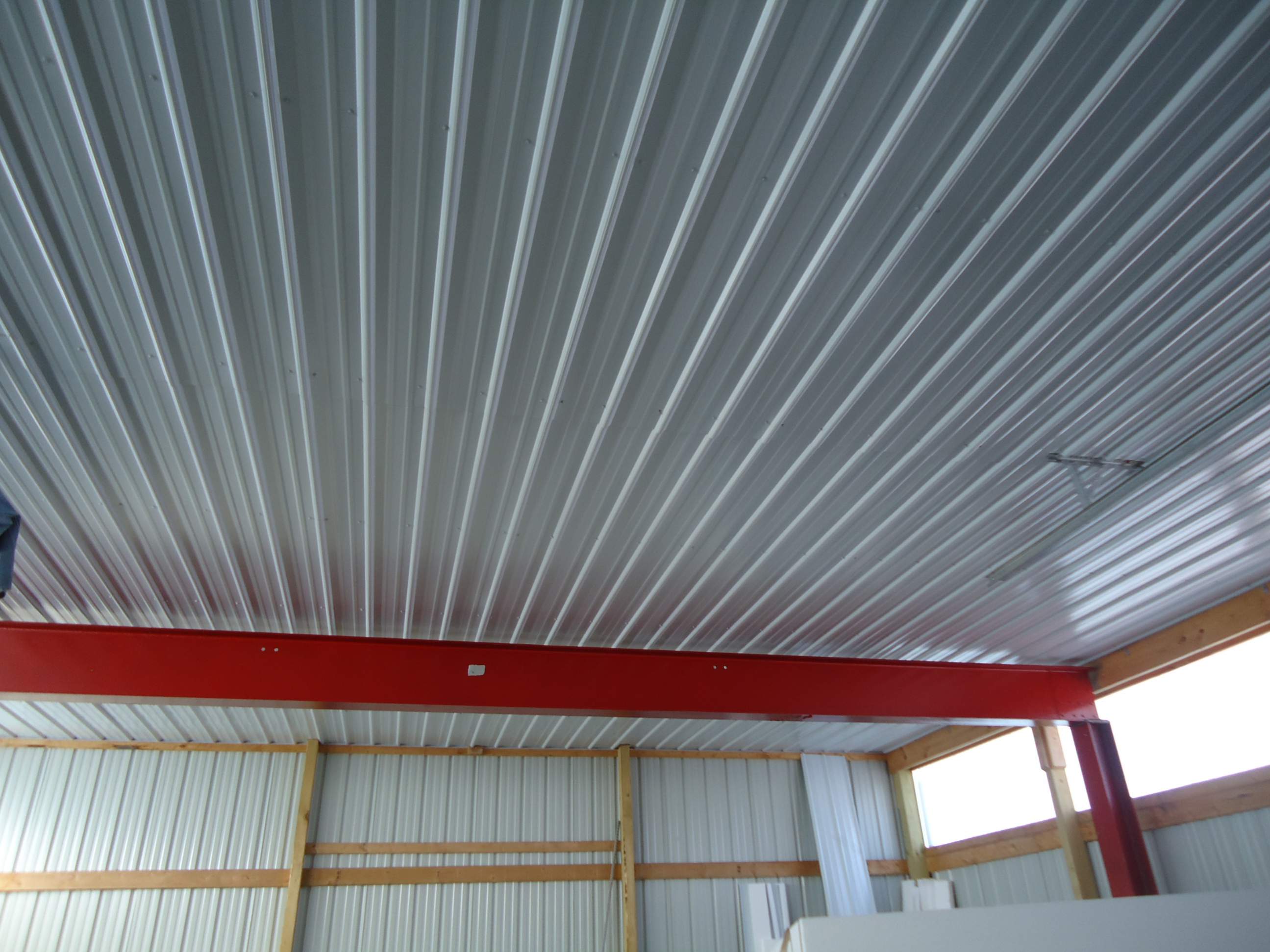

And you may want to consider using metal on the ceiling. Once up, you should never have to paint it. More than likely lighter in weight than OSB. Good reflection if you install ceiling lights. Pretty airtight too. You can get liner panel for approx. $60.00 per square. My new shop is 30' X 32' X 12', the metal and J-Channel ran me right at $600.00. I put this up by myself in 1-1/2 days with the aid of a drywall lift. Plus putting 1-1/2" styrofoam insulation in above the metal.
I had a contractor give me a price on labor to install it, and he quoted me $700.00.

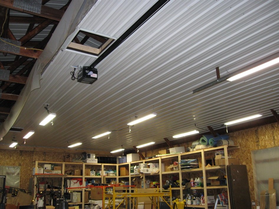

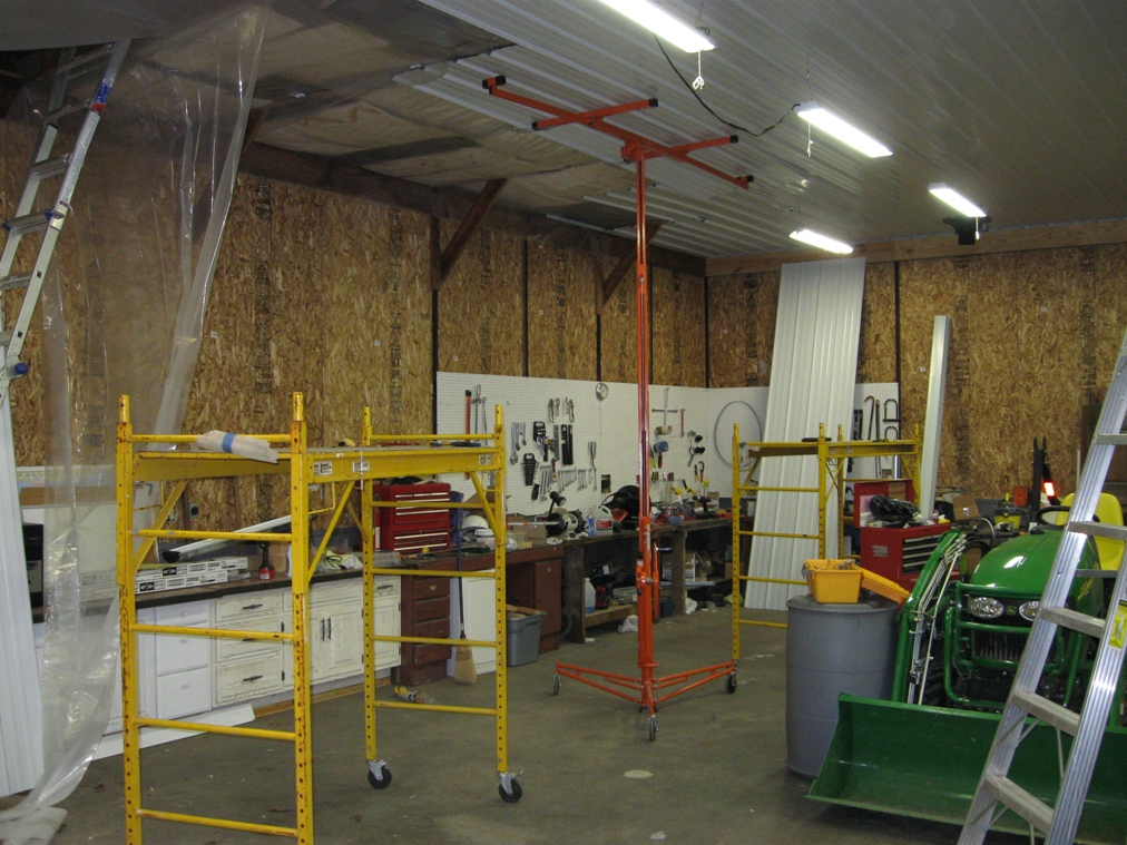

Just to give you an ideal of what it looks like being installed. Note the framed in access opening. This was a backfit into an existing building. For new construction, I would recommend putting the ceiling in first and then lag bolting attachment plates in for anything like garage door supports afterward.
/ pole barn ceiling #14
I like the look of the steel, did you bolt it directly to the truss or did you have to strap the trusses before instaling it?
/ pole barn ceiling #15
I just used the 1-1/2" siding screws. A cordless impact driver installing the screws is much better than a cordless drill.

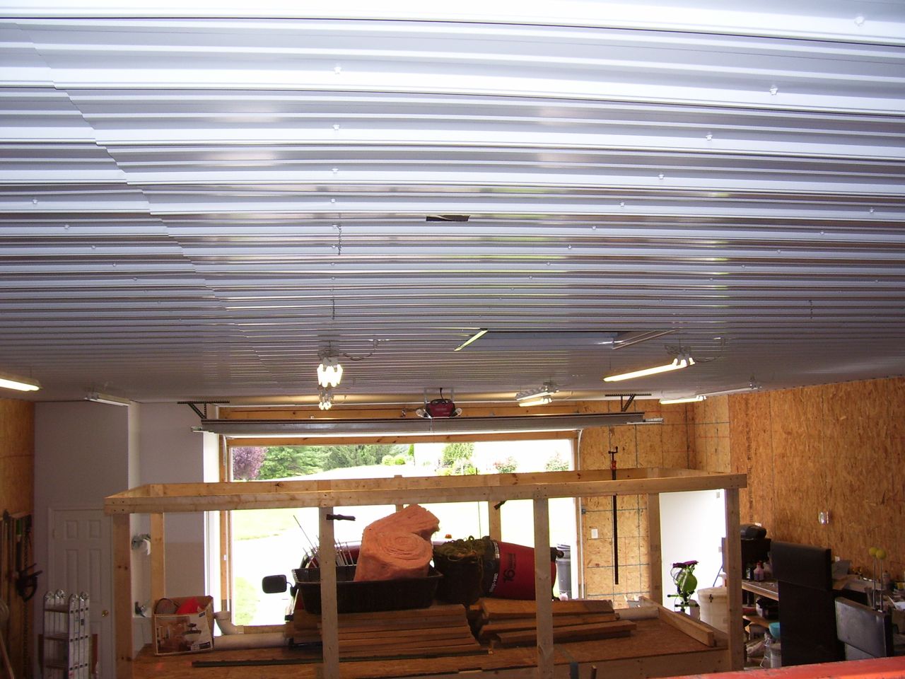

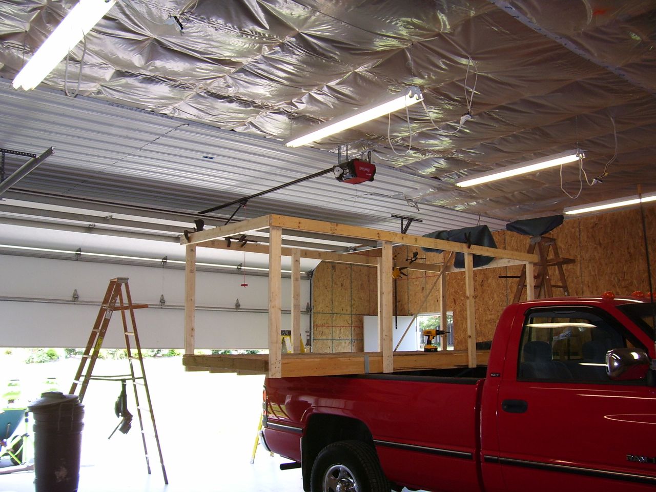

Jack, my ceiling (and lighting and walls) are very similar to KennyG. I placed 2 X 4's between the rafters every two feet flush with the trusses. After the vapor barrier was installed I used 3 ten foot pieces, easier to handle, then screwed them to the 2 X 4's. You can see the poor boy's man lift that was set up on the bed of the pickup to move around the building ( 30 X 45 ). It worked really great and was quite safe. I made some Tees to support the panels. You can also see the access panel to get into the attic space.

srs, that "lift" is pretty inventive. I was working alone and using 12 foot sections with a 12 foot ceiling, so I bought a cheap high lift drywall lift on E-bay. I'm going to sell it as soon as I get around to listing it, so the net cost should be minimal.
