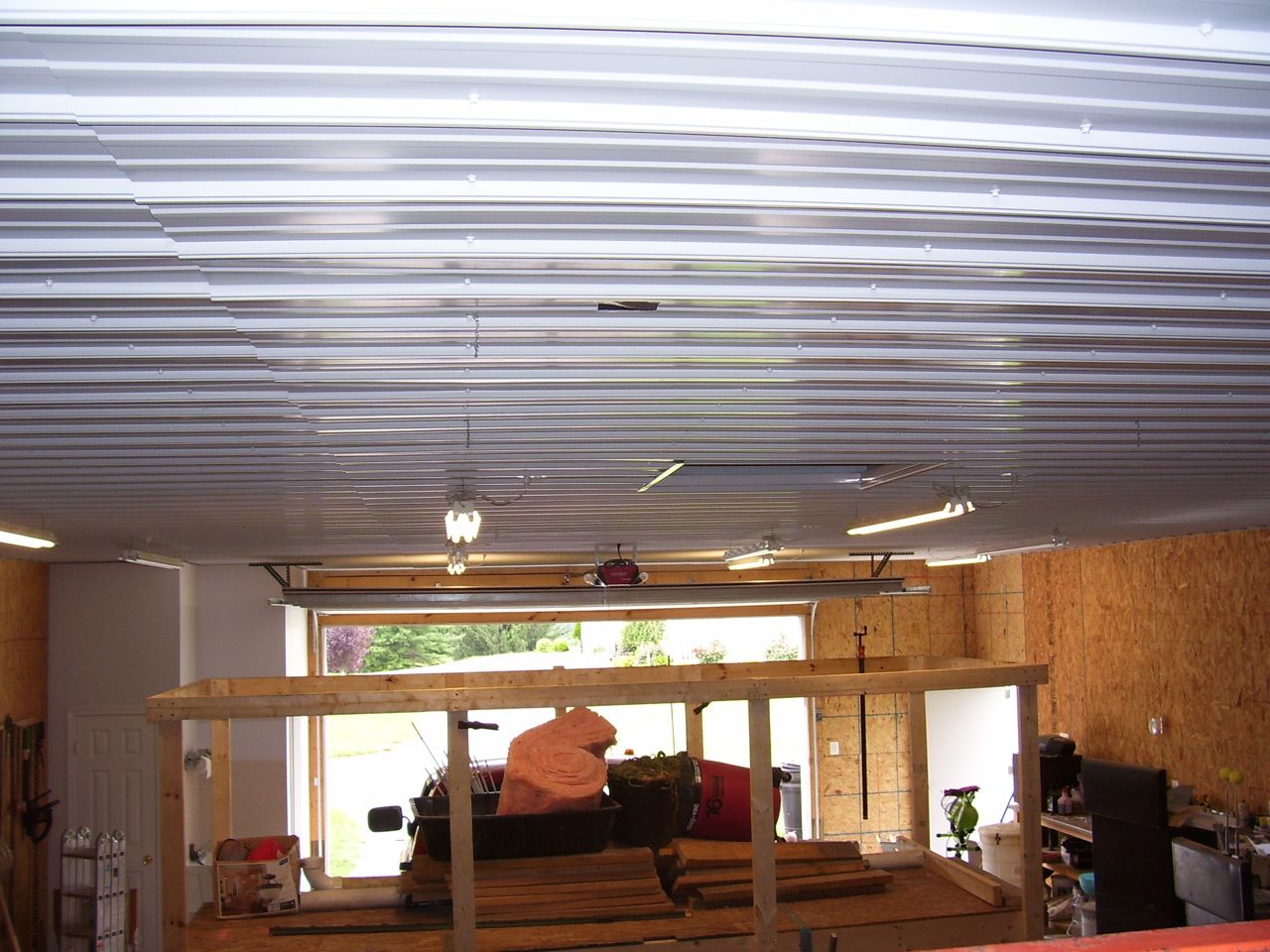

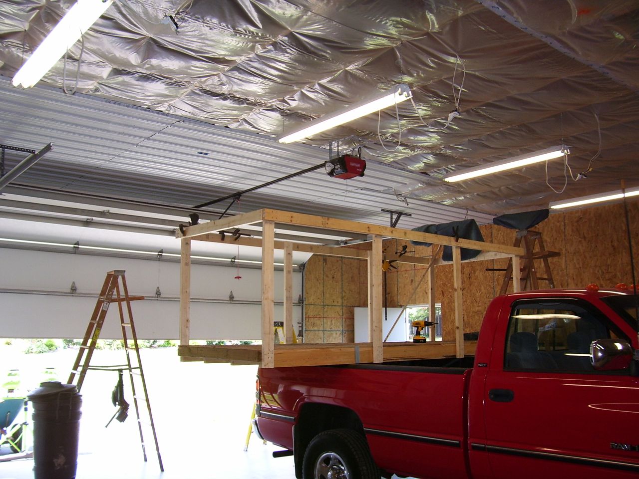

That's pretty slick SRS! yeah that's the way I was thinking of doing it - thanks a lot for your IDEA on a working platform.

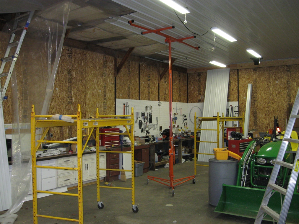

If you get a drywall lift, make sure you get the one with the extension to reach 12' ceilings, if that is how high you're going.
I used mine in my shop, and even in my horse stalls, just put plywood down to roll it on.
Got mine off ebay too, and was like $155.00 w/free shipping out of Florida. Harbor Freight had basically the same lift on sale for $199.00. When done, I sold it on Craigslist for $150.00 within an hour. A win-win for me..!!

Well Eddie the builder told me the trusses would be 24oc I think that to much space between 16oc would be better this way a 3' foot roof panel would cross all trusses.

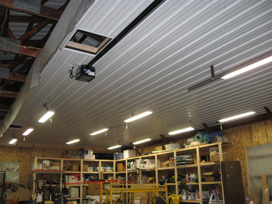

I have a pole barn builder down the road, and he made me a great deal on a trailer load of oddball sheets left over from his projects. They were all different colors but the back side is white, so I turned them over and made a nice ceiling for my 30x50 shop for about $300. I used my coil shingle nailer to put them up, finished the whole thing in about 4 hours.

I am putting steel on my ceiling one 24' section and two 20' sections. It was around 1900 for the steel and J channel. I am using 8' wide white backed fiberglass for the walls. I was doing the interior by myself, but I have help coming this week. The insulation is heavy. The pieces for the 16' walls are probably 80 pounds or so.
