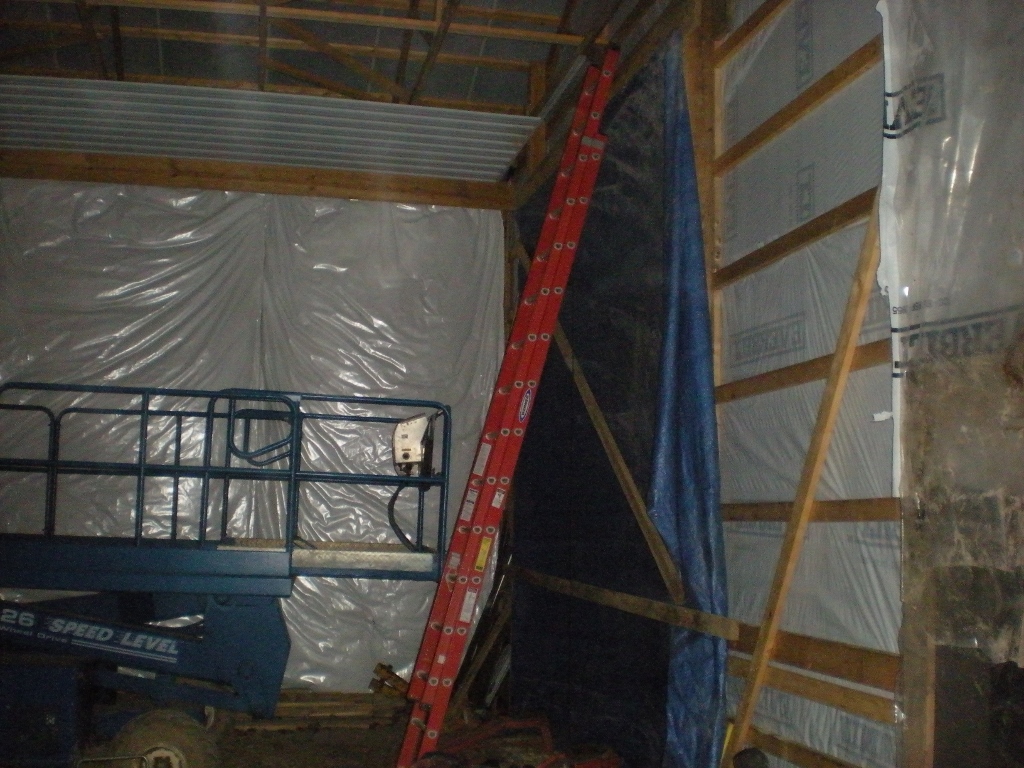

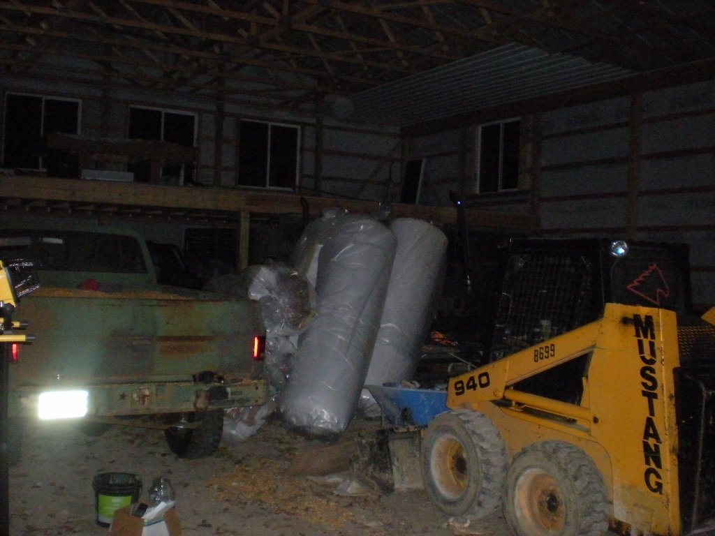

I am putting steel on my ceiling one 24' section and two 20' sections. It was around 1900 for the steel and J channel. I am using 8' wide white backed fiberglass for the walls. I was doing the interior by myself, but I have help coming this week. The insulation is heavy. The pieces for the 16' walls are probably 80 pounds or so.
