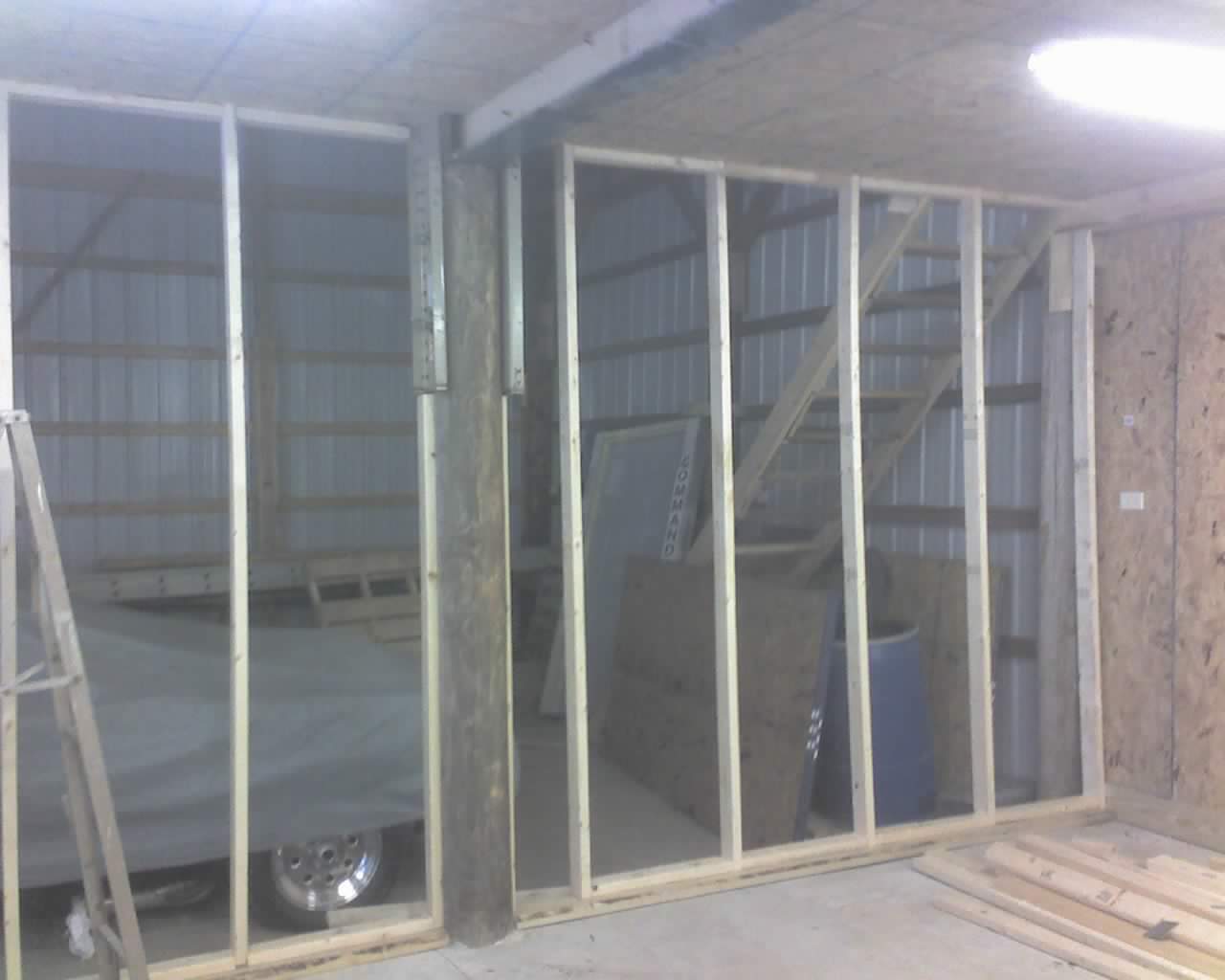

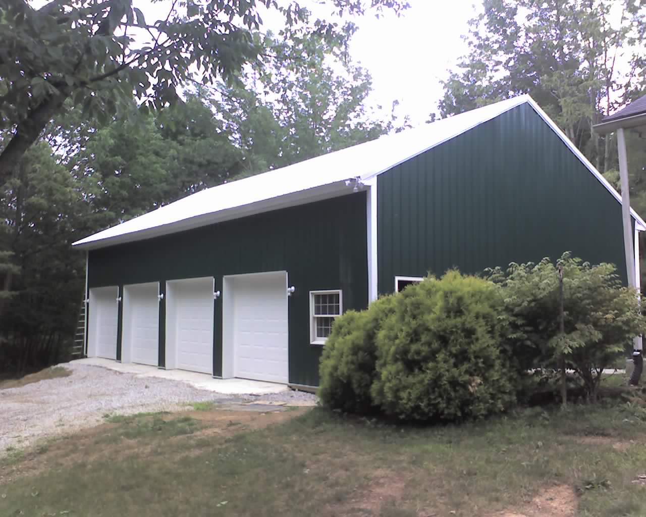

I have about 10-11k in my 30 x 50 to give you an idea.
It has 4 garage doors, 30x30 "loft" with the downstairs to that finished and insulated. Only concrete on that 30x30 as well. Full electricity with 100amp service.
But I built it on a budget and did all the work myself. I rented a break and made the trim, I used electric poles for posts, made my own scissor trusses etc.
Ive attached pics to give you some idea of what 10k got me. The first two garage doors go into the finished and concreted 30x30 section with the upstairs. The last two go into the unfinished/dirt floor/high ceiling section.

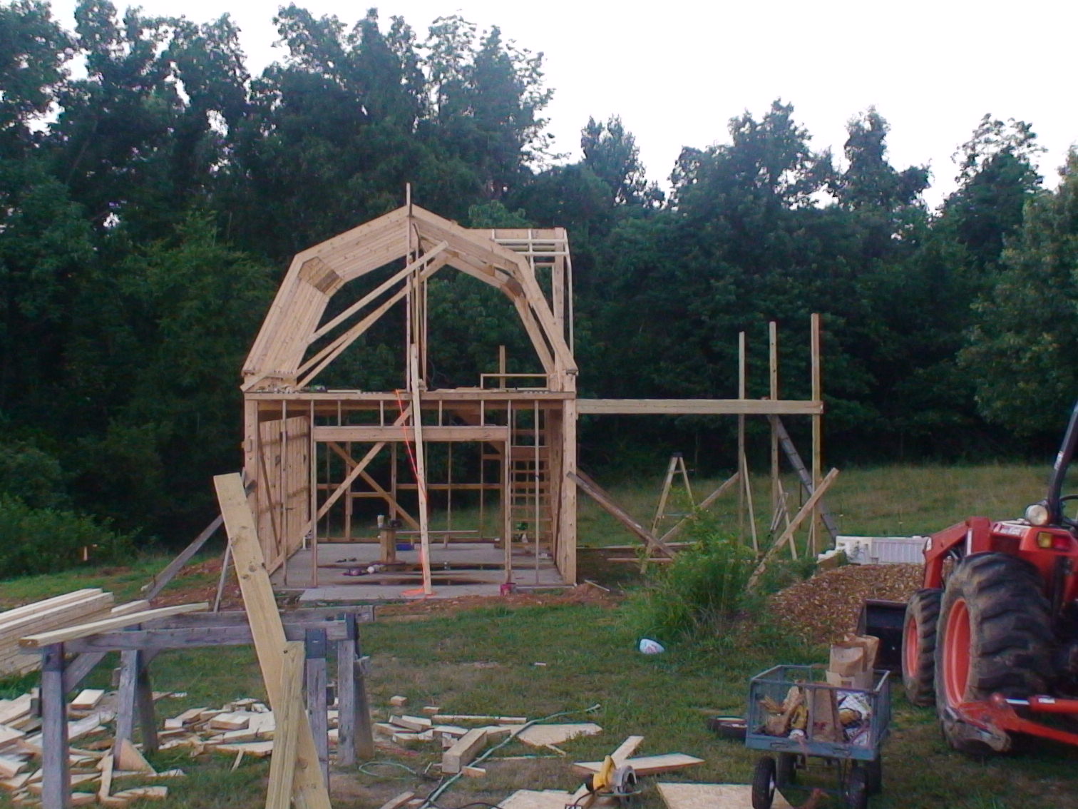

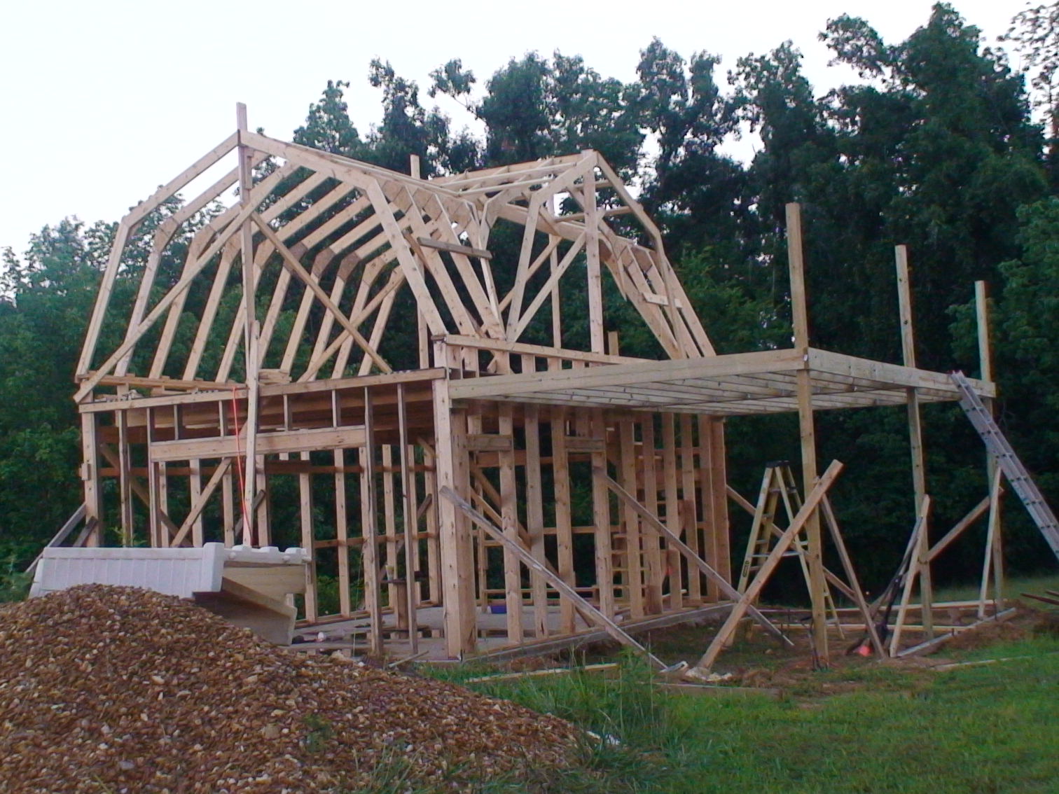

I am building a 16x24 gambrel roof barn with an attached 12x24 deck on the second floor. All of the framing materials, 2 man doors, 4 small windows, a garage door, nails, screws, electrical panel and some odds and ends were about $4,000 - about $1,000 of that was for the deck material. Metal for covering is will be about $2,000. I poured the concrete floor for the 16x24 portion and it ended up being 7.5 yards - about $700.
I really like the gambrel roof - however, I did not use trusses. I used 2x10s for the floor joists and built the 2nd floor, then ran a ridge board down the center of the barn and built the 1/2 gambrel rafters and attached them. The ridge board is temporary supported by 2x4s while framing, but I'll add collar ties later and remove the supports so it will be all open.
This is my first gambrel roof and I have been surprised how easy it actually is to frame. I had to add an intersection to the roof because the walkout for the deck is on the 24' side (parallel to the ridge), so there is a giant (relatively) gambrel dormer on the side of the barn.

rtimgray - Sounds great! I'd love to see some pictures. Might help me a lot. I'm having difficulty arranging the stairs to the loft. I'd like them to be at one end on the 16' wall, but they might pop up into the short side of the loft area. Also, I didn't think about building the loft floor first, then come back and build the rafters to a header. Great idea. I was thinking I'd build the whole rafter units on the ground then get friends to help me set them. I like your idea better. :thumbsup:
I put the stairs in an "L" shape in the corner. I made them pretty narrow (30") and pretty steep, but it's more a utility structure than a luxury structure anyway. I can use the area underneath for storage.
I'm going to take some pictures and I can post them in the next few days. Whenever I build two-story structures, I've always found it easier to put down the second floor and then build on top; then again, I've not used trusses for anything either.
/ Pole Barn Guesstimate? #17
Here's a couple of pictures I took the other day. It has been raining (which we needed anyway), so you can see the couple of low spots in my concrete pad. I had my nephew help me screed it off and that was his first time to work with it...it was a good lesson!
I've made a little for progress since then.
Good luck with your project.
