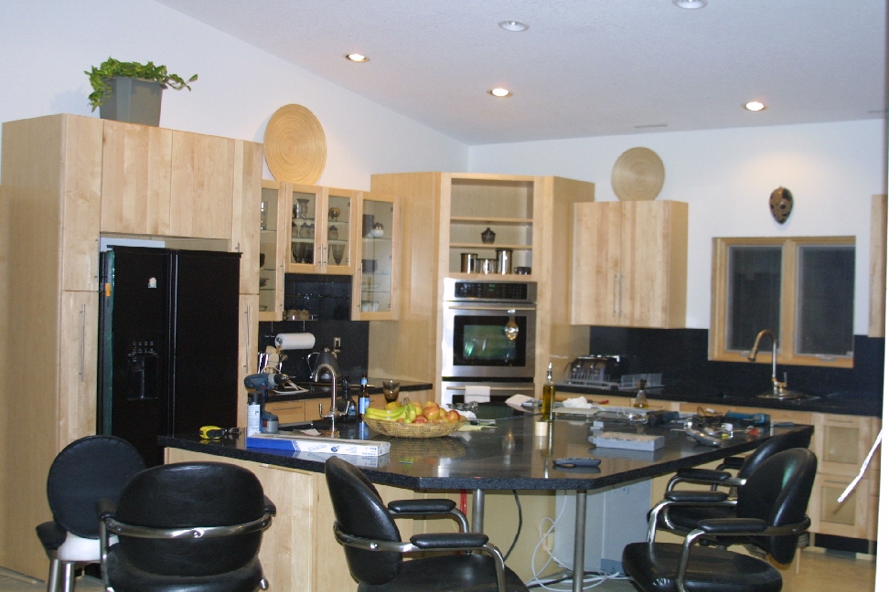

We built our house in 2004. We purchased Morton Buildings barn Morton Buildings - Pole Barns, Horse Barns, Steel Buildings, Metal Buildings, Storage Buildings, Farm Buildings and finished it into a house by ourselves. The biggest issue was financing. We couldn't get a loan. The main issue was lack of comparable houses in surrounding area. At the end we got a loan for about half of the total cost of the property. We ended up owning about half of the property right of the bat but had no cash left to buy in example a tractor. I never calculated the exact cost per sq foot but the number is somewhere between $80 and $90/sq foot. The cost includes, Grasshopper lawnmower, pond and 850 ft long gravel driveway. We put in estimated about 60 to 70K of our own work.
The house is 4300 sq ft under the roof (includes porch), 3800 heated space (includes 1400 sqft garage) by geothermal floor heating.
