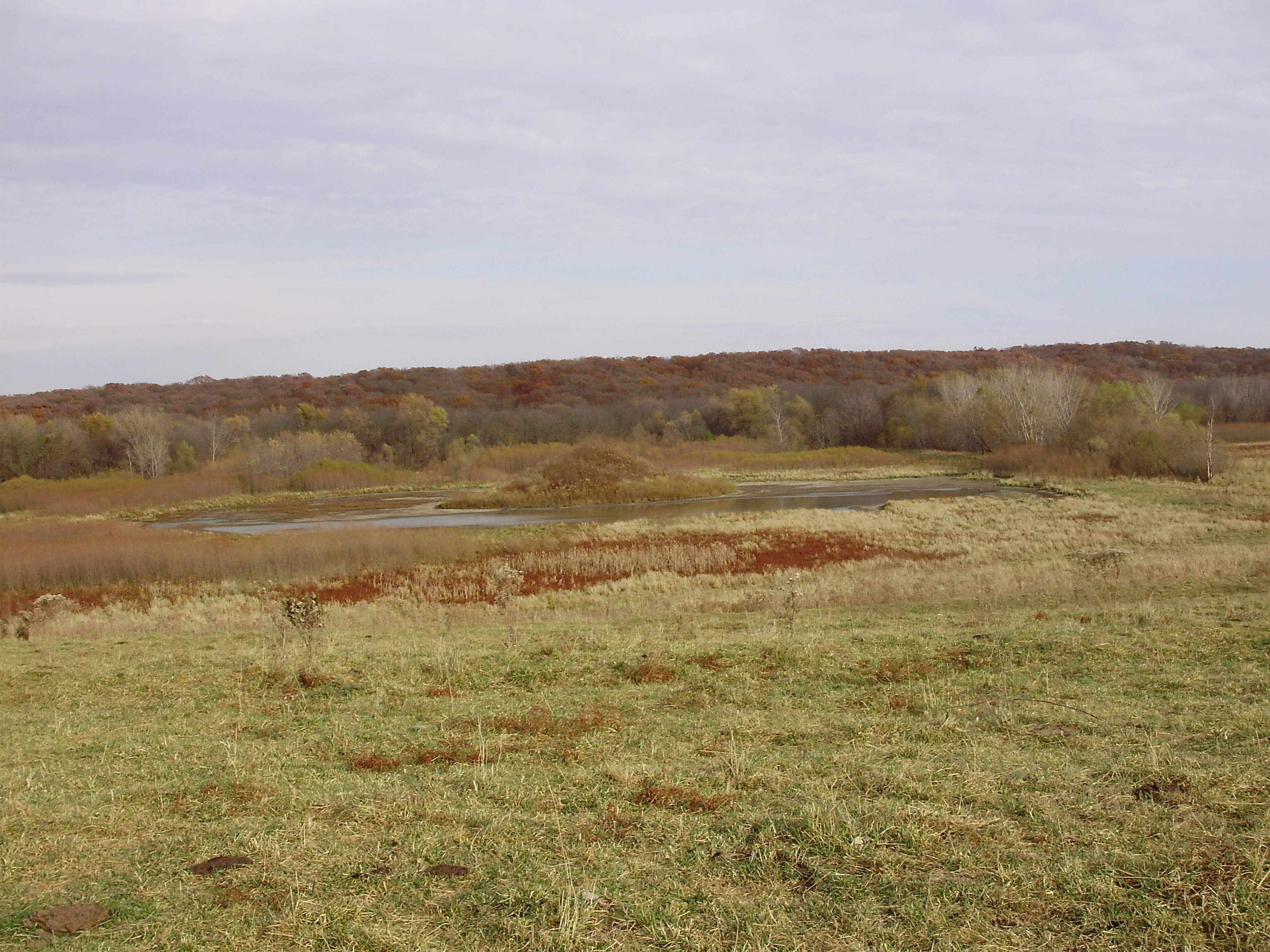

We are building a style of pole barn house that will take advantage of this view of Gander Hill Pond.

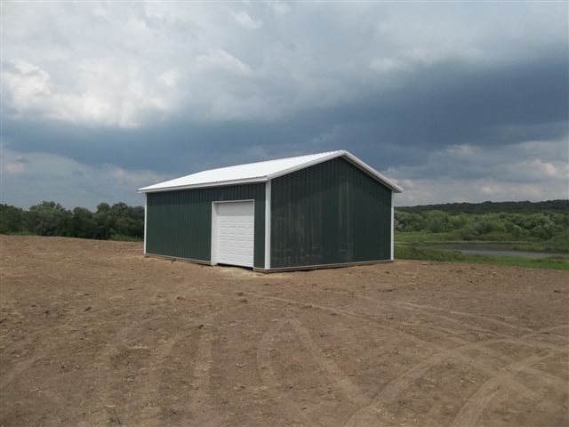

Milligan's Gander Hill Farm The pole barn we built on our farm last summer

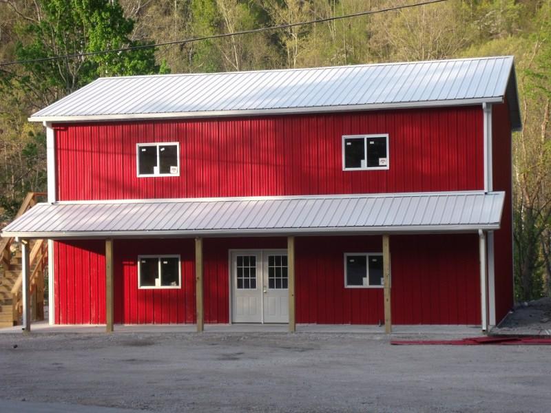

Before I could work on floor plans, window placement, and other aspects of the home we needed to decided what style of pole barn house we wanted to build. We have decided to build a two-story house that will have a front porch, with windows, roof, trim, and doors all in white with green siding. The very same colors like the pole barn I did above, only it will look like the house below.
I got this photo from APB Pole Buildings and have a quote of 17,656.00 for materials to build this one. There are no windows priced in this quote
This is the front view of my house, but will have little different window and door placement then the one above. The front faces true south that will take advantage of the suns rays in the winter being lower in the sky and will shine in the windows and warm the polished brown stained concrete floors that will act as thermal mass and will keep releasing heat even after the sun goes down. The house will be protected by the higher summer sun with the 6 ft front porch for the first floor windows and a two foot overhang for the upper windows. The white roof is supposed to last longer and also help keep it 25% cooler in the summer reflecting most of the sun rays.

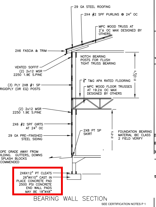

In order to build a two-story house, you do have to have more of a beefed up foundation then just a precast concrete pad in the bottom of your post holes because of the weight of the second story. On a gabled roof house like the one above, the post on the eave side or in this case the front and back side of this house carries the weight of the roof trusses, roof, snow loads, and bigger portion of the weight of the second floor. The front and back will have 6x6 lam post that will be 8' on center. The bottom of the posthole needs a 26 inch wide by 10 inches thick cast in place foundation to help distribute the weight of the structure. The gable ends of the house will not carry as much of the weight of the house, the post foundation only needs to be 18 inches wide by 8 inches thick. The posthole foundation you need for your pole barn will all depend on the style, soil type, frost heave, wind and snow loads for your area.
For the front the posts foundation needs to be poured into place 26 inches wide by 10 inches thick. This diagram call for 8x8 post but I was told by APB pole barns that because I will have a second floor I can get by with the 6x6 post.

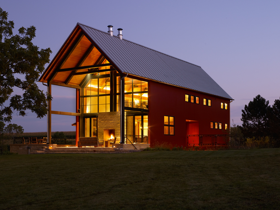

The right side of my house that will face the view of gander hill pond I put at the top this post and will have a 8 foot deep full height gable porch which nothing more than an extended roof line and will be a cheaper version of the picture of the house below that was done by New Energy Works who designs and builds timber frame homes.
New Energy Works designed home

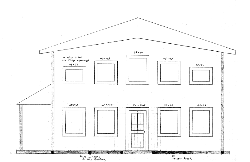

Our home will not look as grand and beautiful as this one, but it will be affordable and take advantage of the views of Gander Hill Pond. Our roof will not be as steep as this one with only a 4/12 or 6 /12 pitch. Our windows will also not go all the way up to the roof line. You can see below of the drawing I did of how this side of our house will look.
Pole barn drawings
I think you can get the general idea how our house will look and the next post will be on the floor plans. Don't forget if you want to follow our progress on our pole barn house click on the link at the bottom of this page to go to my blog.
