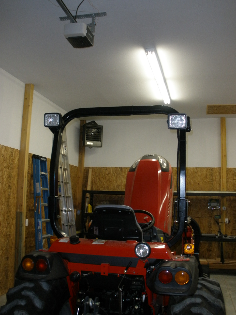

I used a combination of drywall and OSB. My walls are 12 feet so the top 4 feet is drywall, painted and the lower 8 foot is OSB. Not too bad lighting for working the florescent fixtures help.
