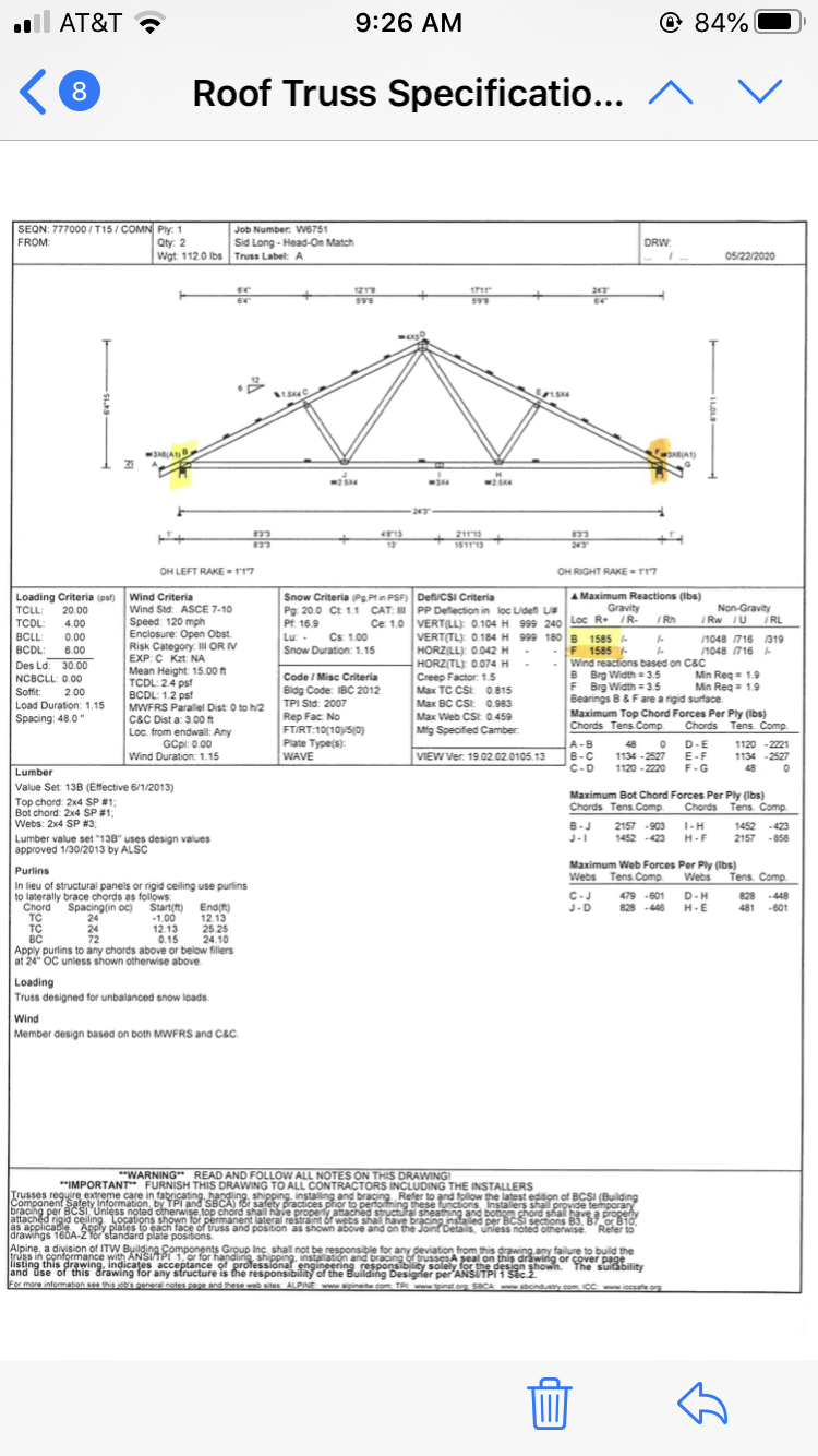

To size your beam, you need to determine the roof load. The lightest that it typically used is 20 lb/sq ft and that assumes a metal roof and no snow load. If your building is 24 feet deep, you would have 240 lbs per linear foot at the beam. Although you have trusses, you can probably assume uniform loading on the beam.
Using the formula W=8fS/l, you need to determine the required S (section modulus) for the beam. Just grabbing typical numbers, assume the steel fiber stress is 20,000 psi. W, the load, for your 22 foot span is 22 x 240 or 5280 lbs. The span is 22 x 12 = 264 inches. The required S is then about 8.7 in**3. Looking at my old beam tables a 6 inch standard weight beam (17.25 lb per foot) has S=8.7. The more common 6 inch lightweight beam (12.5 lb per foot) is S=7.3.
This is pretty minimal design and assumes a very light roof. If I were doing this, I would probably look for an 8 inch lightweight beam and add the posts as recommended above to bring the span down to 18 feet.
All of this is a 10 minute handbook job, so it's your building and your responsibility.

Here痴 the build sheet on my trusses which has the roof load.

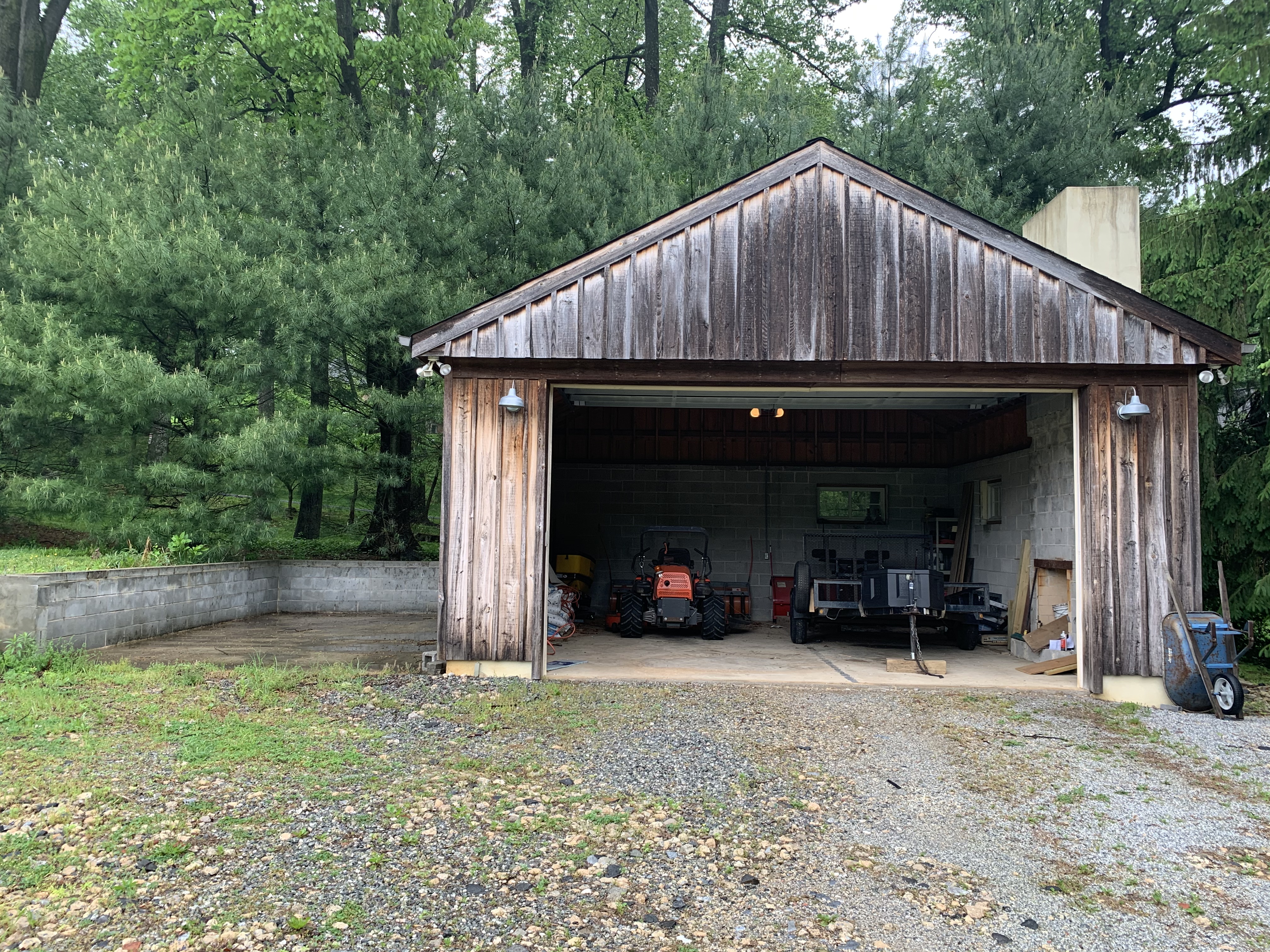

My small barn has an 18 foot clear span opening and I admit, I do like it. The first picture shows my 18 foot wide x 10 foot high opening. 2nd picture shows the size of the Paralam I used. And thats a non load bearing front wall! That just keeps the opening from sagging!
I set that puppy with my new holland backhoe and pallet forks. It was about 25 feet long.
