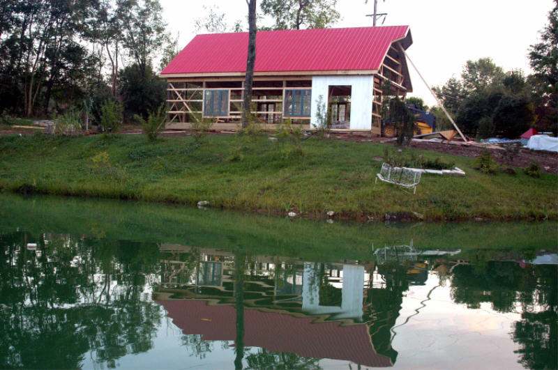

Here's a picture of a 24'x40' pole barn we've got going up (construction started last Monday). The poles are set on two bags of quikcrete emptied into each hole dry. The building has attic trusses and will have inside stairs, sliding doors on each end and a man door (Dutch door--longtime spousal fantasy /w3tcompact/icons/wink.gif). There will be a concrete floor. We opted for pole construction rather than stick-built to minimize impact on the couple of nearby trees; I also like the way pole construction looks inside. The windows are a little strange for a barn, but we've had 'em for years and figured we might as well use 'em.

I will see about scanning some in the next few days.
Scott
