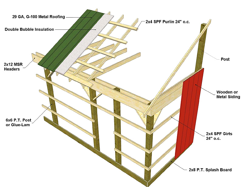

A purlin sits on top of the rafter/truss and runs perpendicular (parallel to the ridge). If you have rafters 2' on center and sheathing, you don't use them, but if you have a metal roof, you don't need the sheathing so you need something else to fasten to. If the rafters/trusses are too far apart to use 1x or 2x on the flat, you can stand them on edge to make them stiffer. There are several ways to use them. Most common is simply on top of the rafters, notched and inset was used a lot in the old post-and-beam, or hung off the sides of the rafters with hangers which is what these guys are talking about. While you can't use longer stock and span several trusses that way, it does mean the roof is closer to the trusses so it makes a little better use of the internal space, especially if you have a loft or attic.
Or if you prefer, sort of like a girt except on the roof instead of the wall.

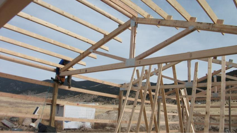

You may be right on the percentages, won't dispute that. But the only ones I can think of where they've used 8' spaced trusses here in Michigan are very large buildings (160'-200' long) where the trusses span 60-80 ft and are therefore pricey. I'm going to check one tonite but I think they rest on the headers there. I've also attached a picture that is typical of pole barn designs I've seen. I'm building a barn addition right now with the rafters sitting on headers, per code.
And for a 50' long building you'd need 14 trusses 4' OC. For 8' OC you'd only need 7. Not much savings in my mind, probably less than $1000. And resting them on the headers means I don't care if the post spacing is not EXACT. Heck, my line posts can be off a couple of inches and my headers and girts will compensate for that. How many of you have set 16' long posts in the ground and got the tops to be precisely where you want them and then not move during construction? Sure, it can be done but it's a lot faster and easier to set them without worrying about that. And if you're sheathing the roof, it IS important when installing the trusses that you get a perfectly square roof . Using purlins you can be off some on the spacing or even squareness as long as your corner posts are perfect.

Are you saying code says they have to set on a header? Because I can set them on the post per code.
I just ordered 40' trusses @ $240 a piece for 8' spacing. Not only will the truss set be cheaper you will not need the header material, and labor to install.
As far as wild spacing it doesn't make any difference this way either when you set the purlins on top of the trusses. But then I don't find it the least bit difficult to get the trusses spaced accurately.
