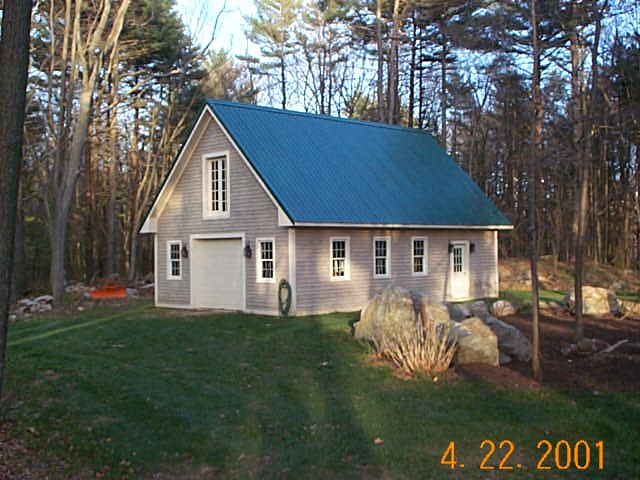

tgello,
I'm late to the post here, having read the other replies, just one thing to offer if you are considering stick built as well, as I found the pricing to be very close to pole barns here.
In monolithic slab construction in NH the codes require a "haunch" which is essentially a 18" deep x 24" wide perimeter with #4 rebar in an upside down J tied every 24" into 4" square 8 gauge wire mesh in the center of the pad.
This is after site prep of course with bank run gravel (1/2" stone with sandy mix) compacted all around 3-5" deep.
In addition, 6 mil poly is recommended to prevent moisture penetration and sweating in the summer, and if heating the bldg 1" or so insulation is optional on the sides and floor before rebar setup.
The footers/framing are 2x12's around the exterior set to the finished height you want (typically 4-6" above final grade)
The pour is 3000# concrete mix, and for a 24x36 building was around 20 yards - $2600 complete with footer framing, rebar, mesh and finish, including the cutting every 12' for expansion/crack prevention. We then framed on top of this with a base of 2 PT 2x6 then std frame up from there.
So far two bldgs done this way (26x42' Garage/Office and 24x36 Barn) are holding up well.
Carl
This is
   / pole barn #26
Carl, very nice.
Do you have cost figure for the one in the picture?
PJ
   / pole barn #27
PJ,
$12K materials, $12K labor $2,600 concrete. Includes 18"x24' floor trusses so no interior posts, stairs to second floor, cedar siding, windows and 2 Insl. 9'x8' doors.
It could be done for about $6K less on materials, and probably $3-4K on labor, if you just want T-111 siding, no second floor and homemade sliding doors etc..
I have a materials list in excel if you're interested email me.
Carl
   / pole barn #28
That price is not bad considering what you have. I plan on looking around my home area for pole barn builders and see what kind of bid I can get. I really like your two story concept.
The use will be to store tractor and equipment from the elements, inside repair work and in general keep everything tidy.
PJ

   / pole barn #30
PJ,
Forgot to mention a few facts that made my decision.
1. We have ledge and getting 10-12 posts deep enough for a pole barn was one issue.
2. Price quoted for pole barn complete with same features compared to this stick built was $28K - I provide the holes was the only element, and question.
It needed to match the house and garage, siding, windows etc per my significant other. Only deviation was she said "true mullion windows" like the house, and we had several engaging discussions, and at the end of the day she gave in, based on the cost.
Carl
