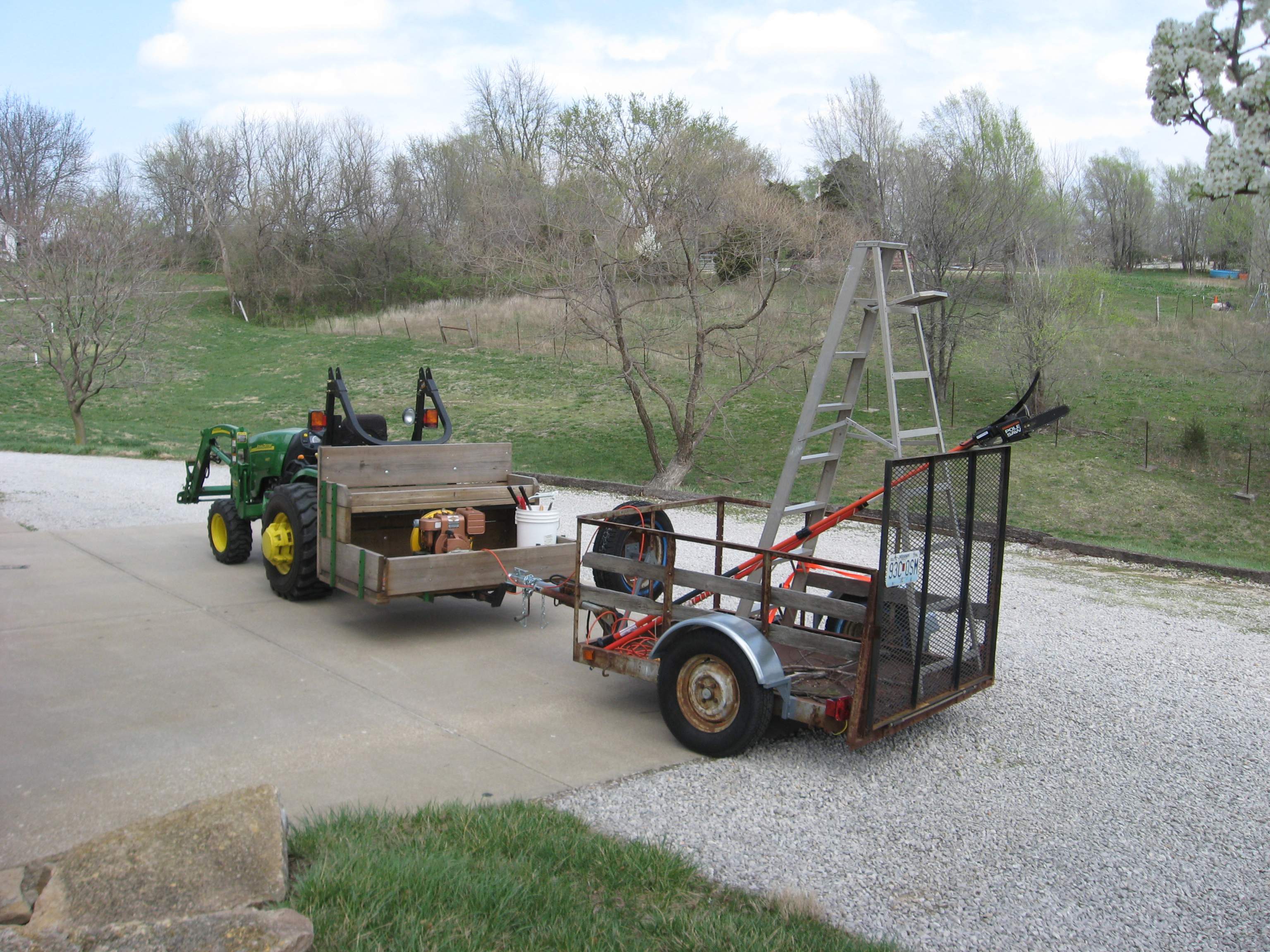

I use a combination of methods described by others. Never have bought a gas pole saw, but have a cheap Remintgon electric and a manual. I throw my generator in the carryall, hang the trailer on the back of that, put an 8 foot stepladder in the trailer. One day, I would like to have a gas pole saw, but for now, this works. IMG_3983.jpg
