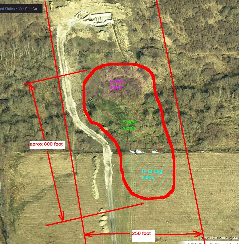

Hello All, Name is Nate. Looking for some help. Followed EddieWalker's post of "creating a lake" pretty hard and was hoping to get some of that awesome advice about my project.
Looking to build a 2-3 acre pond for wildlife and swimming in front of my home just outside buffalo NY. The deeper the better for vegetation control.
Lot size out front is the issue, only 250 feet wide and that includes a driveway and septic line. The sand filter discharge is pushed all the way to the lot line so it wouldn't leach to the pond. The entire lot runs downhill at about a 5-8 degree slope. House is set back 2000 feet so I have plenty of room in that direction.
Guess where I struggle the most is with the level control, diverting water when building and the overflow. I will hit a spring I know it, lots of shale under me, build the house on a spring. My house drain tiles gravity flow about 2-3 gpm all year round down towards the pond. That any springs i hit and the future gutter drains should be plenty for filling and sustaining? Yes/no? Being all downhill and narrow the level control and overflow will have to be in the end where the dike is the highest. That scares me. Not sure I can do a slightly pitched natural emergency overflow. Draining the pond is a must someday to control weeds. I can't picture how to build a level control through a dike. Not sure it would be a good idea to trench through a dike and can't picture building the dike with the pipes already in the ground. Any ideas? Any advice? Any thoughts for diverting spring water out of the hole during the work? Team of trash pumps is my only idea.

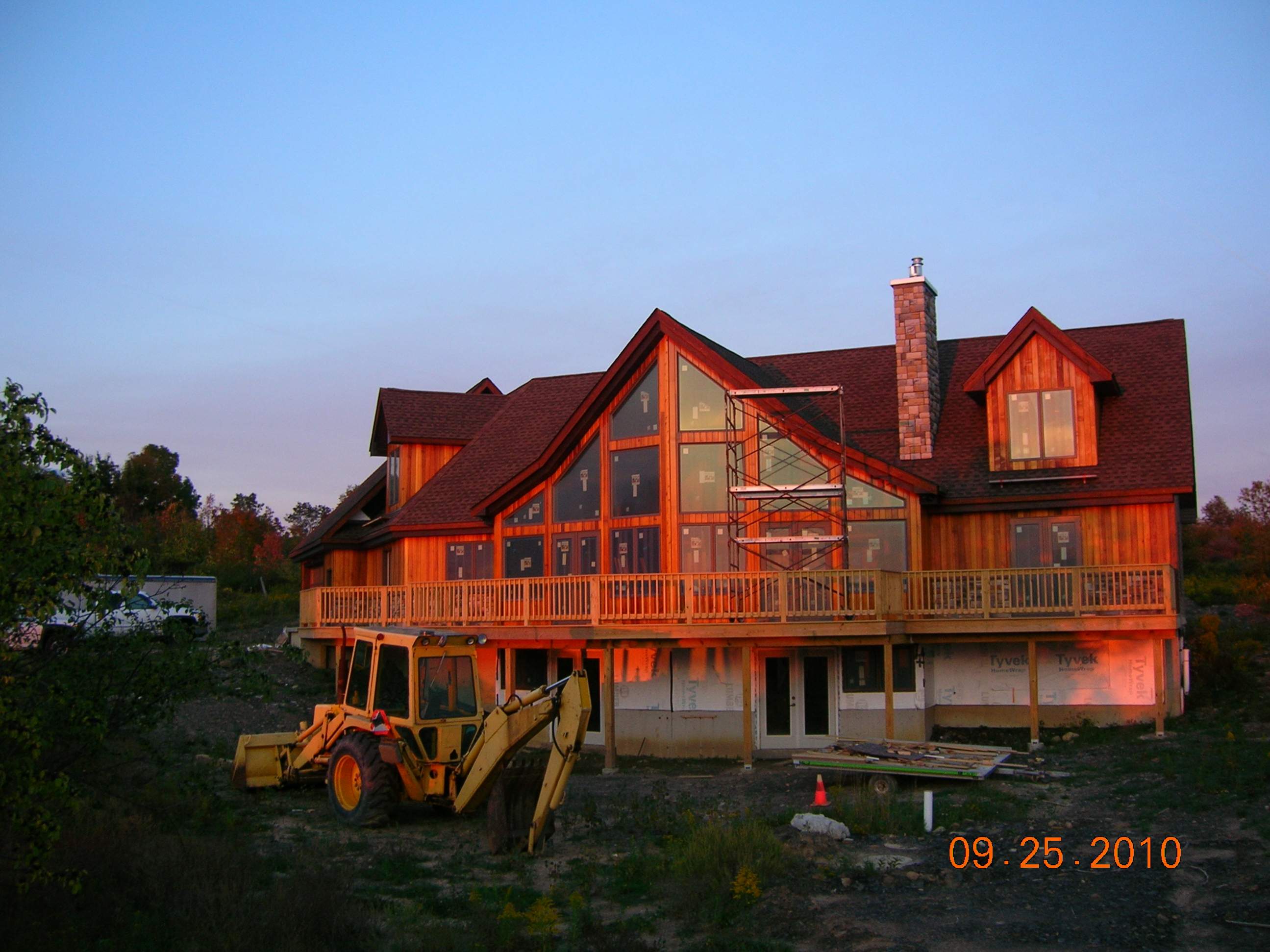

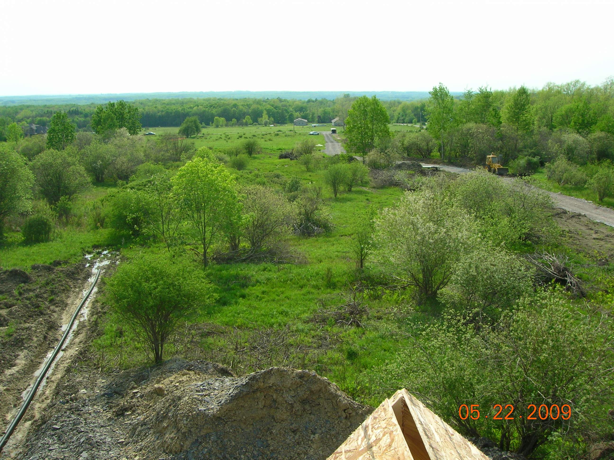

I will post a few pictures of the pond outline i would like and the lot.

Nate,
Give a call to the state's dam safety office. If they can't help you I bet they'll have suggestions for folks who may be able to, like the Natural Resources Conservation Service (part of the US Dept. of Agriculture) or the county cooperative extension. They may even suggest that you talk with an engineering consultant with experience in designing dams.
The dam that you propose must be able to hold water when you want it and get rid of it when you don't. There should be some sort of spillway to discharge water when the pond is as full as you want it to be as well as a drain to allow for you to do work on the dam in the future or to control weeds, etc...The spillway can simply be a section of natural ground (not placed fill) off to the side of the dam that is sufficiently lower than the top of the dam to evacuate water without letting it get too high and endangering the dam. It should also be able to withstand the forces of flowing water so that it doesn't continually wash out.
Most smaller dams like these are designed to pass the runoff generated by a "50 year storm" and still have about another foot of vertical space left before the dam is overtopped. That is a rainfall event that has a 2% chance of occurring in any given year. In NH this equates to about 6 inches or rain over a period of 24 hours. This may sound like a lot, but we've had such storms or worse here a couple of times in the last 6 years or so.
The pond drain can be as simple as a pipe laid through the dam at its base with a plug on the end that extends into the pond. You can attach a chain to the plug so that you can fish it up to the surface and pull it out when needed. The fill that you use to build the dam should be able to hold water and be well compacted as you raise the dam. Compacting the soil diligently around the pond's drain pipe (or other structures that are built into the embankment) should be sufficient to prevent leaks. When the dam is done it should be level along the top (except for the spillway) with smooth and even slopes - all of which are protected with a hearty grass cover that will keep the soil from washing away from surface runoff.
Building the dam isn't hard, provided that you've incorporated the features necessary to meet your goals and the quality control during construction is tight. Again, I'd suggest that you find someone locally that can provide you with insight and ideas.

have alot of room behind the house if i need to stock pile fill, that doesn't worry me to much.
good question about the clay... how would you ever figure that out untill you get into it?
i have dug a few test holes, maybe 12-14 foot deep. The up hill side of the pond you hit shale after only 5-6 feet. The down hill end i never hit shale only chunks of lime stone.
There are alot of ponds around me (attached) got to assume that would hit what i need to keep water in it...
