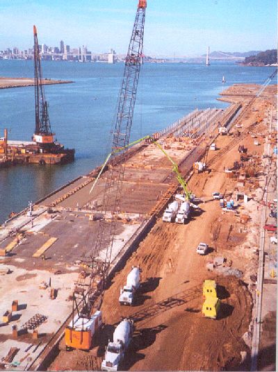

I've never done anything at this level:eek:, so I can't be of much help to you on this project. But I use to build docks for a living. If you ever want to build one like these, I'm willing to help all I can. I've been the project superintendent on docks up to 80-million dollars.

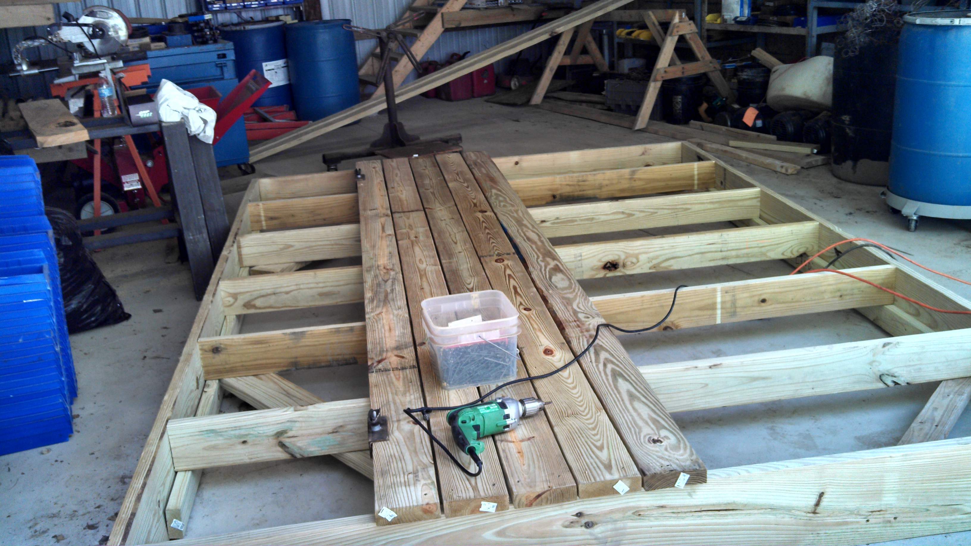

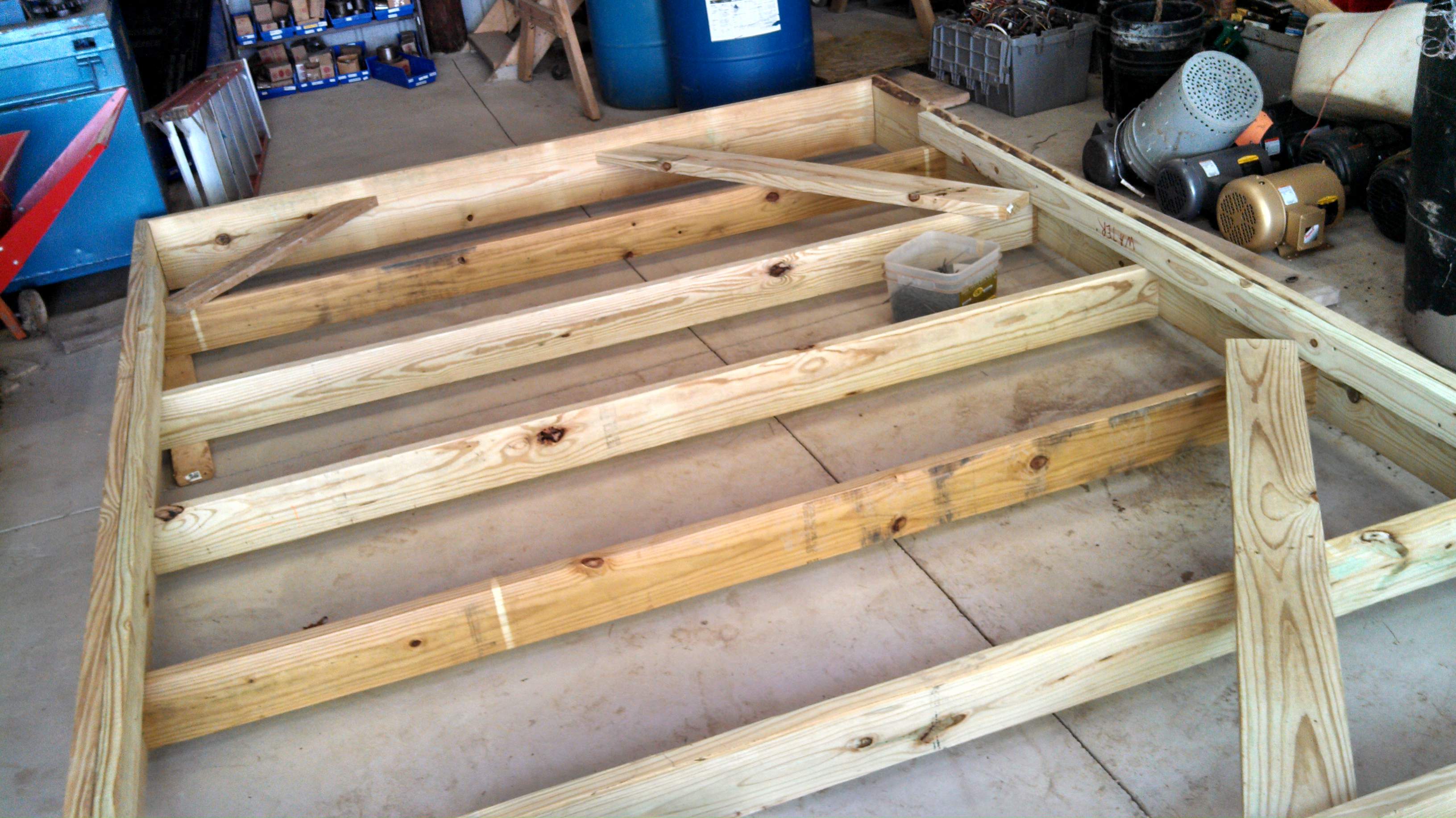

No plans for posts sticking up. Just want a flat dock. Easier to get on and off of when swimming and when we eventually get a paddle boat.
No hangers either. Im old fashion. There is a 2x4 under the joists. It aint going anywhere. I also did 45 the corners with some other scraps I had. 2' peices wasnt quite long enough. With joists at 2' spacing, I at least wanted to reach the first one with the 45, which required a 36" or so piece.
Here is some progress pics. Probably wont post any more pics til I get it up friday. Only thing left to do until then is attach a few more deck boards.
First two is the frame before I flipped it over to do the decking..
IMG_20130813_135449_534.jpgIMG_20130813_135457_637.jpgIMG_20130813_142450_163.jpgIMG_20130813_142507_189.jpg

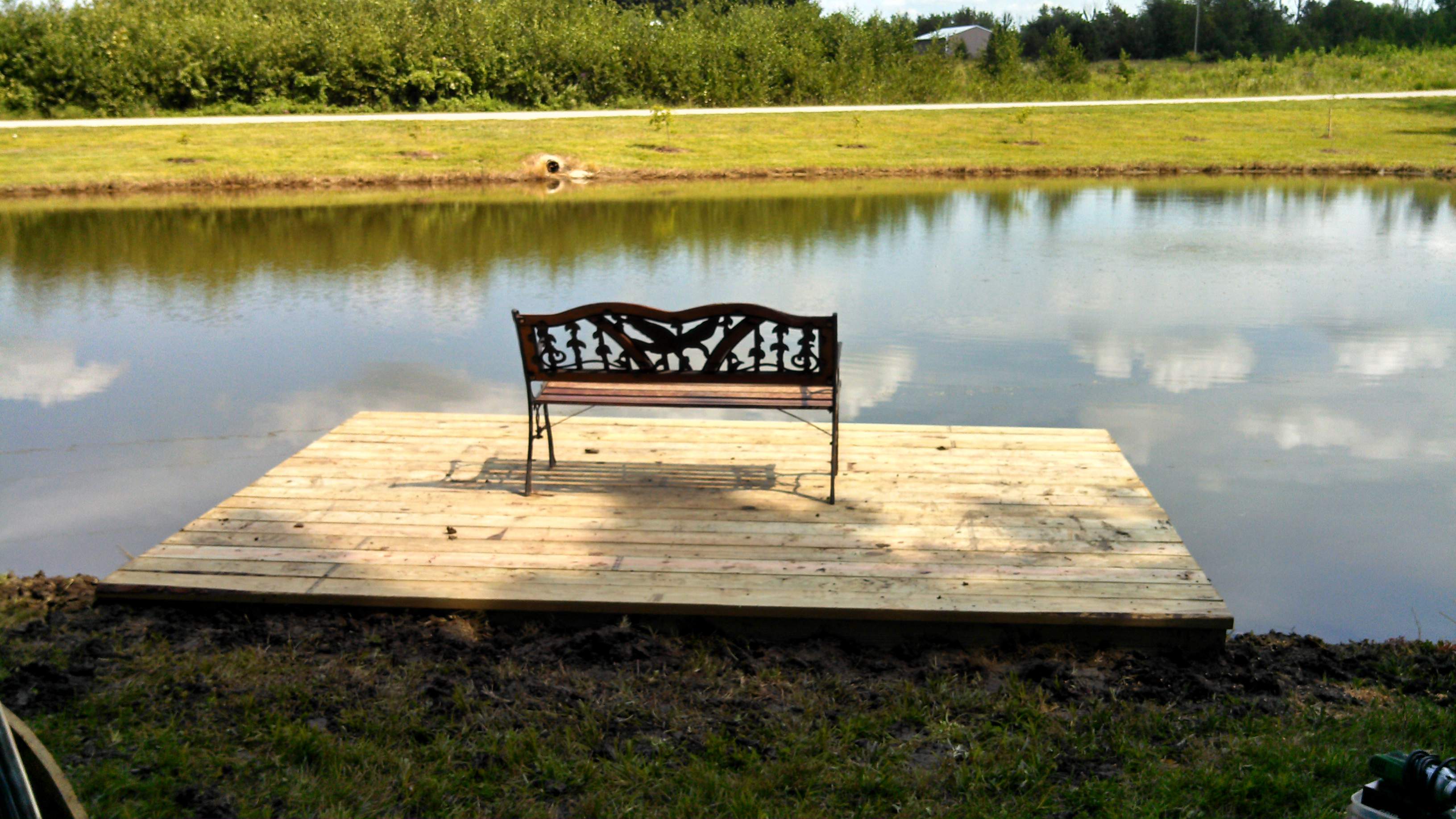

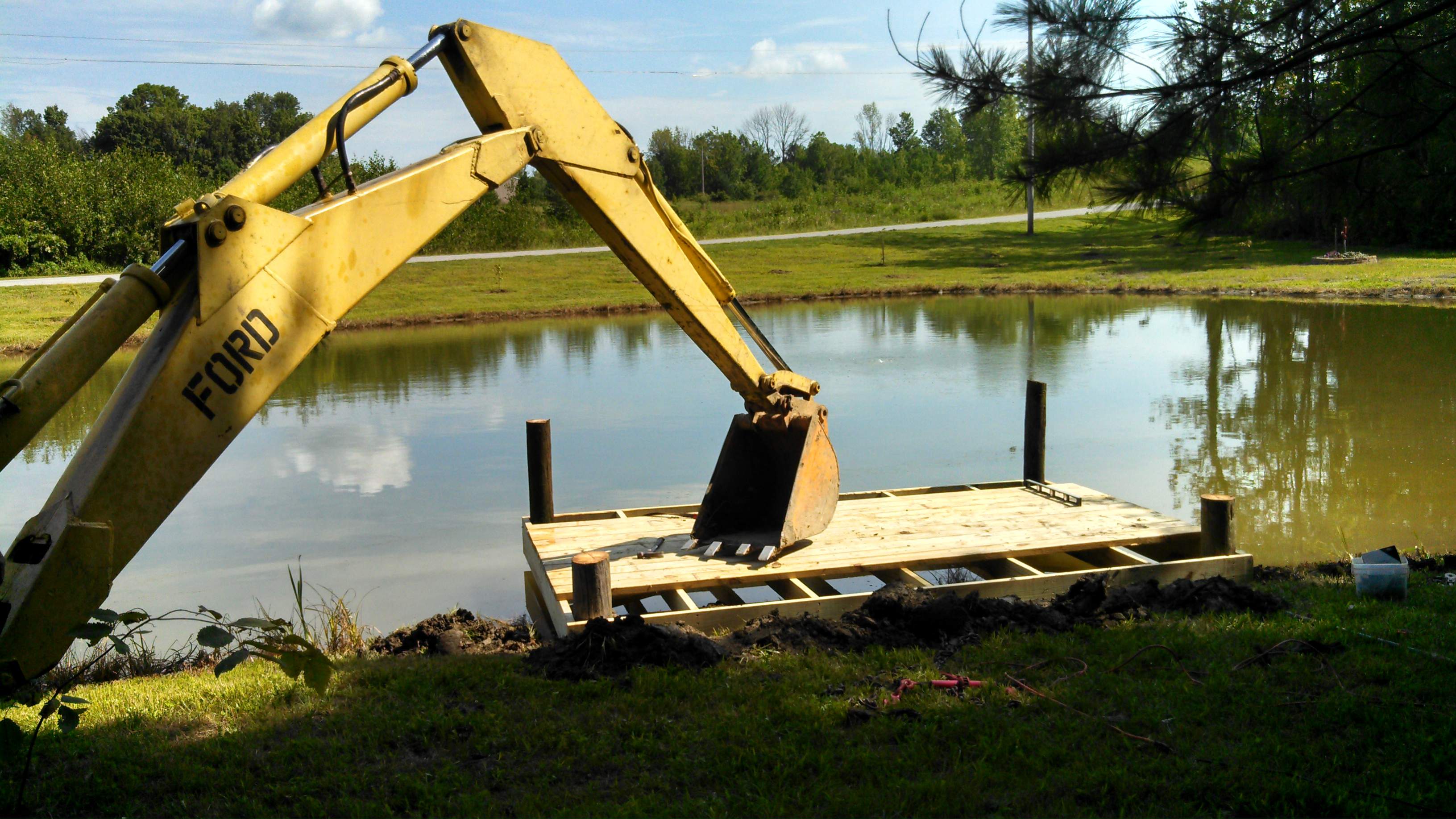

Well, here it is
They (dad and FIL) had already removed the straps and chains before I could snap a picture. But thats how we set it.
Took about 2 hours to do with the 3 of us. And a total cost of $325 in material.
