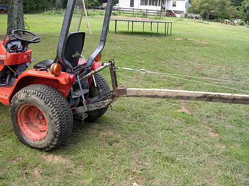

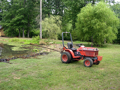

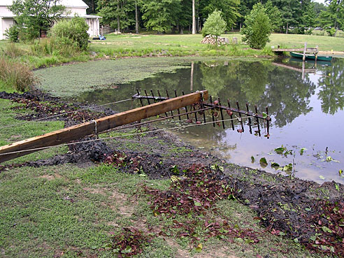

Lot of weed is growing in our pond, Watershield and according to my sources, the only way to deal with it is chemical or mechanical.
I do not use chemicals unless I absolutely have to, and mechanical is a lot of work. I used to comb it out with very simple rake on a rope pulled by a lawn tractor - but it requires one person to walk the rake in the water and mud, never liked doing that.

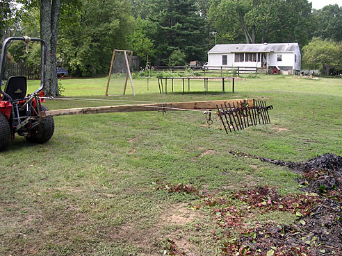

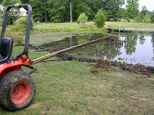

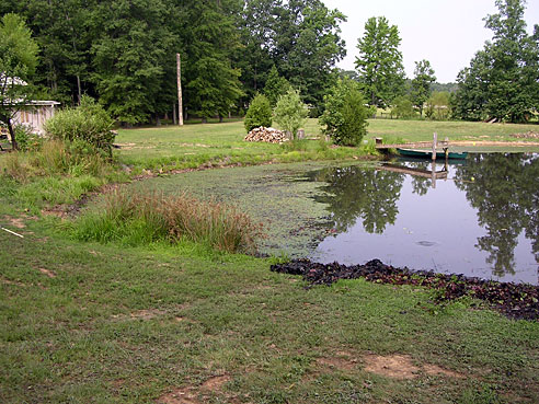

In last few weeks I built this prototype of a pond rake - using my old rake made from bed frame and rebar, one ten feet long 2x4 and very simple 3pt hookup. It works fairly well in spots where he bank is not too steep, typically first pull gets the weed and second pull the gunk from the bottom (leaves and mud).
On one of those first pulls I got out 2 feet snapper :) tangled in weed.
The hitch is made from metal I had left over from other projects, there is a pocket the 2x4 fits right in. The rake itself is U bolted to the stud and two steel lines hold the rake in diagonals and in the pocket. Of course I can change the angle of the rake with the 3pt top link.
For next season I am going to rework it and use tines from landscape rake, because they will give me better angle of raking, spaced 3 inches apart and the rake itself only 2 or 3 feet wide. The 2x4 is also a weak point, I already cracked this one, but now when I know it works, I can build it to last.

Thanks for posting this. I've been trying chemicals and not making much headway with my watershield. I think I'm going to take ideas from both czechsonofagun and MrJimi. I have a short 3pt pole lift that I plan to use as the base. I'll add a 2" reciever. I'm thinking about starting with a 10' 2x2x1/8 tube. I'll add a rake head of some design. I'd like to use something that I can also attach to the bottom of my BH bucket, so I can rake in tight quarters - like on the dam.
You both seem to favor small rakes. I was thinking large, for speed of work. Does the shorter rake work better?
Thanks

Good question, but i don't know:) My pond is only half an acre, I think the rake is now 4 feet wide, I dont think I am gonna built it wider than that. But I would like to go to 12 or even 16 feet length to reach further.
Also somebody told me to use a chain to drag the bottom to get the weed out - I didn't try that one yet.
