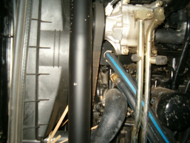

If I didn't have a block heater, I would directly route the return hose into the engine block on the left. There is a block plug there for the block heater. Unscrew the block plug and put in a fitting for a 5/8" heater hose. I could just remove my block heater and go this route. This would be and easy and hopefully quick fix.
2nd try to find a fitting to fit the opening where the oil filter cooler return water line goes into the water pump. Probably a "T" fitting to allow both the heater return hose and oil filter cooler line to both come into the same port on the water pump. I don't know if such a fitting exists or if there is enough room next to the engine/water pump.
3rd attempt would be to connect the return heater hose closer to the water pump on the radiator hose. The existing fitting could be moved about 6-8" closer to the water pump and thus further from the radiator. NAPA also has a heater hose fitting that can be directly placed into the radiator hose and mount this closer to the water pump - hopefully with in a few inches of the water pump.
4th try would be try to find a temp controlled fan blade clutch. This would require trial and error to find a part that would fit, more labor and cost.
Currently, I am using a vise grip clamped to the return heater hose to shut off the flow. Run the tractor for 10-20 minutes and remove the vise grip. Once everything is warmed up and the thermostat opens to heat the radiator water, I seem able to maintain the heat with the hotter thermostat. However, this works if the temps are in the 20's-30's and may not work if it gets really cold. I haven't tried this with temps below 25.
