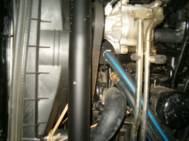

Tomorrow, I am going to do my own trouble shooting. I am going to drain the antifreeze (this is about the 5th time), and remove the return heater hose from the lower radiator hose "T" fitting. Splice on a longer hose and reroute it into the left side of the engine block where my engine plug heater is located. I bought a 1" to 3/4" pipe thread adapter to fit into the engine block and then will screw in a 3/4" pipe to 5/8" hose connector. Replace the antifreeze and see if that fixes the problem. I'll post the results of my readings with infrared temp gun.

I still think it is related to engine not getting hot enough. Is the fan the only thing run off of the fan belt? Loosen belt so it doesn't cool as effectively as it would with a tight belt. Take it out and work it, see if temp comes up, comes up quicker, no change. If it was mine, I would even be tempted to turn fan around (so it would blow through radiator) to decrease air moving over block, and see if that made a difference. If A(you get water hot, and B(water is circulating through heater, then C(cab should heat up.

I see where your coming from, but the engine just doesn't get hot unless it is under moderate load. Then the engine gets hot, and I have all the hot air I want coming out of the heater. It is difficult to imagine that there is so much air movement over the heater core, that it can keep the engine from heating up.
