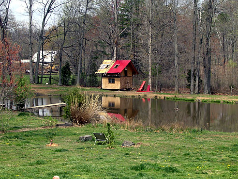

Hijack what you want :)
I used metal roofing on the tree house - it was challenging :)
Probably the same stuff you are planning on using - MasterRib from Culpepper/Marshall Coop - i think MR supplies the whole Virginia.

That is an awesome picture Prokop!
How did you get off the roof!
David
The window helped some but I had a rope from the tree to hold to and for other places ladder with hook for the ridge. Day work on a ridge like this felt like giving birth :D
