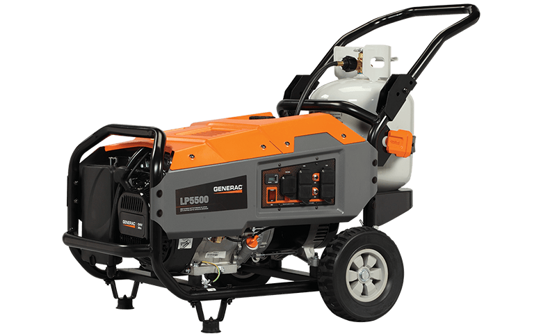

10,000 watt and they show it hooked up to a 20# tank. I'd bet it huffs down 20# pretty fast.
That won't work in cold temps. The tanks get so cold the pressure drops below what is required. They recommend two 20's for a Honda EU2000i and they use way less fuel.
We have two 100 gallon tanks for our 14kw system. I run the Hondas on gas for portability and ease od refueling.

Another benefit of running LP is that you don't have to change oil as often, since it doesn't get a dirty as it does with gasoline.
A LP dual fuel conversion kit runs right about $200 and takes less than an hour to install.
