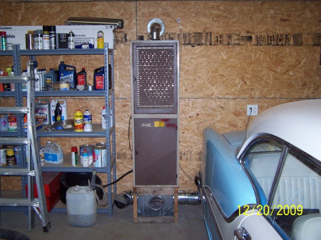

Just a thought and not really portable but it would definitely heat the cabin.
If you have a local mobile home dealer or guy who services mobile home furnaces perhaps you could get a used furnace from them. I just picked one up for heating my 1100 sq. ft. of garage. I have less than $300 in it including the flue pipe. It is an 80,000 BTU furnace and I run it on kerosene. Only thing is you have to make a hole in the wall for the flue pipe to go out and another for a fuel line.
I suppose you could remove an upper window pane to pipe the exhaust out then you wouldn't have to make it permanent. Mine is just sitting on the floor, plugged into 110V, 5 gallon kerosene sitting next to it for fuel, I did have to make one hole through the wall for flue pipe.
Monitor heaters are also available but much more than your budget. Maybe you can just get by with a couple of new 20,000 BTU kerosene heaters since the old one died.
