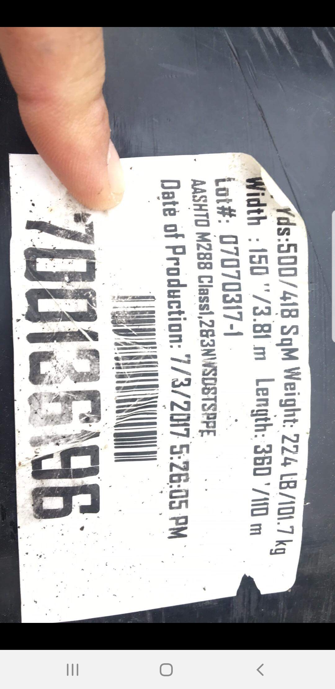

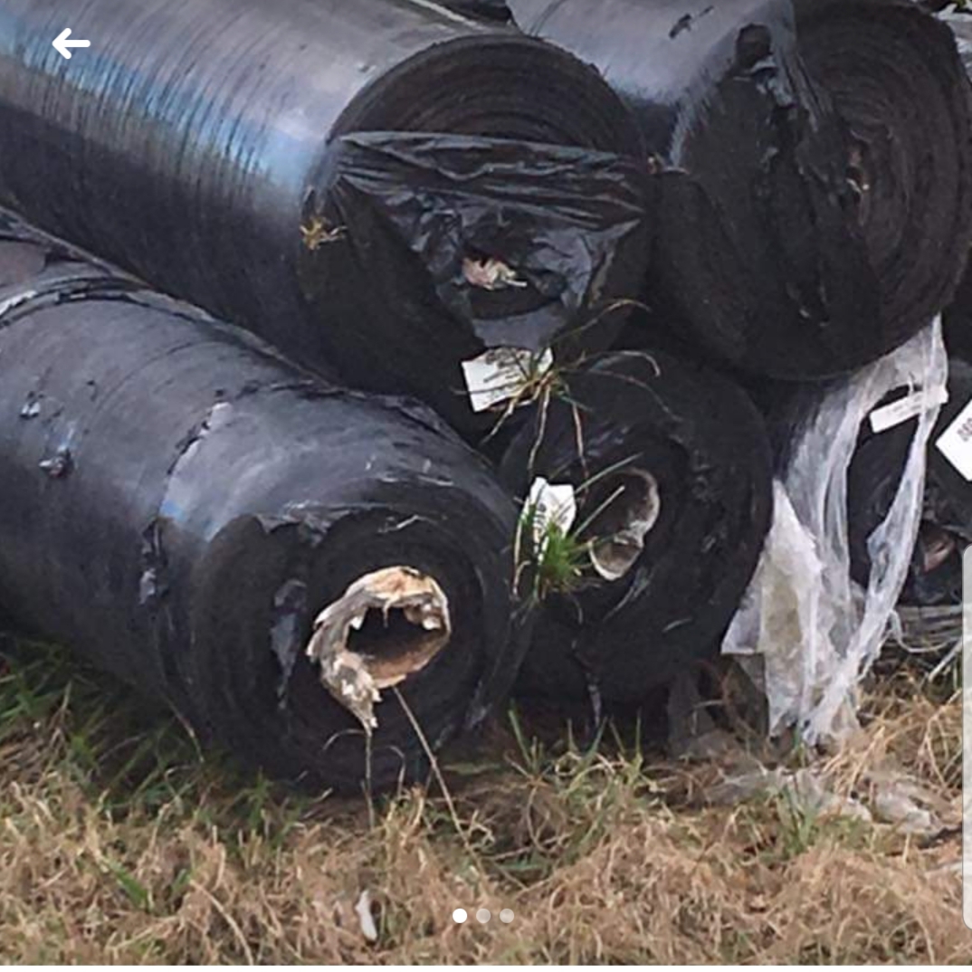

I got (what I think is) a good deal on 2 huge rolls of road fabric today. The seller was a corrugated pipe sales place that I guess started trying to offer the fabric a while back and had trouble selling it. The date code on it is 2017 and it's probably been sitting outdoors since then, but seems in good shape and even if it's degraded, probably only only the first few wraps are affected. They had long rolls of thin stuff and shorter rolls of thick/heavy stuff. I got 2 rolls of the thick/heavy stuff. According to the label they're just over 200lbs, but being saturated with rain I estimate about 400lbs each
The geotextile fabric I used is a heavy mesh and had an oily smell. Some of it has been exposed around tree roots for over 15 years and I don't see any difference in the stuff.
That will work. Did he sell you pins also?
Nope. No pins. I guess I need to get some. What size would you recommend? I'm looking at some on Amazon right now and it seems the most common size is 6" but I don't know if that's going to be enough (I assume they need to go deep enough to hit hard[er] soil?)
