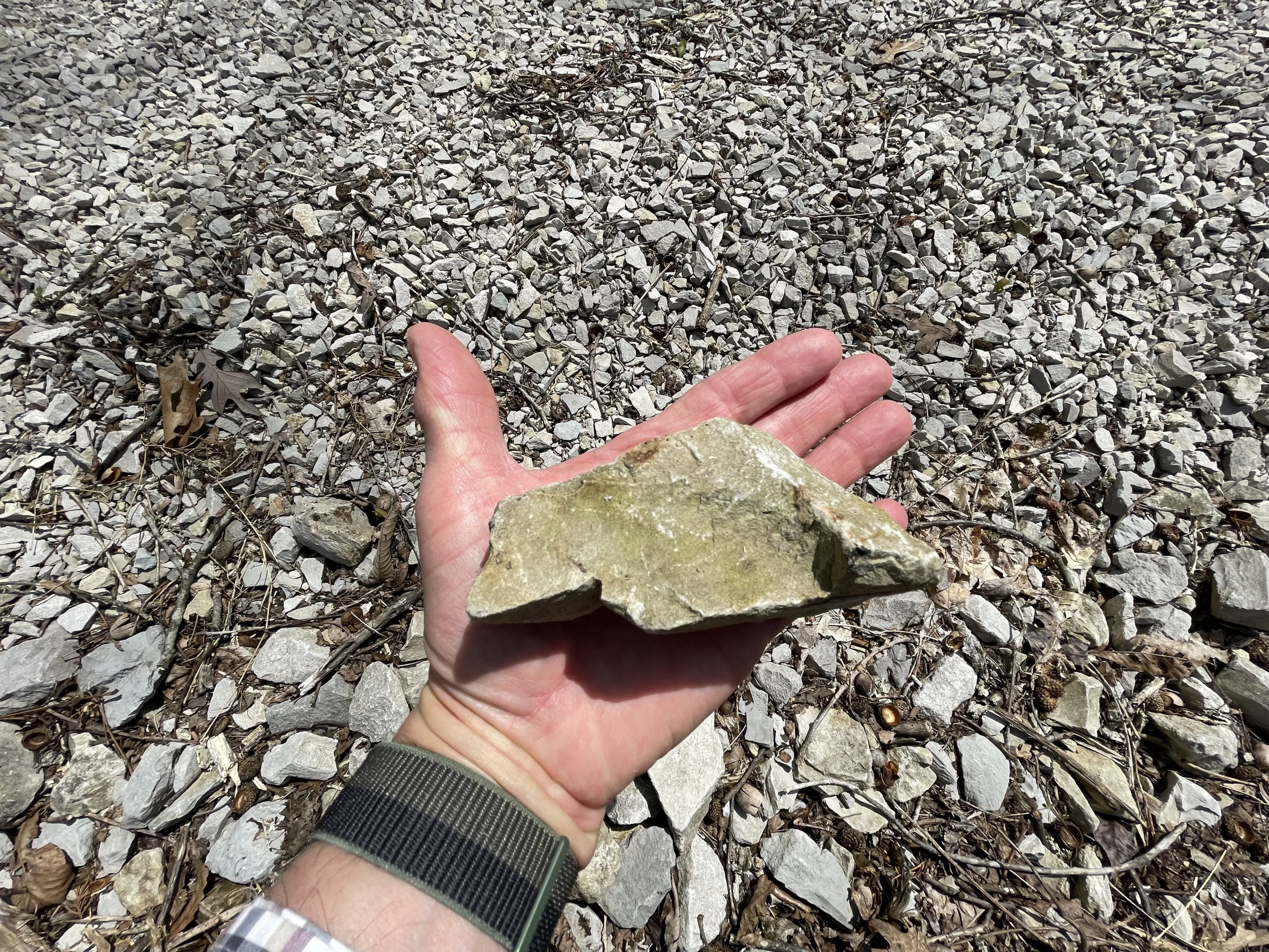

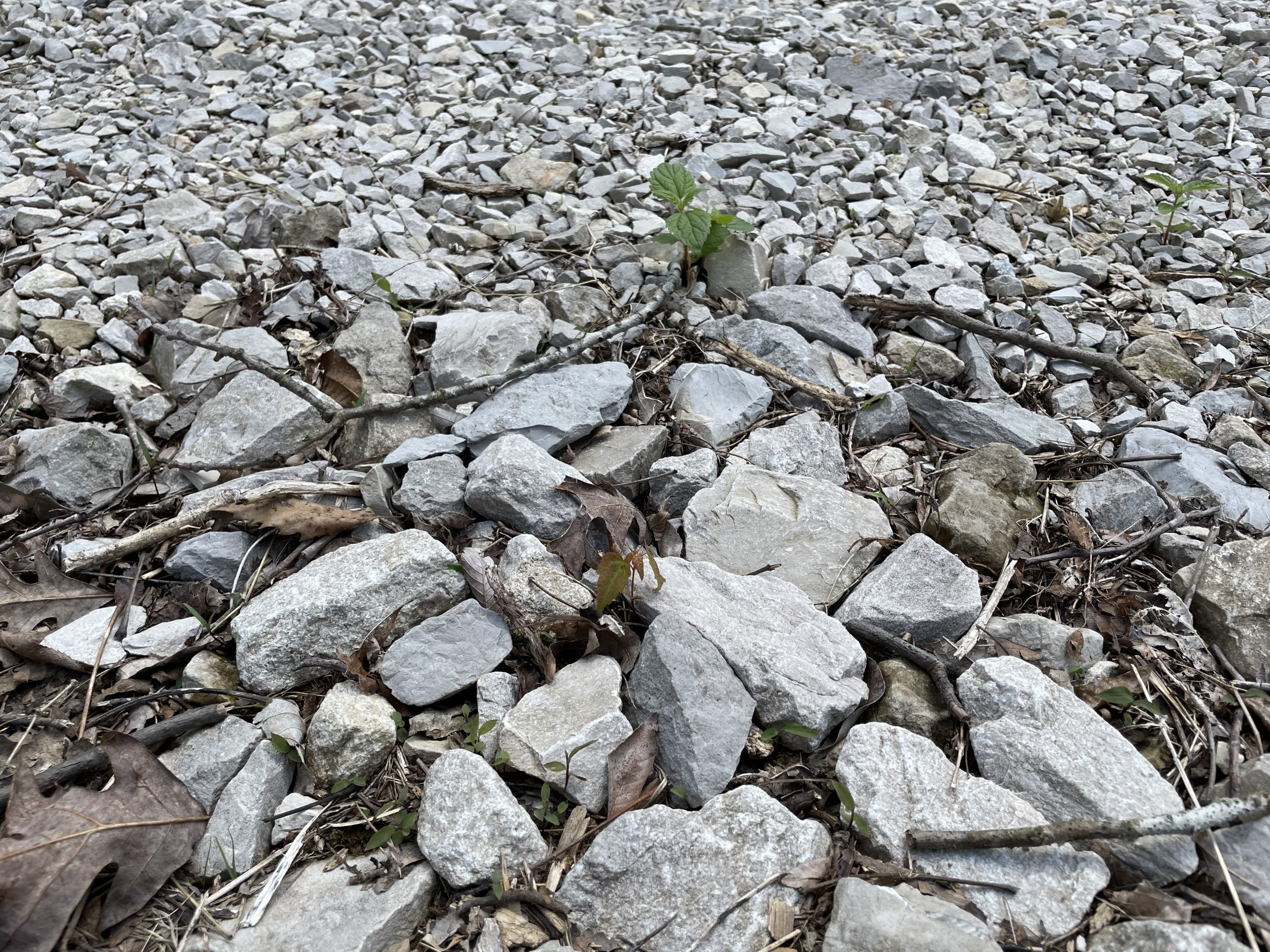

Put down as much 2 inch to 4 inch rock as it takes to cover the whole drive. Drive on it all summer. Put a good thick layer of roadpack on in late summer/early fall. When I started my driveway you could sink a pickup truck to axles in it, and I did.
   / Portland cement or other trick for turning a soup pot into a driveway? #39
Put down as much 2 inch to 4 inch rock as it takes to cover the whole drive. Drive on it all summer. Put a good thick layer of roadpack on in late summer/early fall. When I started by driveway you could sink a pickup truck to axles in it, and I did.
View attachment 742826View attachment 742828
This is the best long term solution. Firmly seat a base of large rock, then cover with road base to finish.
