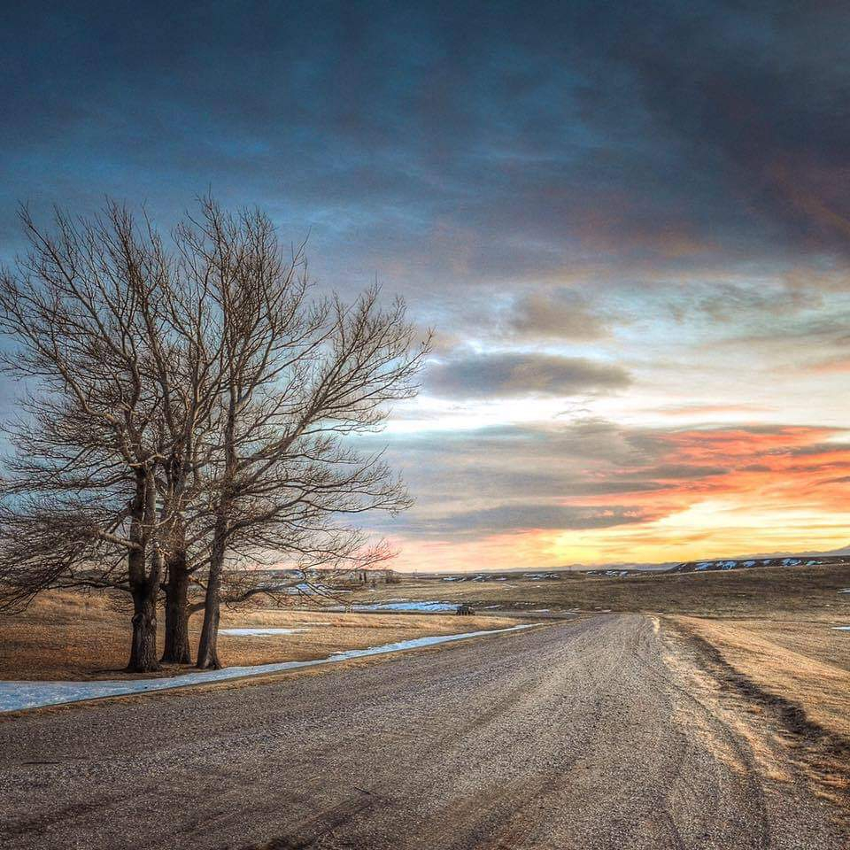

I am now good friends with every person who drives a dump truck within 50 miles of me. ;)
