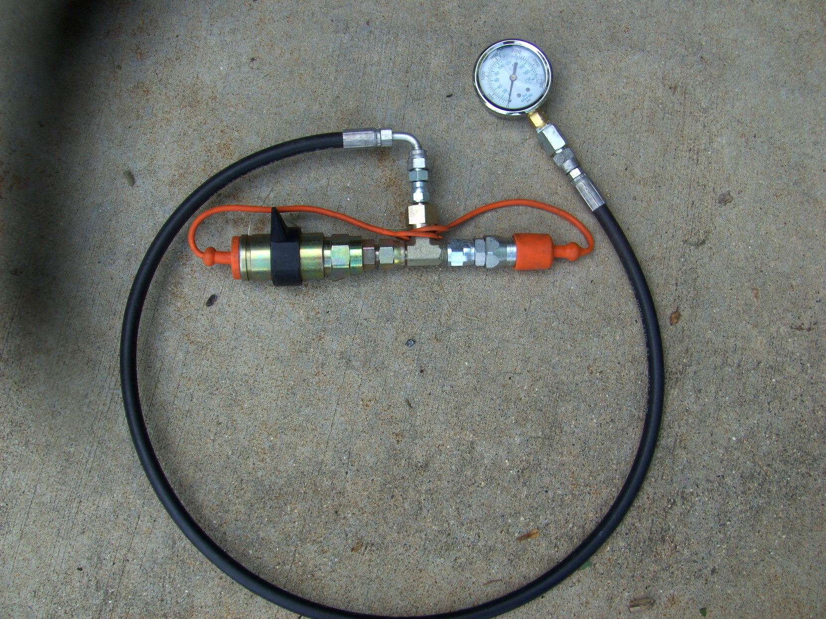

3000 PSI 2.5" LF LM GAUGE
As I said before, the 3pt will affect the loader valve.
There is no reason I can think of to use both valves at the same time .
If you use full lever on the loader, you will not have any 3pt operation.
I believe your hyd pump has two sections on it, one for steering and one for attachments.

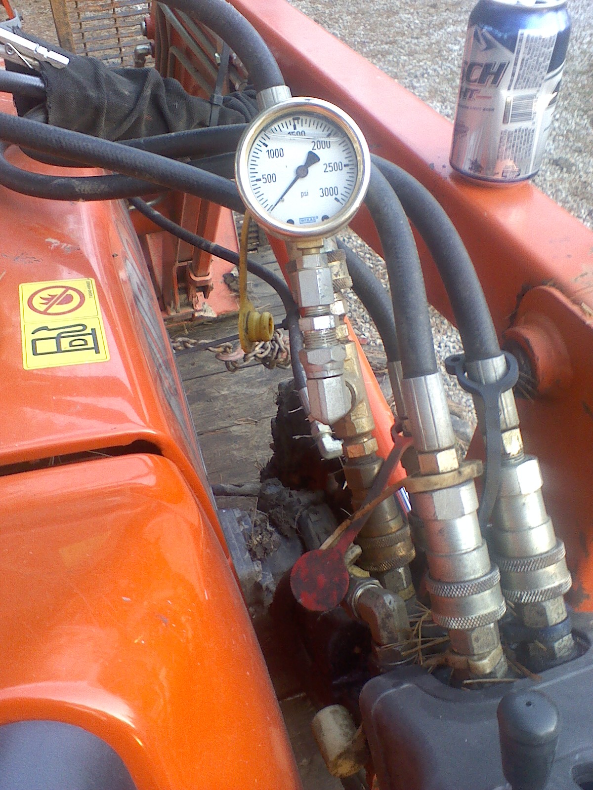

Ok. I got a guage on it. It ain't pretty, but it gave me some readings. Guage is a 5000 psi and there was a small drip leak in one of the fittings to the guage. Here are the readings.
AT 800 RPM (Idle)
Neutral 0
lift boom 700
down boom 0
curl bucket 750 "clunk"
Dump bucket 100 then quickly to 0 "clunk"
Regen dump 2200
full relief 2300
3ph up 650
3ph down 0
AT 2200 RPM
neutral 200
lift boom 1000
down boom 200
curl bucket 1500 "clunk"
Dump bucket 200 "clunk"
Regen dump 2300
full relief 2300
3ph up 1000
3ph down 200
The pto and power steering have no effect on guage, even if power steering in in relief.
The rear remotes have nothing hooked in them, but when lever was moved either direction, guage went to 2300.
Power steering lines still pulsed, but made no sound yet, my tape job must be muffling that static noise. Still have to work tractor to full temp and see. Is it normal for power steering lines to pulse inside when steering wheel is in neutral? And why does the clunk noise disappear when pb and tanks lines were switched and disappears when loader and 3pt are worked at same time?
